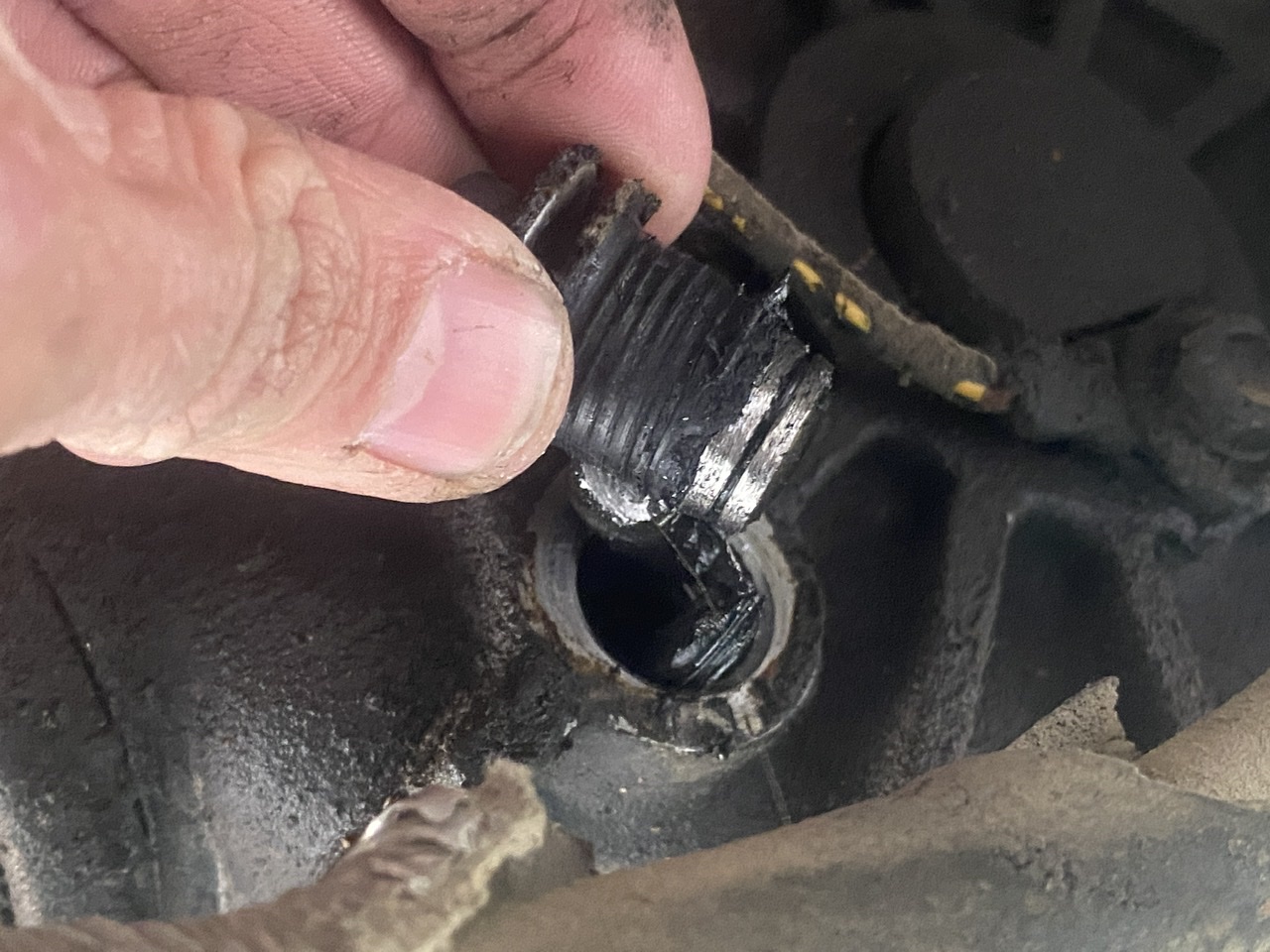

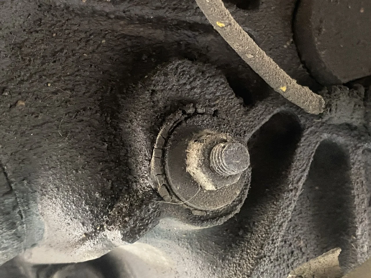

For the Axle, considering my old man(he’s been working on cruiser since I was born in 99) and I just rebuilt the entire front end, including a new set of gears from cruise outfitters, arb locker, knuckle rebuild, and rotors. I want to say that it is very very unlikely to be anything inside the axle. That leaves me with the drive shaft and T case. Today I took a look at the drive shaft and there was basically no play at either of the U Joints so I then took the drive shaft out and drove the 62 around hitting 25-30mph with H4WD engaged and the noise has disappeared. But I’m not sure this really eliminates the t case as the source as there is no weight being put on it with the drive shaft out, so sure the flange is still spinning but not sure it means much. When I was under there I also spun around the T Case Flange on the front and it was making a bit of a grinding noise, seen here. Does this sound like a bad output bearing? Mind you the T case shifter was in neutral when I was spinning it in the video.
Also it should be noted that I drained the T Case oil trying to diagnose this issue and I didn’t find/feel any metal shavings in it at all. Buuuuut only about a cup of oil came out of the thing and it was very brown. (Forgive me for not baselining this Cruiser properly when buying it, it’s my first Cruiser/old vehicle.) I filled it back up to the fill plug with 80-90 and it still made the grinding noise.
