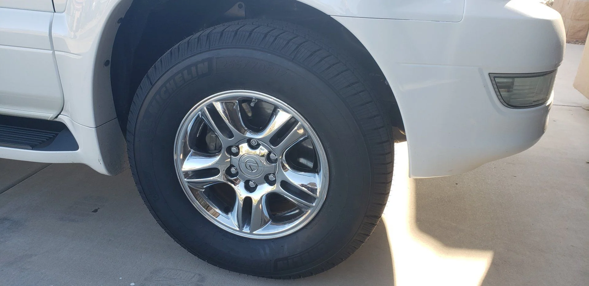

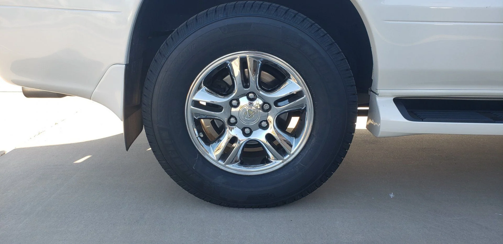

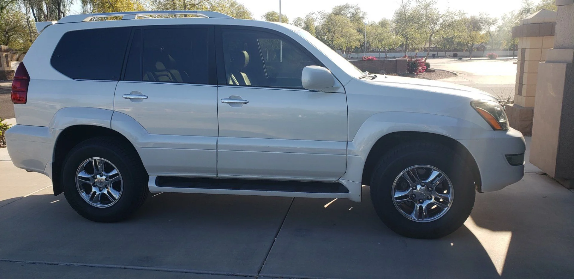

Tires are on and there is no rubbing. 2008 GX470 | Arizona No Rust Rig | 120K | Stock Suspension | Michelin Defender LTX tires 265/70r17 | Beamtech LED Lows & Highs | LED interior/exterior lighting replacement kit.. Next up is a call to United Radio to deal with my failing Mark Levinson amp

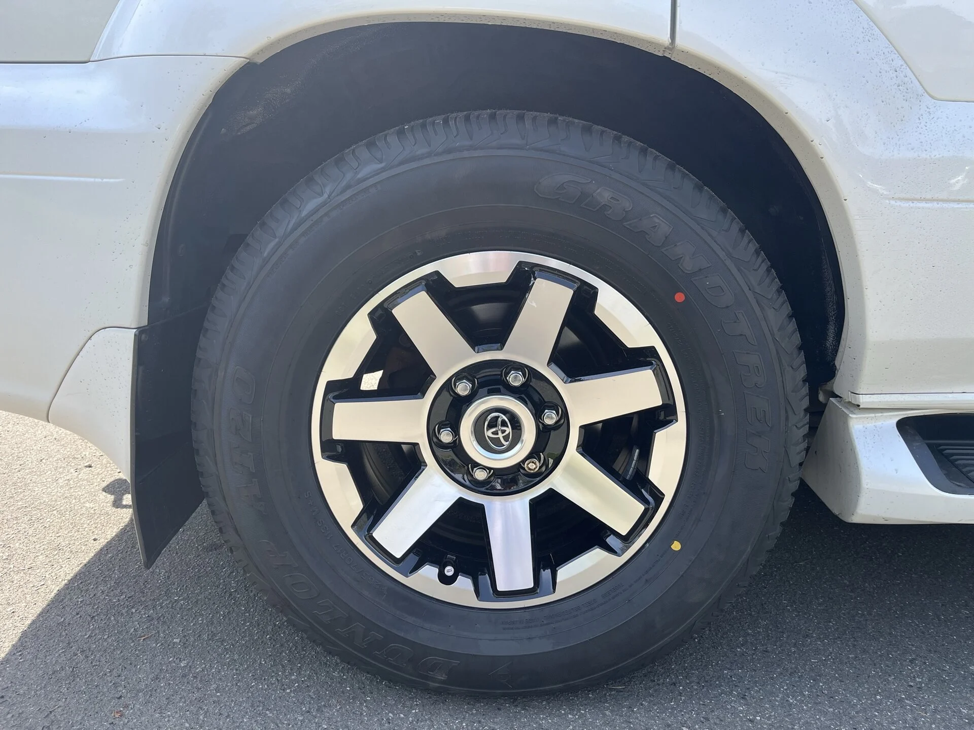

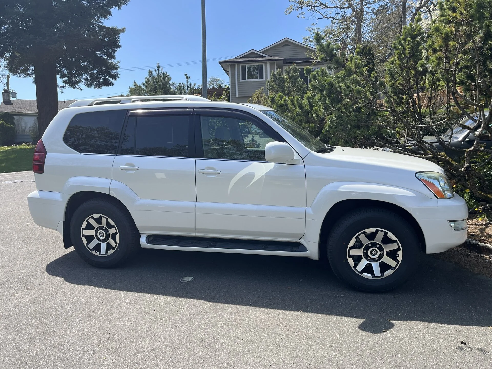

2023 Toyota rims with 265/70R17 on my just purchased stock 2005 GX470. No rubbing and no trimming. No rubbing when braking straight or while in a turn. No rubbing when driving 20 mph over big speed bumps.
