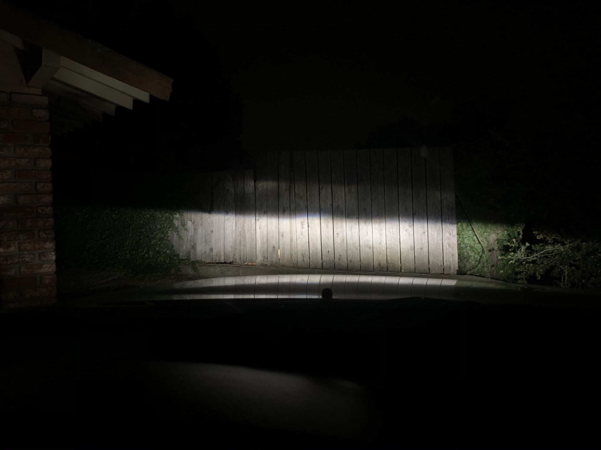

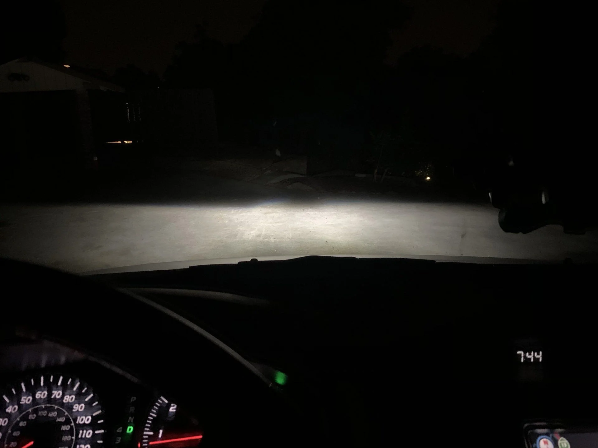

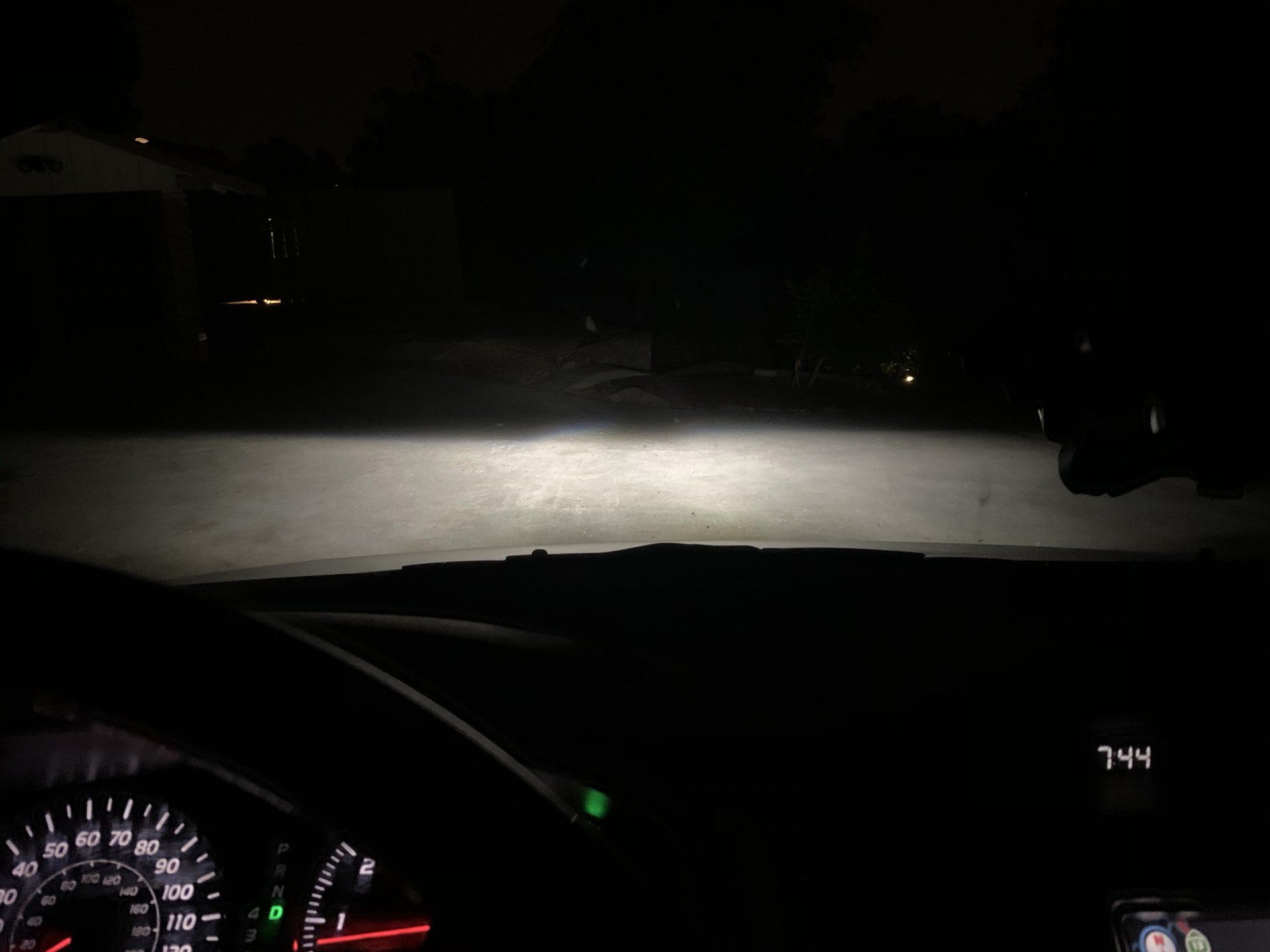

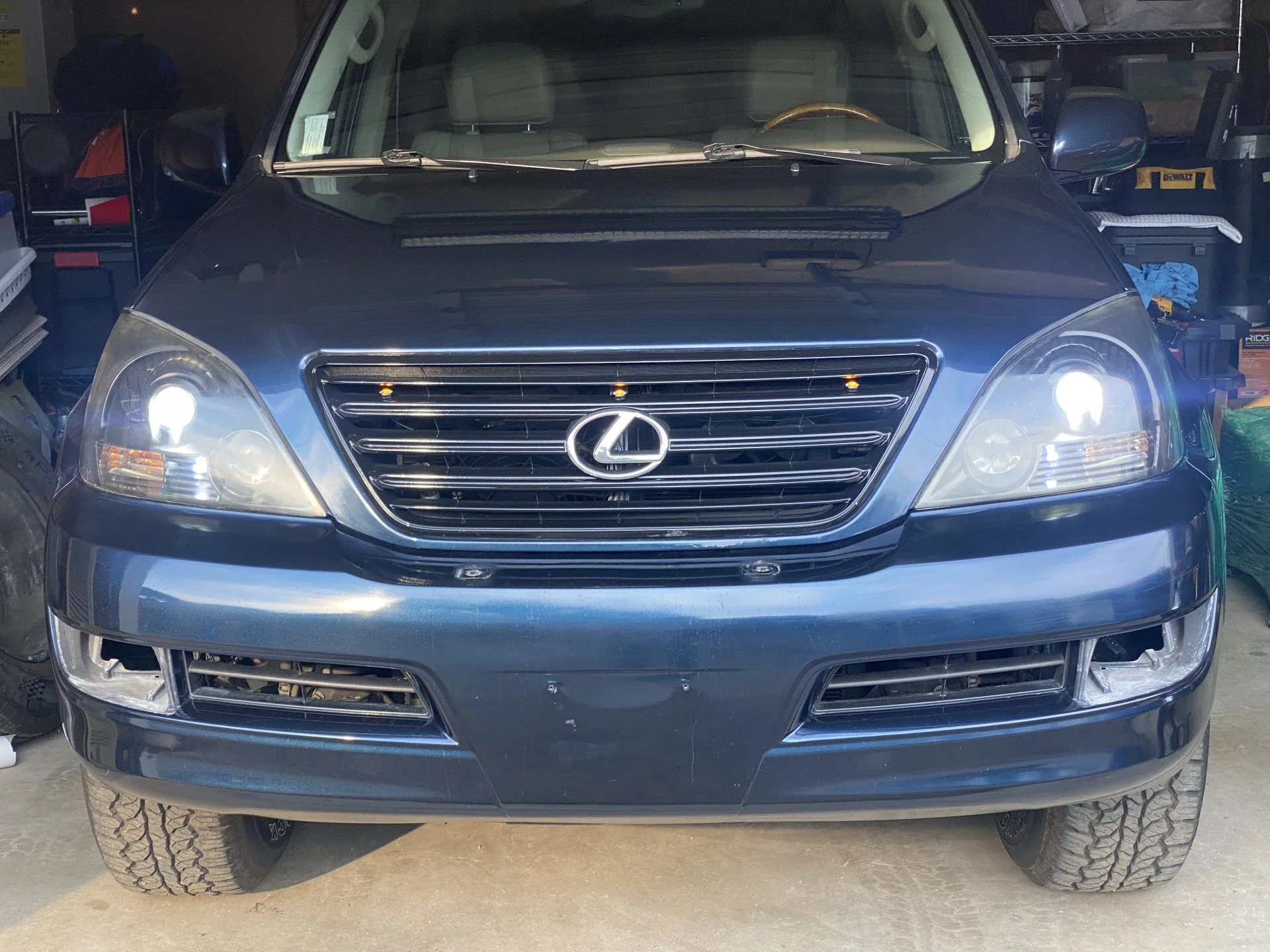

I installed these today and they are a huge difference over the bulbs I had (2009 oem).
Amazon product ASIN B07TH8F1TP
The first two pics are side by side comparisons:
Then at night, this is both LEDs

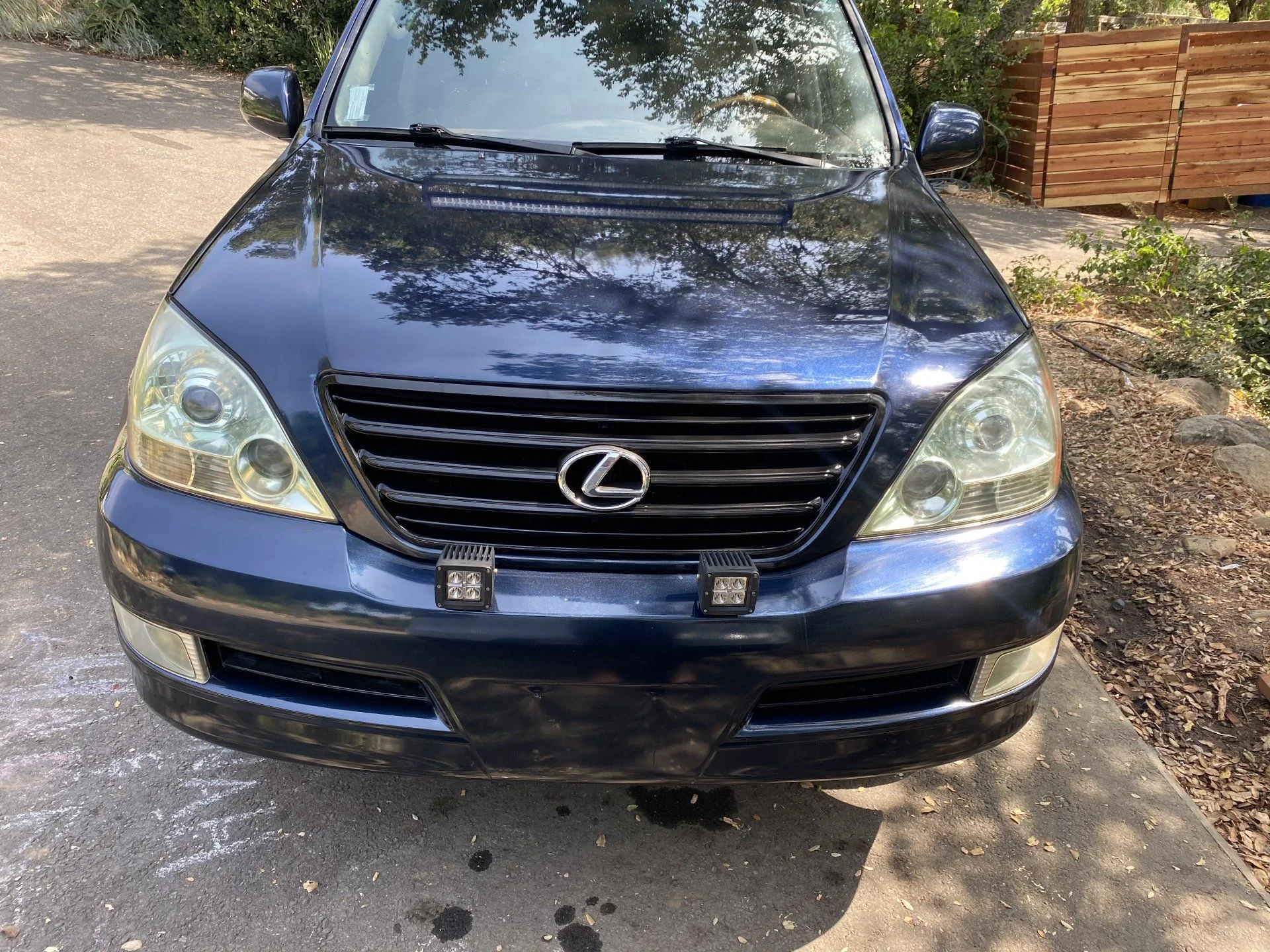

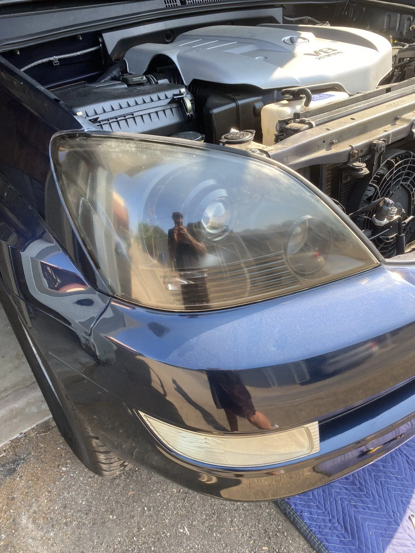

I heard the depo headlights last about a year or so before cracking so I held off, restored mine with cerakote ceramics and then I retrofitted with LED lamps and painted the housings. Here’s a little before and after.
I am at two years and about 20,000 miles (including two salty and gritty Utah winters) with depo’s and they look like new. They were worth it just to get a away from the green/yellow haze with oem, non-sport headlights. Like you, I’m running LEDs. I don’t know if the minimal heat from LEDs helps the plastic last longer or not. It sure doesn’t help stop them from icing over.
