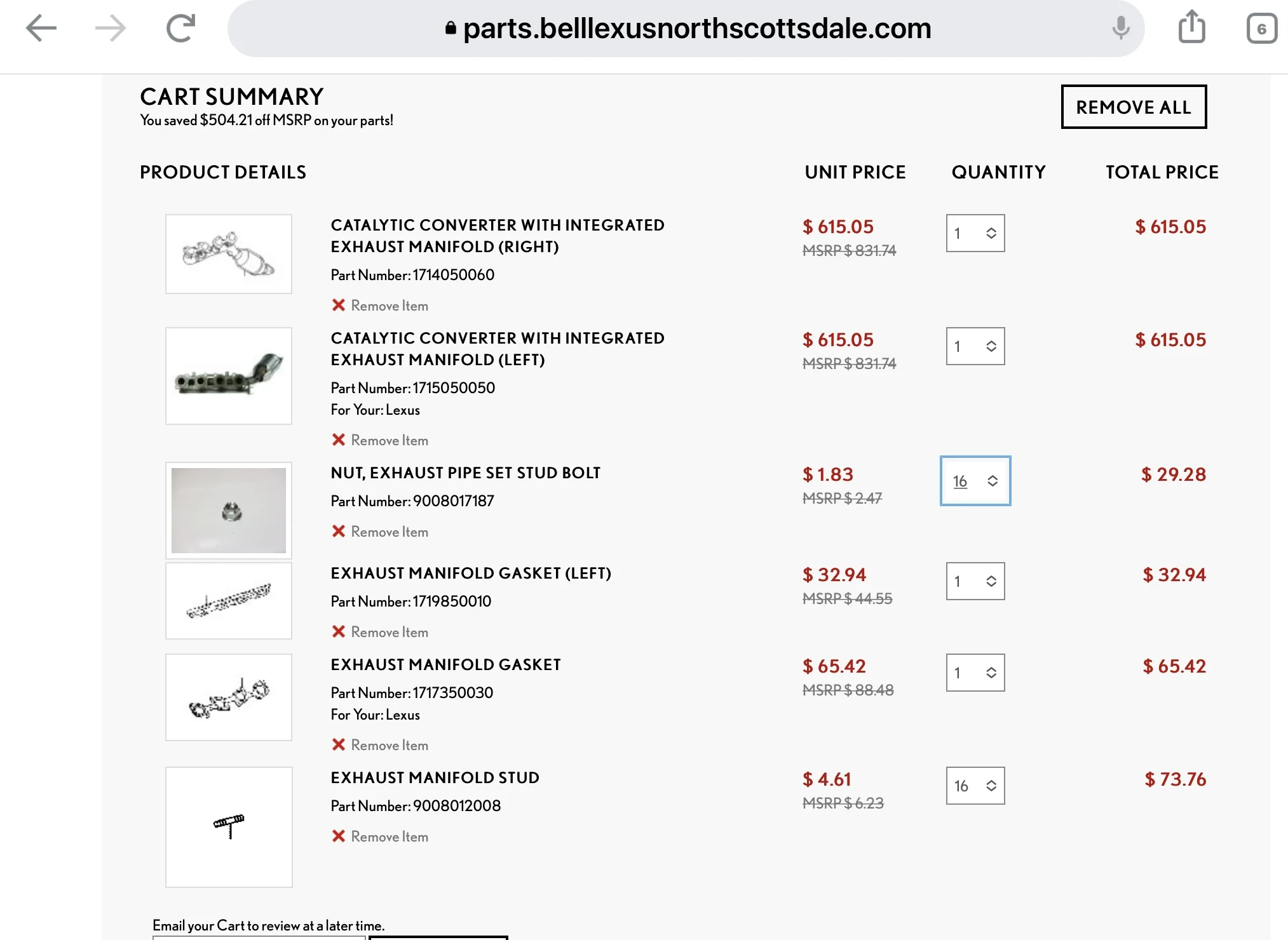

I have never done exhaust manifold job, the o2 spacers have saved me so far. Here is a list with part numbers that I compiled a few years ago when I thought I had to do this. Hope it helps.
Usually lexus and/or toyota will do 20% off parts around the holidays. good way to save some cash on $1200 exhaust manifolds
