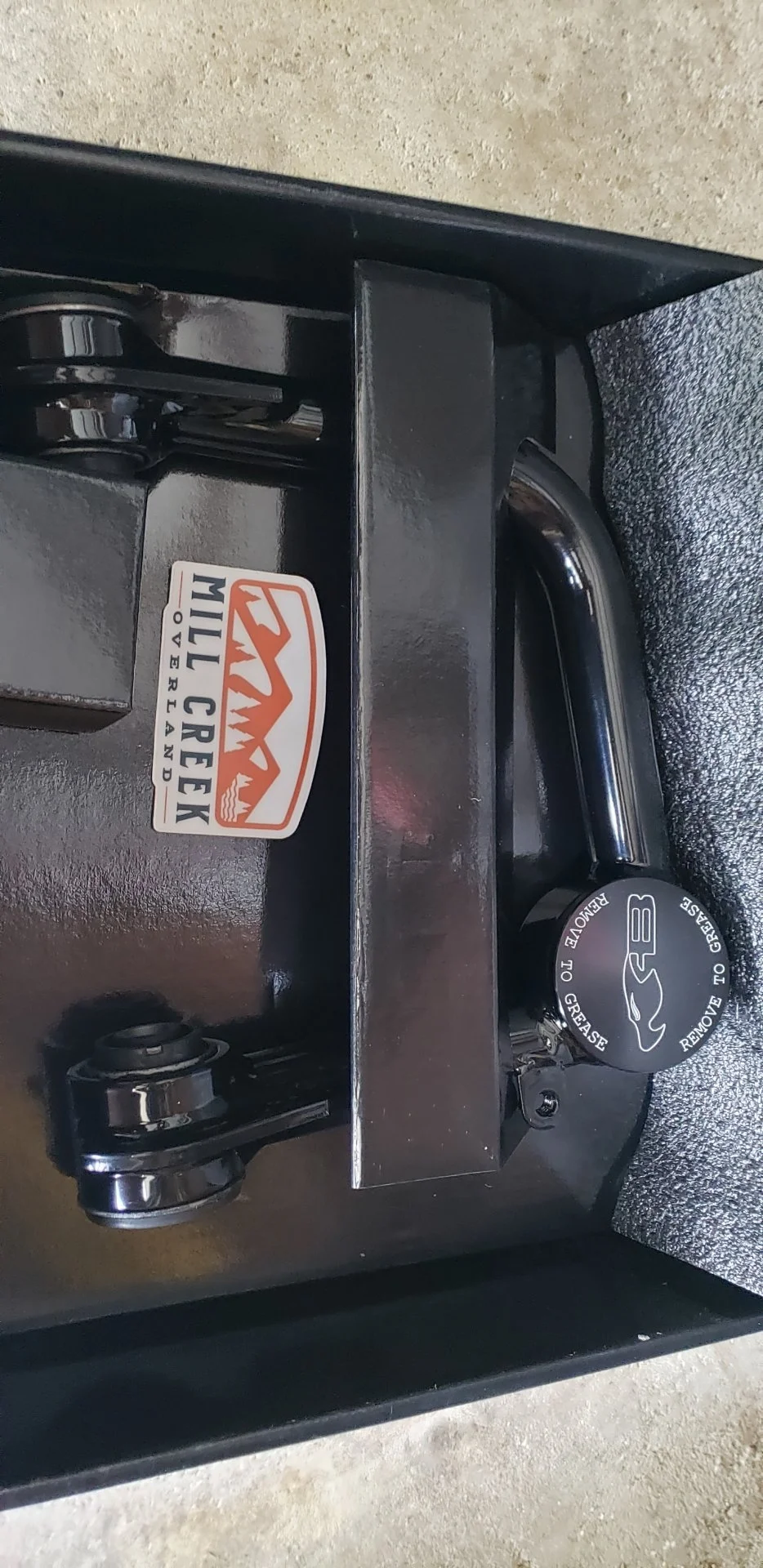

Are these the same? I won a set of blackhawk UCA at GSMTR last year and was wondering if they are one in the same? Box shows they are for a Prado 120 but I also know they don't sell the GX470 in Australia. Says they will accommodate up to 3" of lift.

A Prado 120 is a GX470.

Confirming that if those are the UCA3481P Prado 120 arms, they'll fit a GX470. I find it a bit interesting that they call out a different part number for FJ Cruiser and GX460/Prado 150 arms, as those use the exact same UCA as a GX470/Prado 120. Same OEM part number.
But these are nice looking arms for someone who wants to stick with OEM ball joint and bushing compatibility (lifted but stock travel). They should work well and ride nicely for a lifted rig that sees mostly street use.
