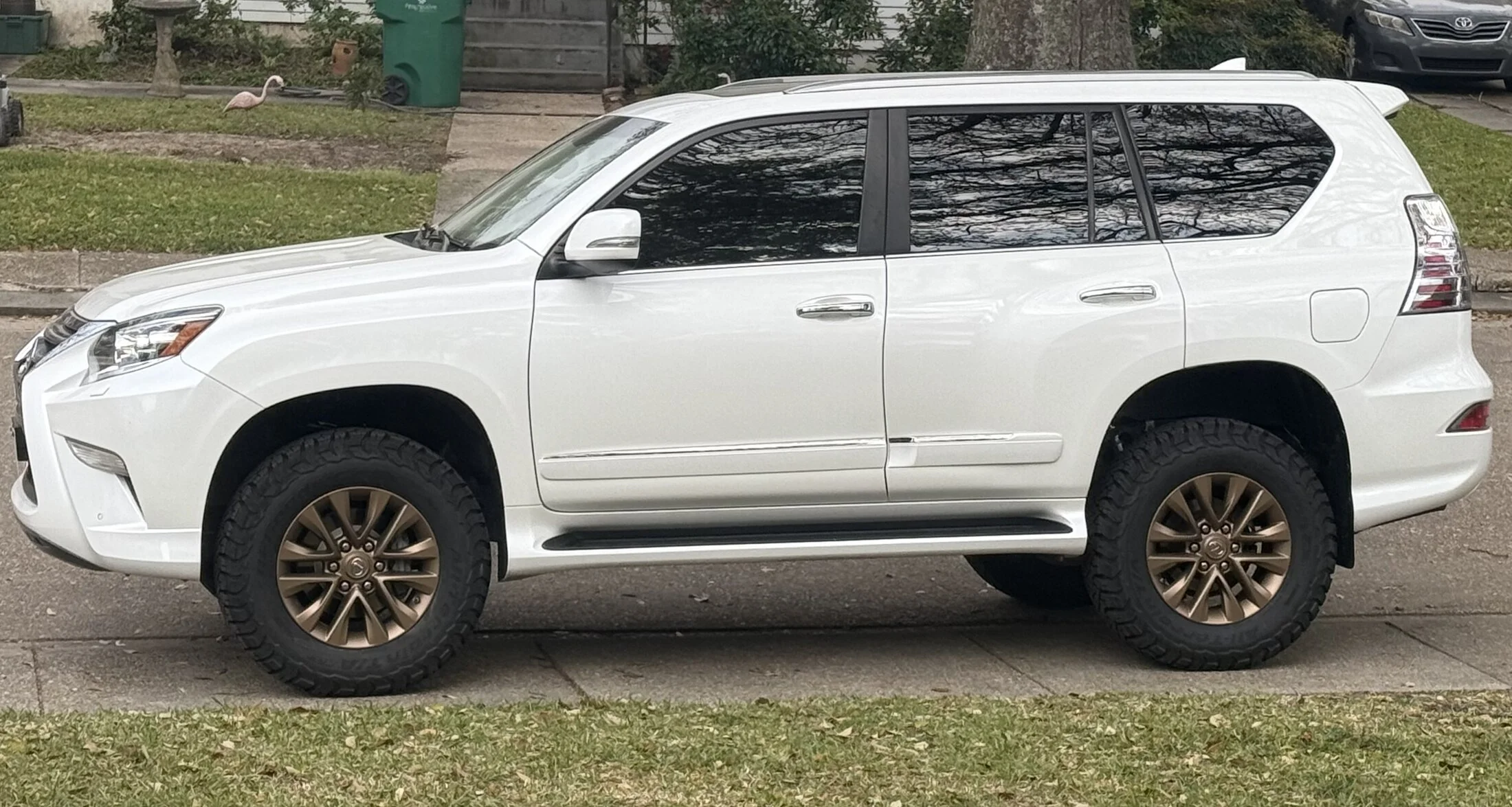

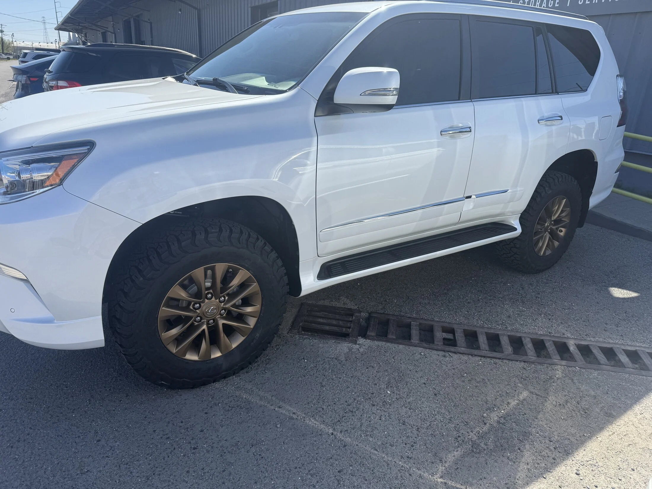

I’m having some issues with rub - sounds like scratching or scraping, but pretty sure it’s rub…
2019 GX460 Luxury
-Bilstein 5100s
-Dobinson springs
-Freedom front control arms
-265/70R18s BFG KO3s
If I’m coming in a little too hot on a curb, I’m getting a rub - but it actually sounds more like a grinding sound. Also the rake is a bit out of wack… Maybe I could do a spacer to level the front a bit?
I have two 2019s with the same set up, the other is a base - zero rub.
Any suggestions?
I don’t see any rubber on the running boards, which are coming off soon… So I’m just trying to figure out the best solution.
PS:
Don’t beat me up on the “bronze” - I know it’s a bit too gold. I’m going to re-shoot the wheels to tone them down… Mind you, it’s pulled up on a curb in two of the pics.

Thanks, I found the perfect color Toyota bronze color code with eggshell clear - which I shot on my silver one… I went a little lighter on this one, so slightly more gold than I wanted. I was trying to match the LC200 heritage bbs bronze. I usually go with black wheels, but I wanted to try to play off the pearl. Who knows, it may grow on me after chrome delete and victory blitz front bumper is installed. Wish I could find a legit source for a gloss black webbed grille.
So the problem is (well what I’m hearing) it happens when I’m cutting into a parking lot, or a gas station, etc - just for instance. Also when I’m backing out of a parking spot, reversing into the street over a curb… So basically anytime I’m flexing, and it doesn’t happen when I’m creeping.
I do wish the rake was a bit less severe in the front. I’d prefer not to do a chop. What about swapping out any of my front end components for something that will lift the front up a bit more? Have yet to take measurements.
I just hope it’s nothing to do with my suspension setup, and it is tire rub. It is slightly concerning though… comes with the territory.
