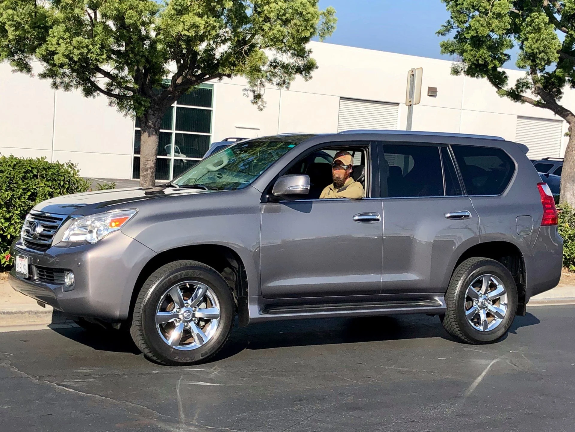

Just purchased the 2011 pictured here. Base with Convenience Package, all maintenance done at Lexus dealer, very clean: $21K. Thank you for all the information on here, it was invaluable in knowing what I wanted and what to look for.

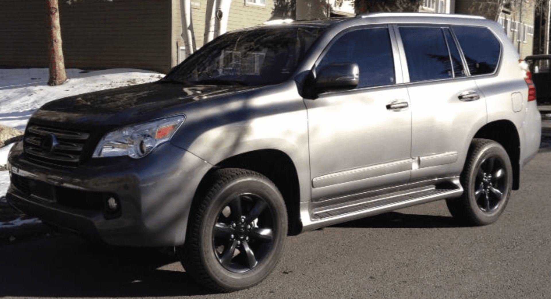

(2) Two reasons - First, the chrome wheel looks out of place to me on that vehicle. I've attached an image below of the same wheel (on the same color GX as mine) that has been painted. Still not loving it. Secondly, I have yet to weigh the wheel and I was unable to find a number online other than Amazon with a shipping weight of 42lbs which can't be right. That said, if each wheel is 32 lbs and I can replace it with a 22lbs FN wheel, I can either save 40lbs of rotational mass, or I can offset the added weight of the taller tires I plan to run. Either case bringing benefits in fuel consumption and/or driving performance. If I find my current wheels are not that much heavier than the replacements I'm considering, I will certainly give Plastidip more thought.

I get you don’t like the look, however the intention of saving weight on rotational mass makes sense on paper. But these are not race cars and at 6000lbs loaded while bashing through the rocks with 12-14 PSI do you really want light weight wheels? Also these wheels should be just under 30lbs not 42lb which should be shipping weight and wheel boxes are heavy. Personally I would not change wheels unless uograding to a set of forged wheel from a reputable brand which means $2k minimum, everything else is a downgrade. Do you think small after market shops really has the resource to engineer, build and QA a product to the same level as a multibillion dollar auto maker known for reliability and quality?
Another solution is get wheels from different model of GX, 4Runner wheels should work also. Toyota 5.5x6 pattern wheels should work as the back spacing should be the same. 80 wheels are strong but different back spacing and tundra and 200 wheels have different bolt pattern.
Btw easy way to find wheel weight is to weight the combo and tire weights are easily found with google and tirerack.
Unless you have any serious problems with either King or Radflow, having them both as close as they are within your proximity (as for myself) would trump going with any other manufactures.
