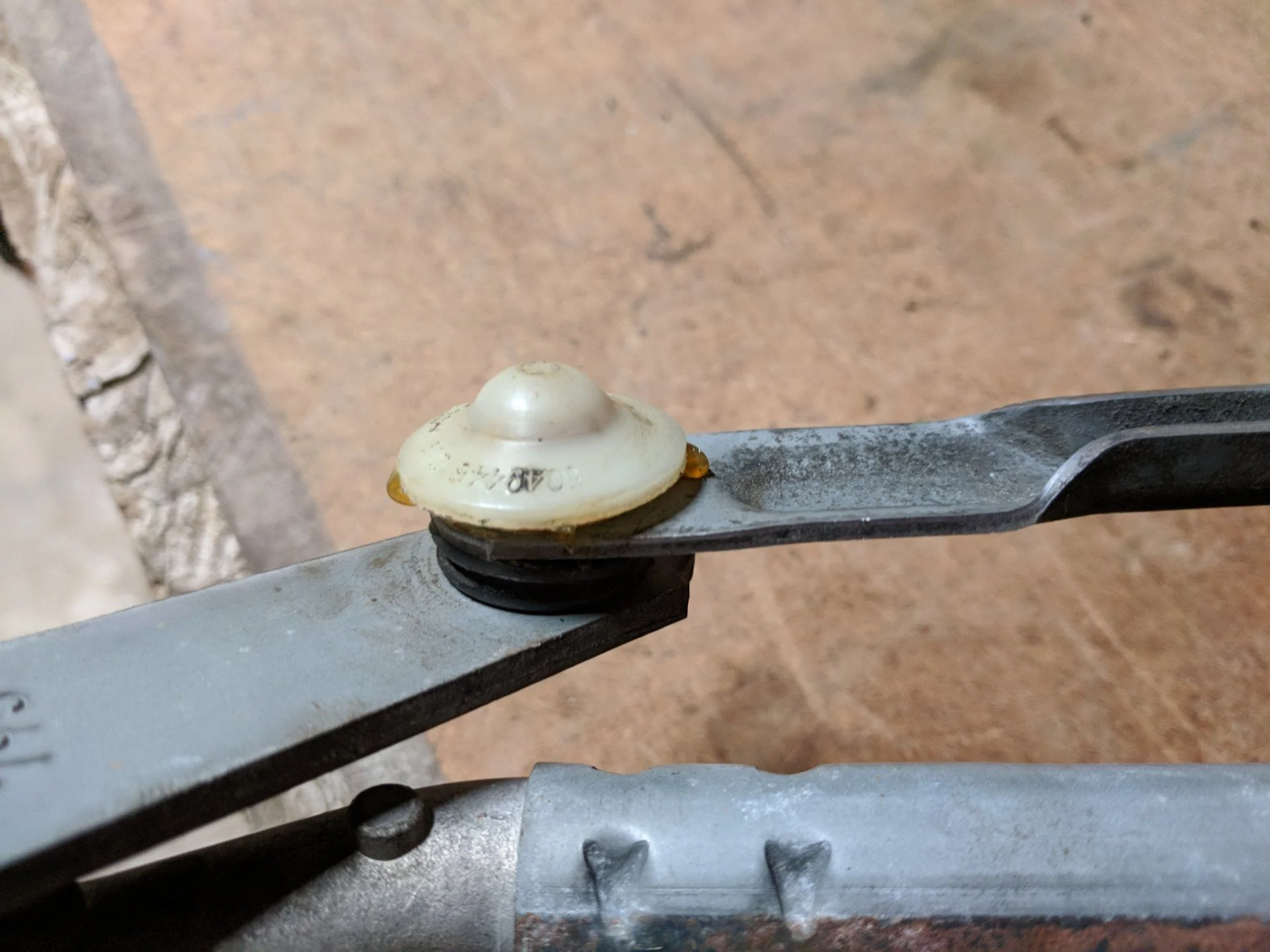

Modify the bushing.
Pictured is the unmodified bushing. You need to trim off the bottom (open side) of the bushing just below the raised ring that intersects the slots.
