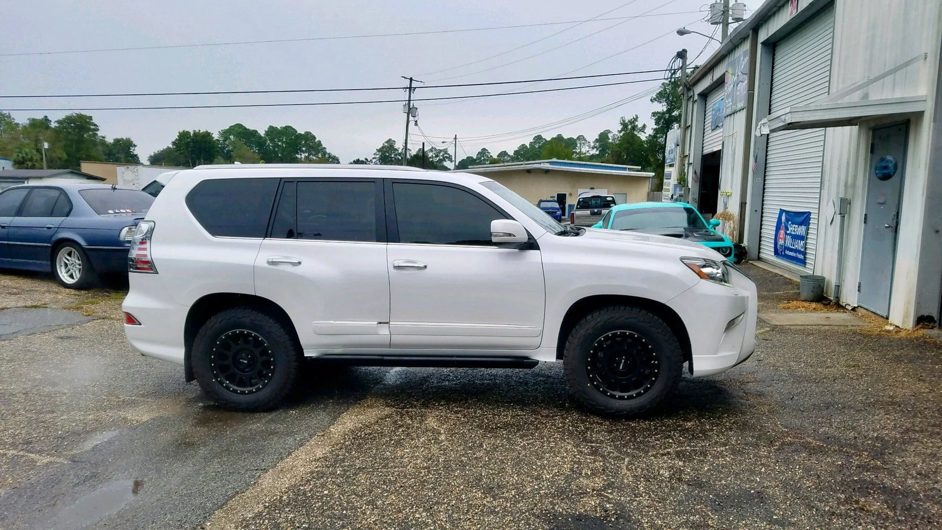

I have a 2013 GX with the Premium package. Although I did not do the suspension myself, it was done by YotaMasters, they never mentioned any issues with the rear AHS suspension or anything else suspension wise.
Just go for the Premium if your looking at 2013's and older, or the Luxury edition for anything younger. You'll love it!
