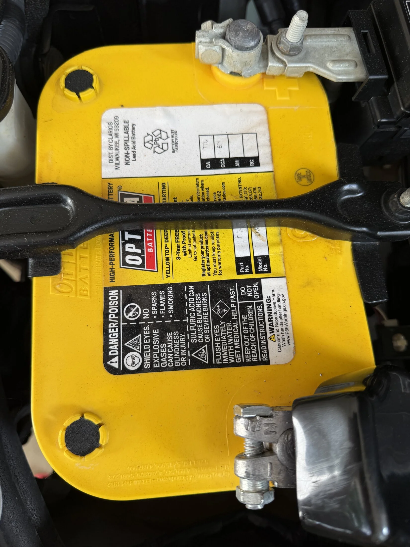

I’m replacing my alternator and doing the big 3 wire upgrade (as well as the alternator wire). Current battery (pictured) is 4+ years old, so I’m going to replace it as well.
Should I stay with the group 27 or upgrade to 31? At first I was thinking I’d do the Slee tray & terminals upgrade to the 31 battery, but now I’m thinking a 27 agm battery might make the most sense for me. I can get the odyssey agm 27f for $375 - it’s got 850 cca with 182 minutes of reserved capacity, compared to the interstate 31-mhd which has 950 and 195, respectively. Ive got the GM voltage boost regulator installed.
I’m in the south so it’s hot - 850 CCAs is probably more than enough right? Trying to understand the benefits of the size 31 upgrade as best as possible before I spend money for reasons unclear.
Thanks!
