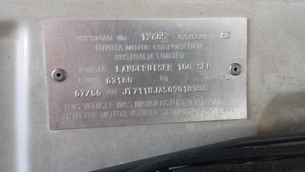

Yes, most people understand GVWR as what the manufacturer (Toyota in this case) has declared as maximum operating weight of this particular unmodified vehicle. To comply federal law, you should not exceed the weight on that data plate/placard.
There is what's called "intermediate or 2nd stage or Final manufacturer" and they take a vehicle, engineer, modify it and slap on a new data plate that has their revised GVWR/GVM.
The plate looks like (in Australia):
All "WA SUSPENSIONS PTY LTD" did was change the suspension and the new GVWR/GVM becomes 3300kg. There is a demand for this in Australia and that is why many companies offer it. I bet you if our State Highway Patrols required weigh-ins for light trucks/SUV's, there would be big business for it in the US too.

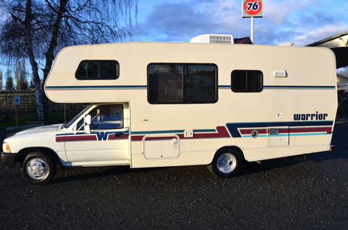

But there are many 2nd stage manufacturers in the US, most notably with RV's and commercial trucks, that will modify a vehicle and then issue it a new data plate with a revised GVWR. Have you ever seen a Toyota Motorhome? Yes, looks overloaded and probably is once you put 2 passengers in there.
1992 Toyota "1-ton" GVWR 5600 lbs
1992 Toyota Winnebago, outfitted with different rear axle, hopefully brakes and what not. GVWR 6000 lbs
