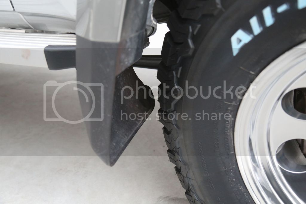

So Moto-rage finally got my GRJ76K done with a whole bunch of mods. Looking for recommendations on shock upgrades. I'm running 285/75/16s and they will rub at max lock with the stock suspension. I need a 2 inch lift to clear them. Currently considering the BP-51 by OME and Kings Remote resevoir shocks. I can get both from Australia and the price is comparable with the BP-51s being slightly more expensive.

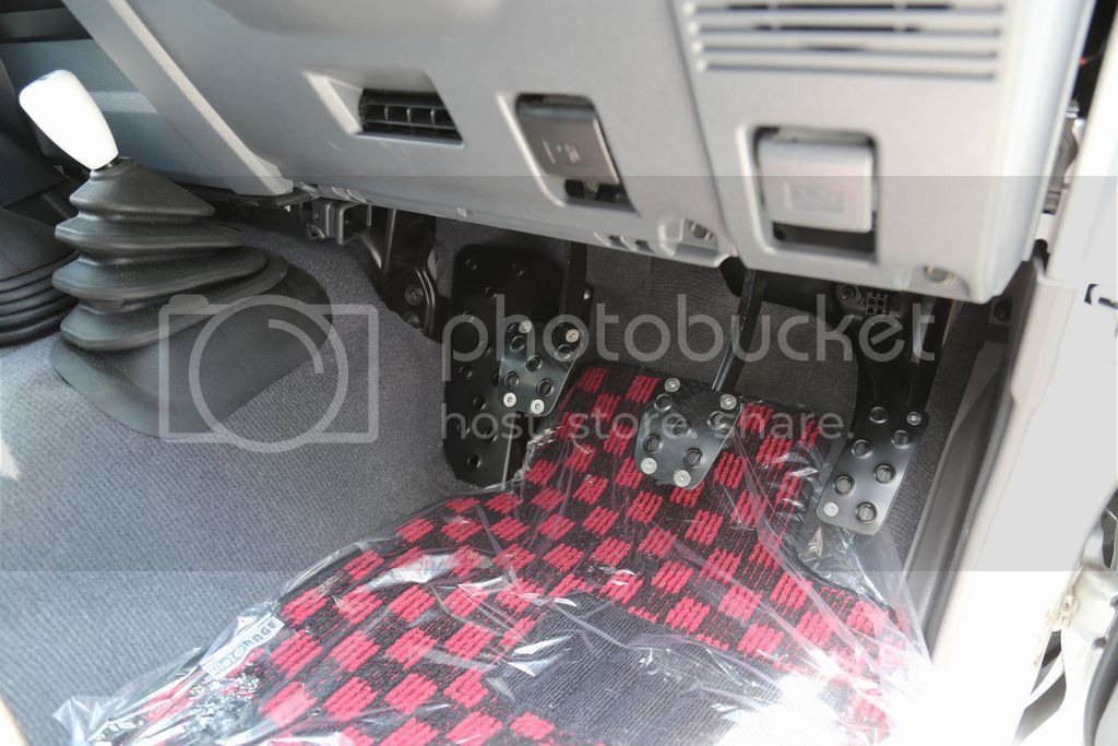

MR interior, including foot pedals, shift knobs, bride seats,
MR wheel extentions brackets
Getting bride seats with armrest now...

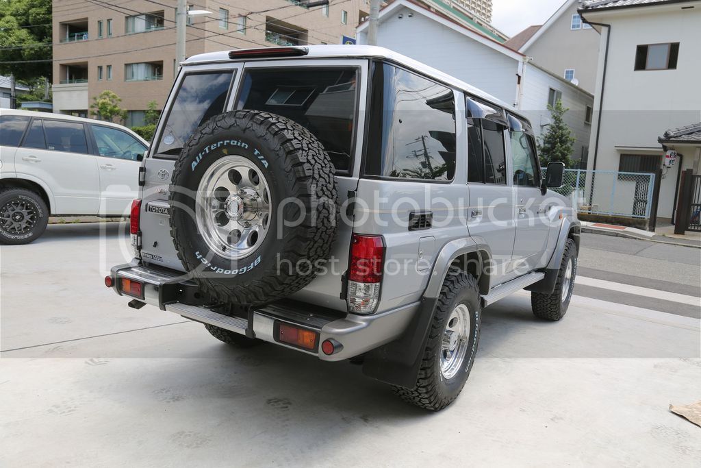

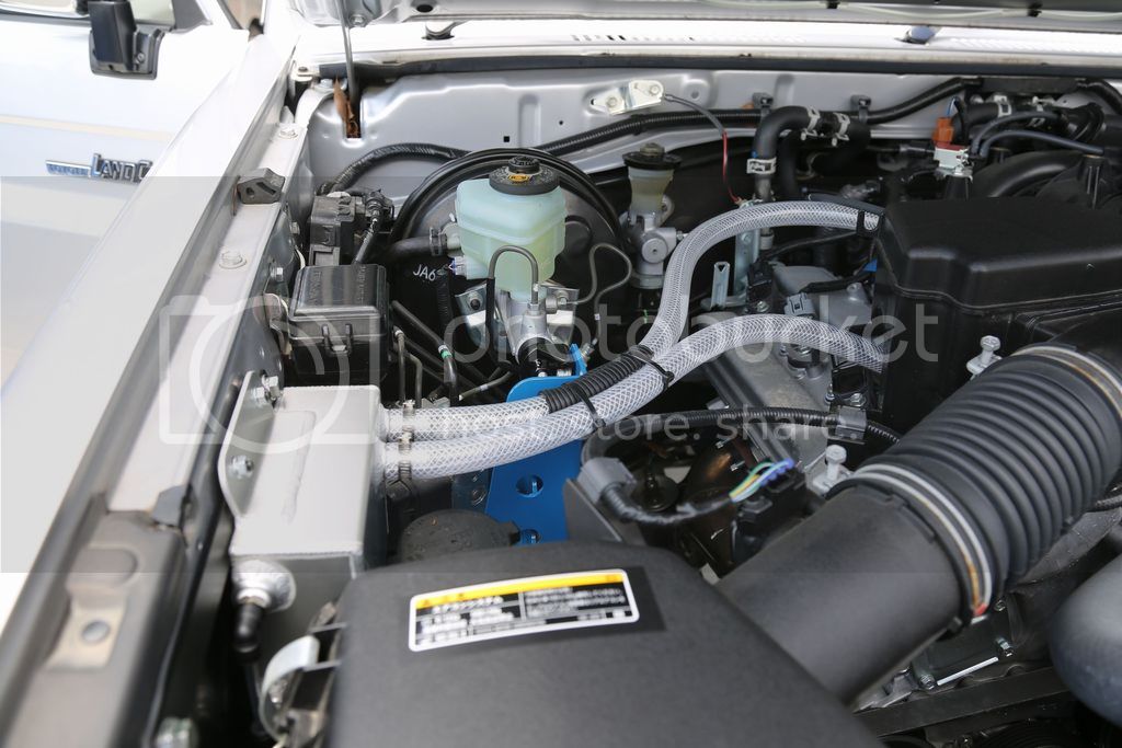

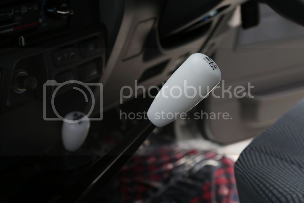

I think Motorage is the best aftermarket parts dealer right now for the GRJ70 Series in Japan. They make stuff that no one else does and their quality is excellent. I think the Australians still have an edge on some things for the 70, but Motorage is great. I have the brake booster stiffener from Motorage too but haven't installed it yet. I also have the same Motorage white shift knob and transfer case knob. Other than the lift and the tires, I've added a Pioneer Navi and rear camera which I had mounted to the top of the door, which works really well. Most rear cameras are mounted lower at the license plate, but that doesn't work on this vehicle because of the rear tire carrier.
You're going to have a great 70 when it arrives. The Bride seats are great. I sat in a set at Masterpiece (another custom 4x4 shop in Kobe): Masterpiece, Land Cruiser 70 Series, GRJ76, Kobe, Japan

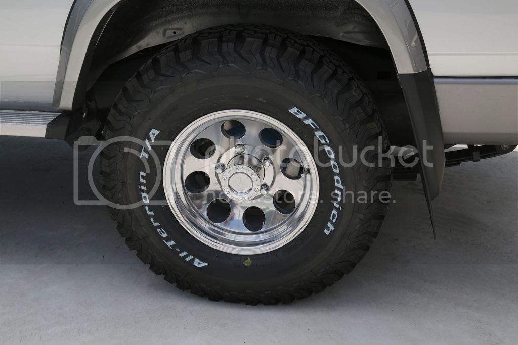

Here is the OME install on my 76:
My OME kit did not come with the BP51s but they had all of the required pieces for the proper lift, which is why I liked it. It handles better with a load (or people) than empty, imo. You can mix/match leafs, springs, shocks of course but that's costly and is probably not easy from from you are.
