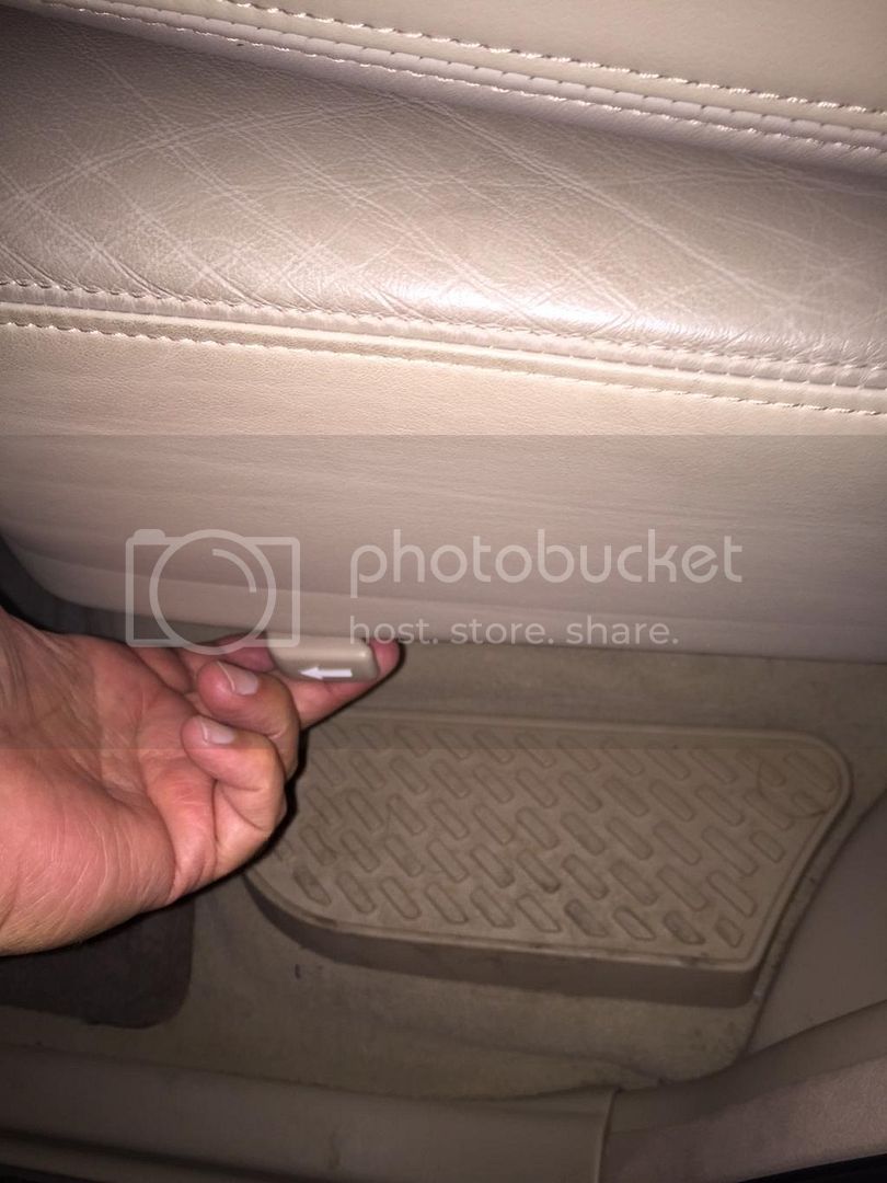

Thanks guys... The issue is that the lever on the bottom seat cushion does not release the seat forward. It seems stuck. Is there a manual way to release it?

No tricks that I'm aware of.
You are folding the seatback by pulling this lever at the outer base of the seat back:
Tumbling the base forward after sliding this lever in the middle of the outside of the seat base towards the front of the car:
Correct?
The PO probably has never taken them out I think. I'd lightly spray some WD40 or something similar on the locking mechanisms and let it soak for an hour or so with all windows open.

JLB, that's what I've tried doing but... no love :(
I get 2.5 to 3 inches of travel on the lever (on the seat base). How much are you seeing?
Are you seeing the same behavior on both sides, or only one side?
The mechanism other than the latch and the lever is covered by the trim on the bottom of the seat.
