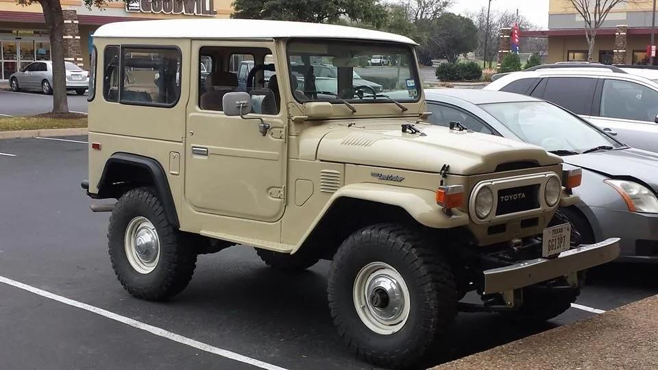

Here is my '78 FJ40. I spent this morning reinstalling the OEM fuel pump and filter. The previous owner found it easer to install a electric pump and POS filter that looked like it came off a lawn mower. The retro fit looked way to sketchy to leave it. They left the old mechanical pump installed and cut the hard line going to the carb. So I removed the old pump (no spacer), cleaned up the area and installed the new (www.sor.com) pump with a new gasket and bolts. I splicer a new 5/16" rubber hose between the carb hard line and the new mech pump. Then new hoses to the filter and finally to the hard line going back to the tank. It took only about 2 hours. It started right up and runs great. I believe it runs better that it did with the electric pump. I will get some pics of the finished product in the morning.
