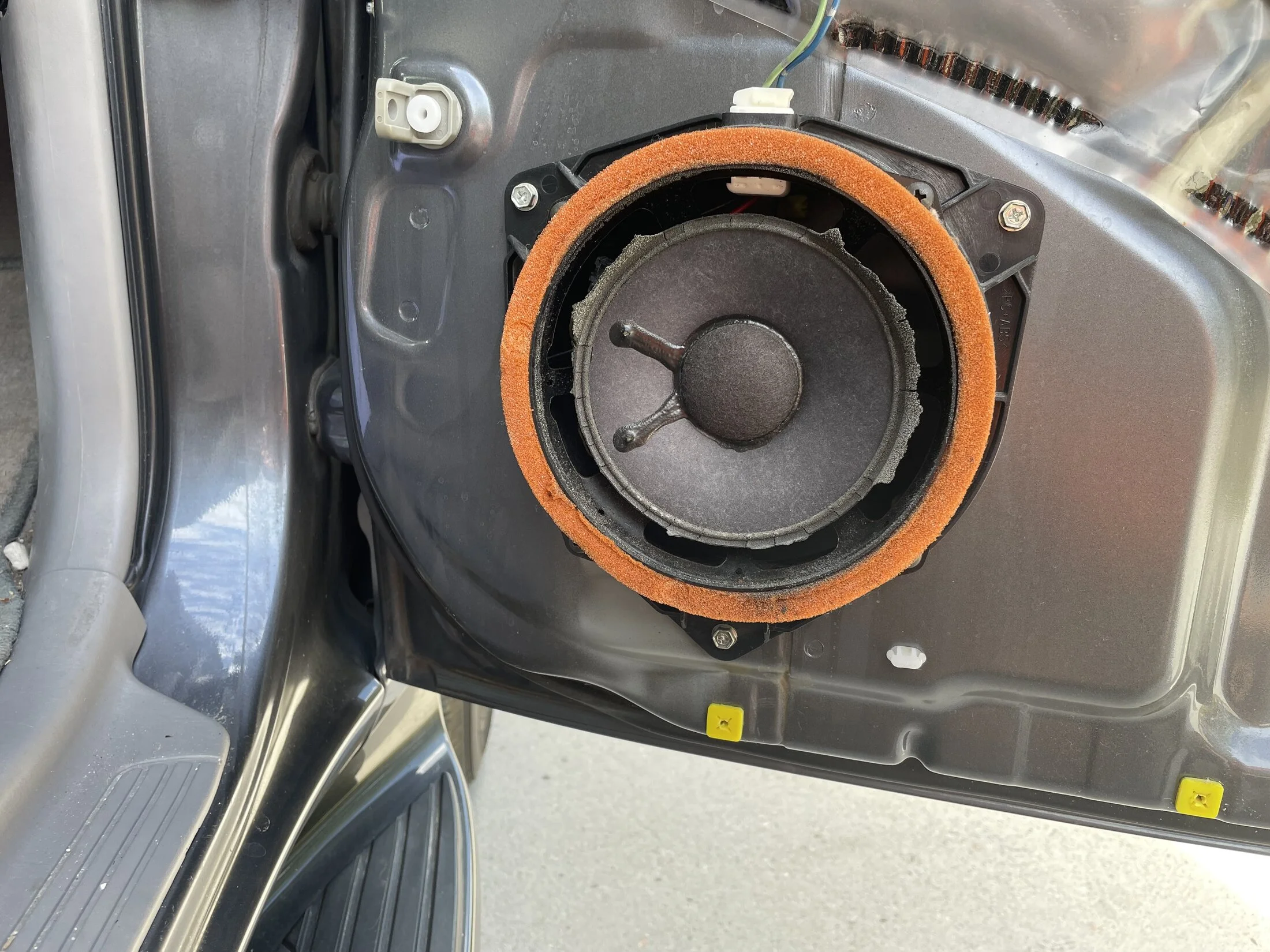

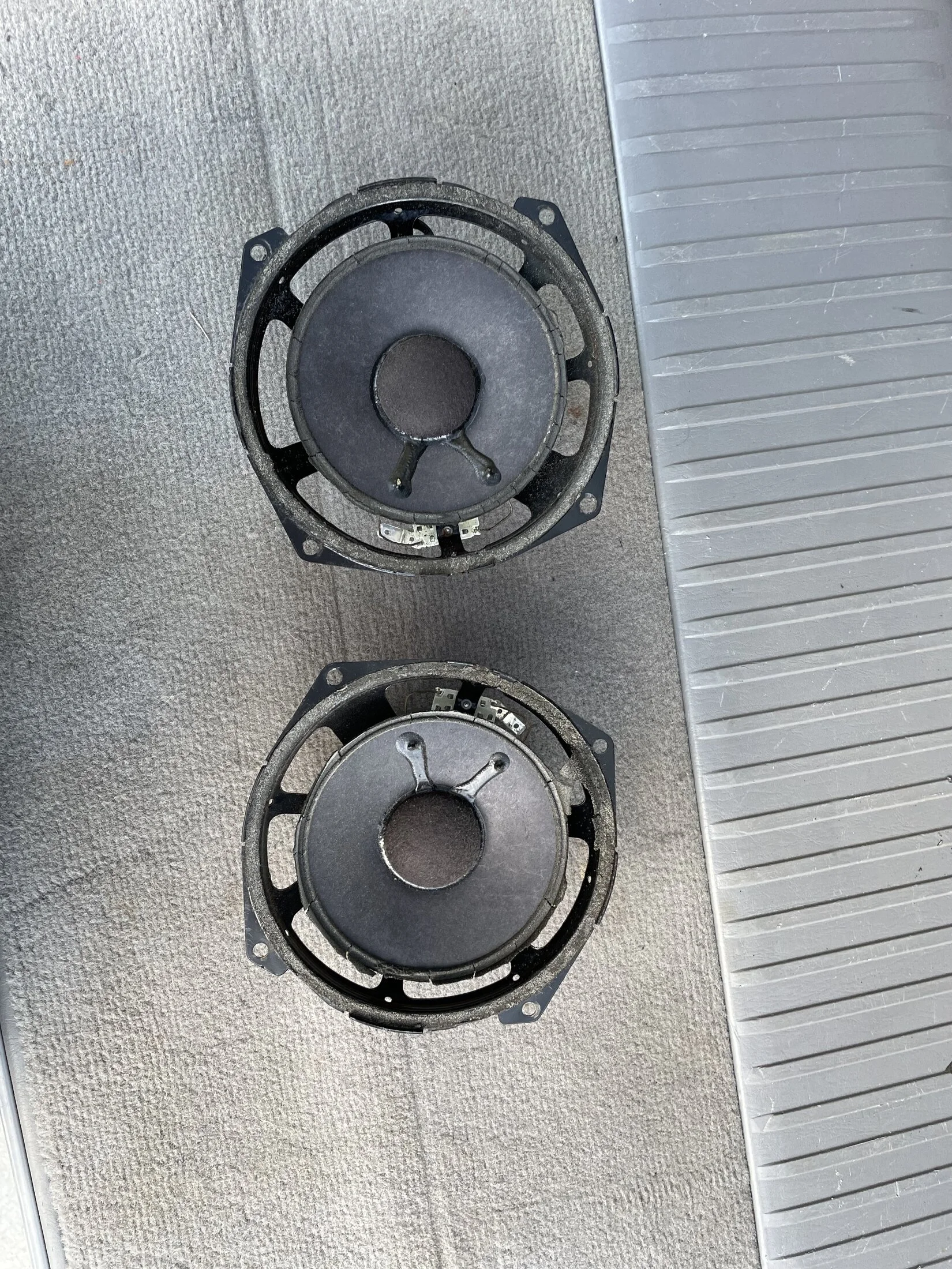

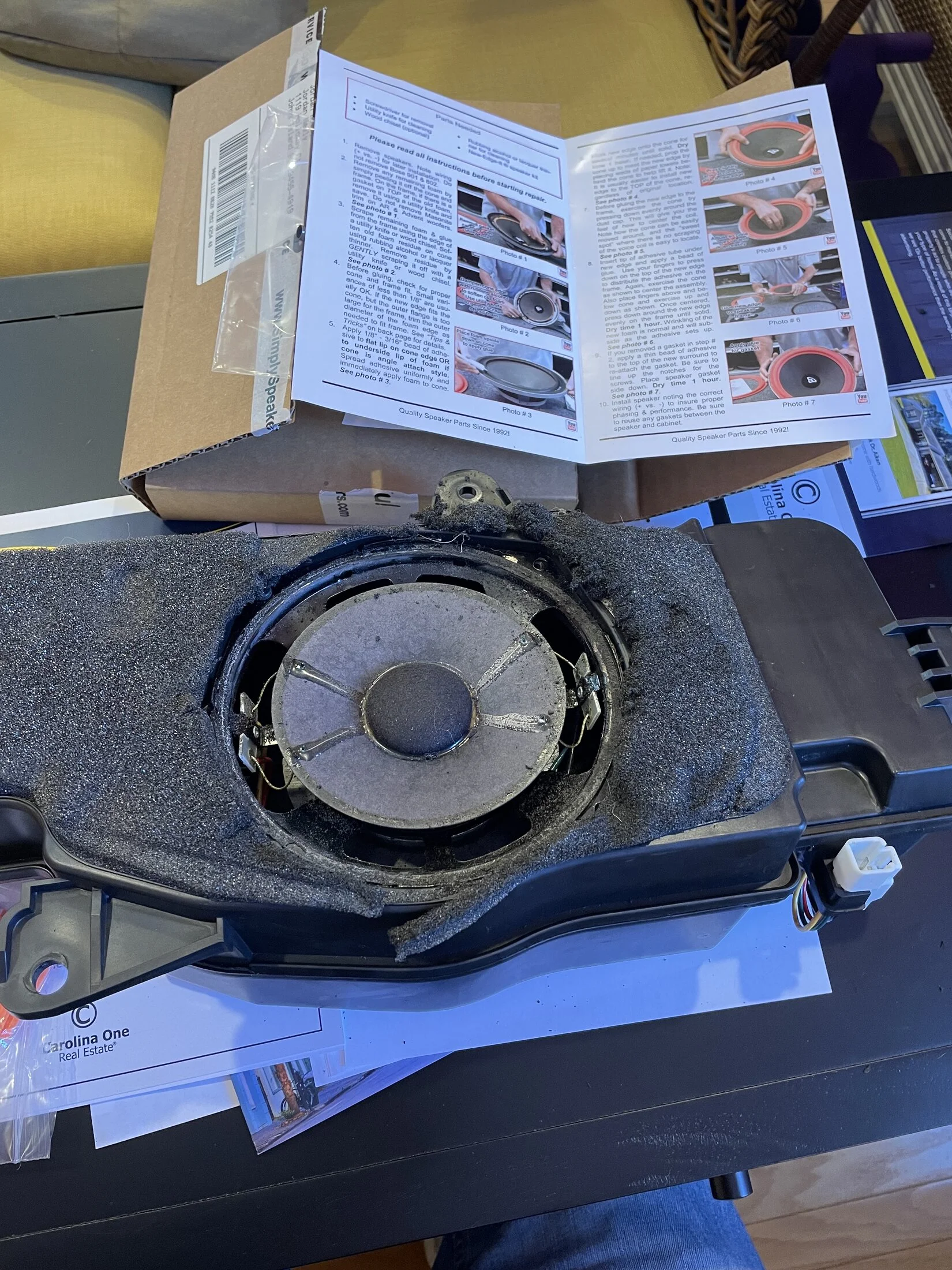

Next up was the speakers. They just sounded awful. It’s pretty clear why… ordered new door speakers from crutchfield that included tweeters. I honestly haven’t been very happy with the sound quality from the ones I bought and I don’t have very high standards. I believe I got the Infinity Reference speakers. Not super high end but not the cheapest I could find either. The passenger tweeter failed after less than 2 years so I just unplugged it and honestly couldn’t tell a difference. I re-coned the “sub” in the back since there wasn’t an easy plug and play replacement.

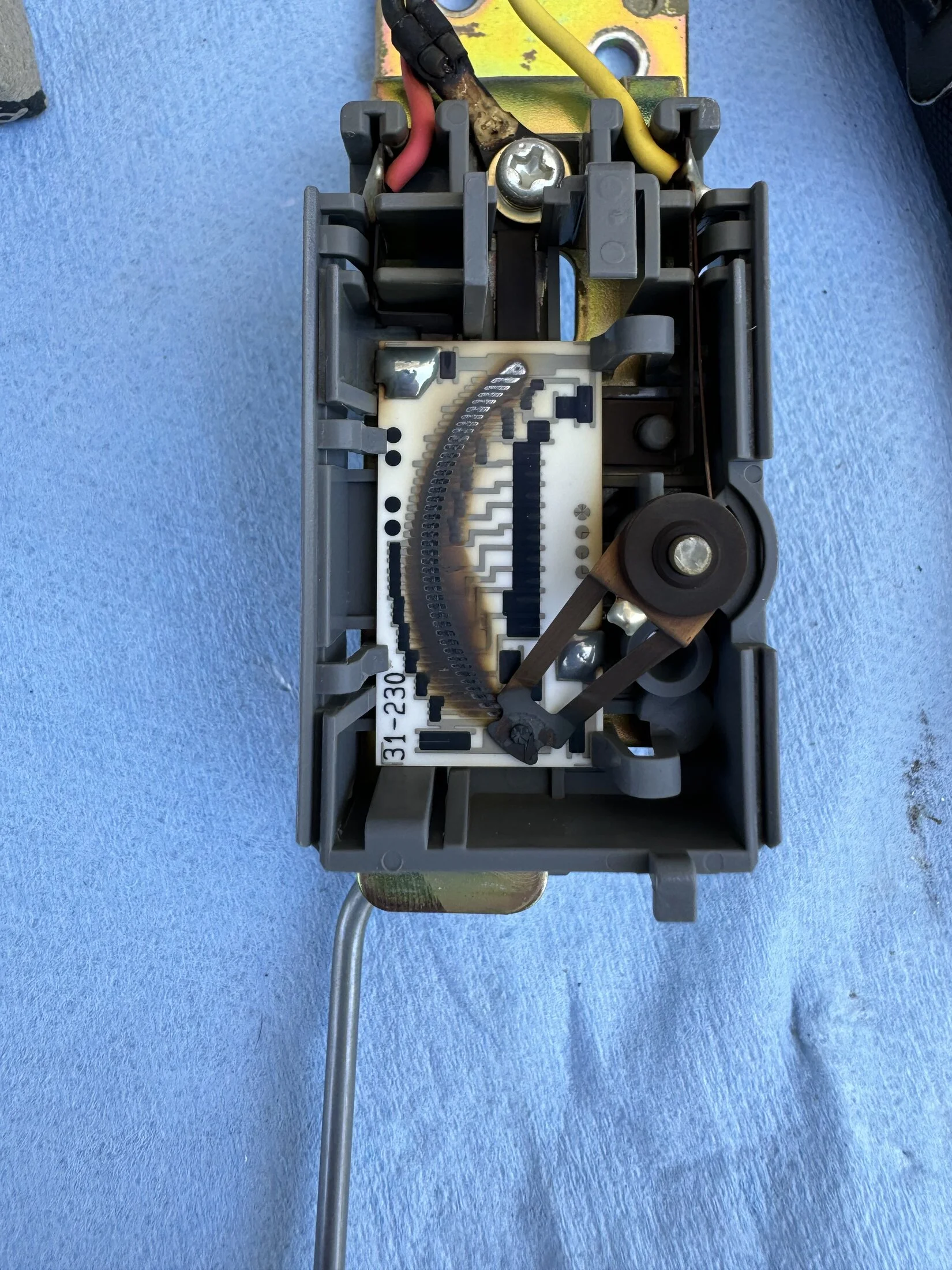

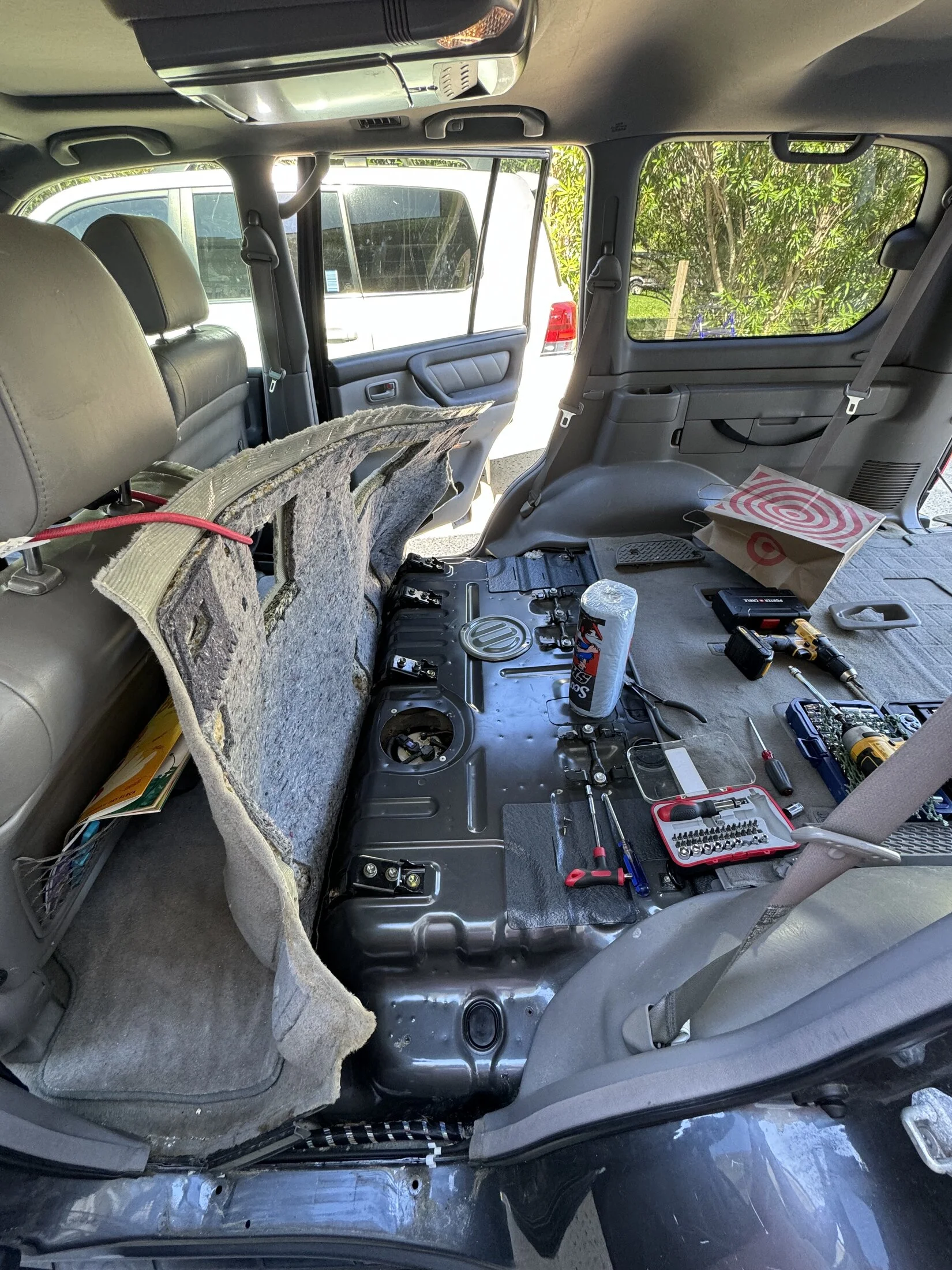

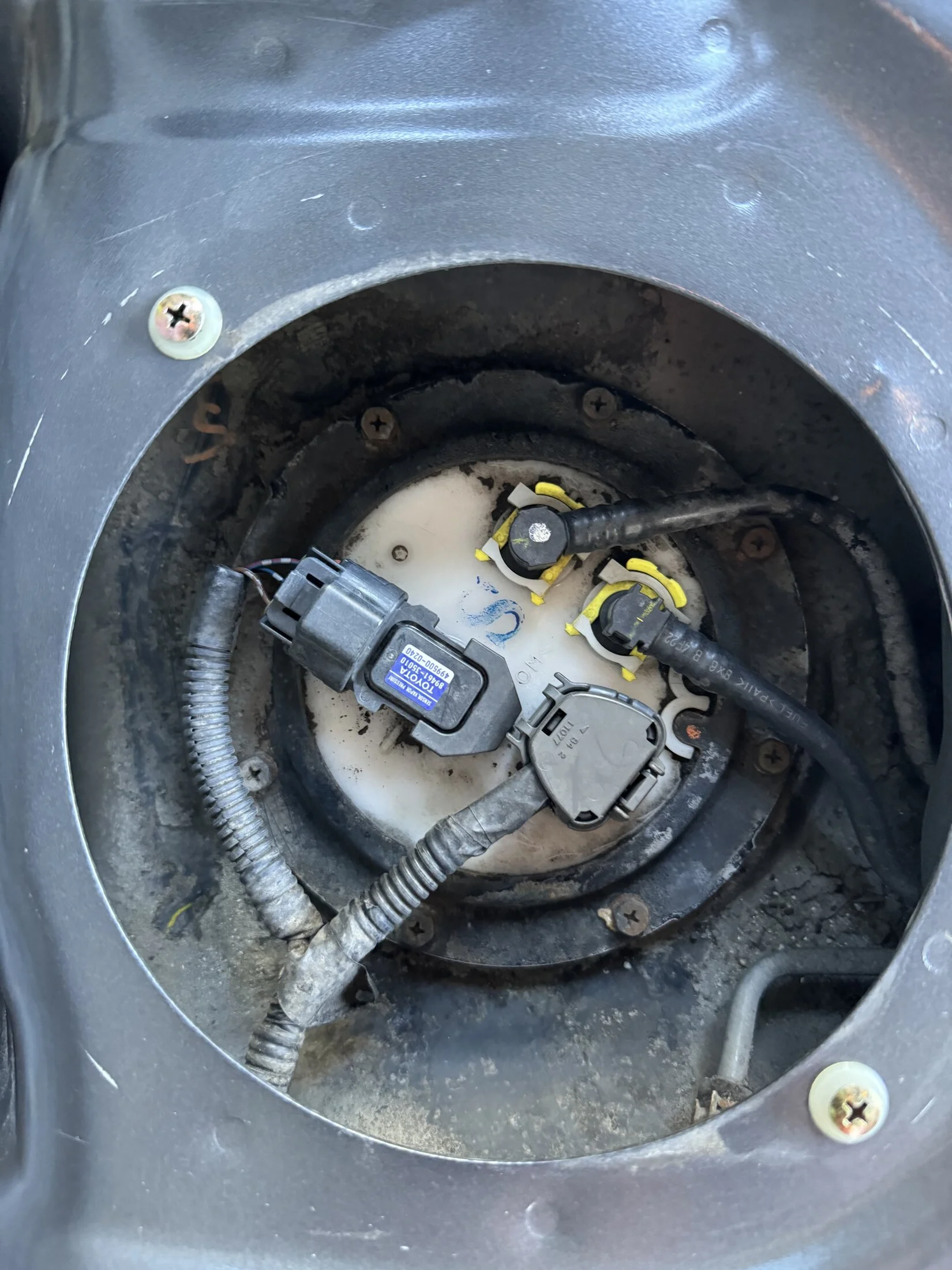

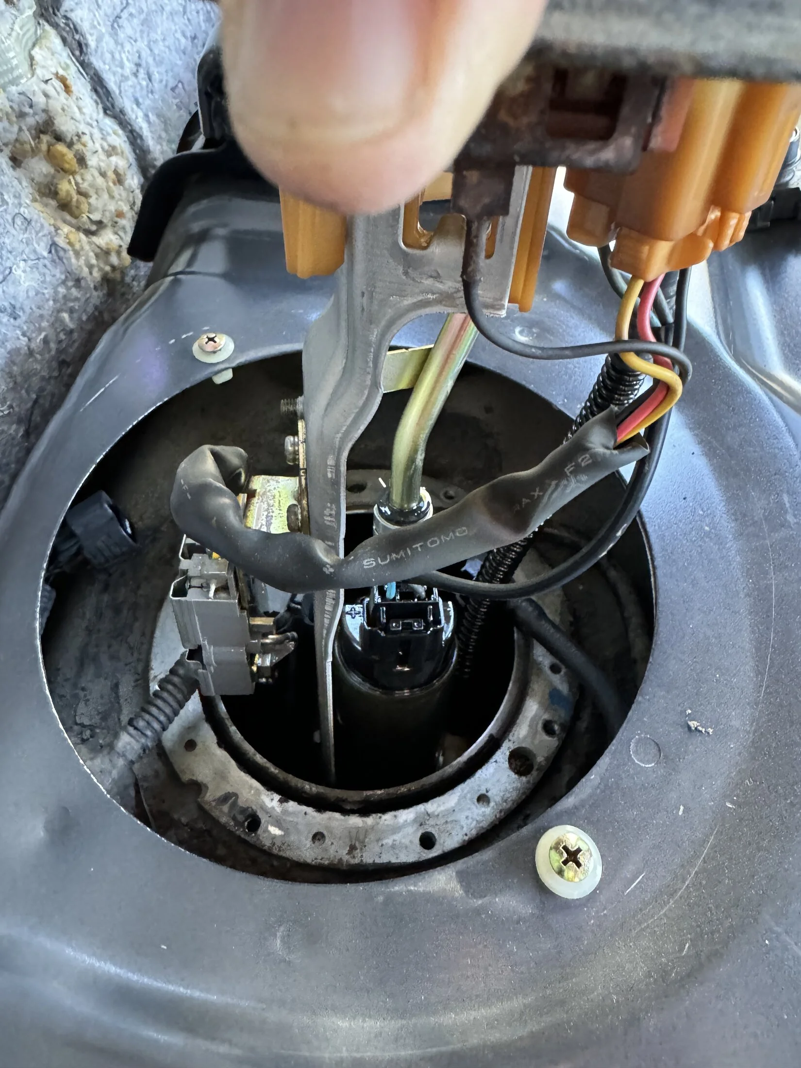

4/23/24 Started to notice the miles to empty would change dramatically randomly after shut down and restarts so I figured the fuel sending unit was starting to fail. Ordered OEM fuel sender, and denso fuel pump kit to replace while I was in there. Fuel filter and idler pulley replaced as well. OEM on both. Cut the fuel filter open and it certainly could have been the original. It looked more like a used coffee filter.

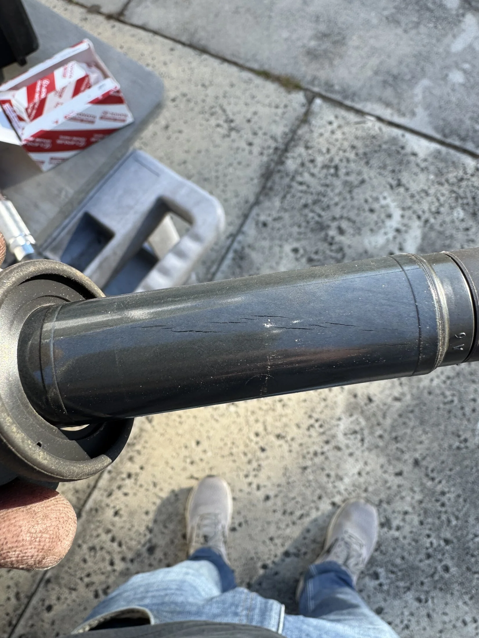

I knew one shock had failed since it had fluid running down it for a year so went ahead bought OEM shocks again. The rubbers were pretty toast as well but could have been worse. The tip on buying a ratcheting wrench for the rear shocks probably saved hours haha. Road noise was cut way down after replacing and got me looking forward to replacing all the suspension bushings to see how much it helped.

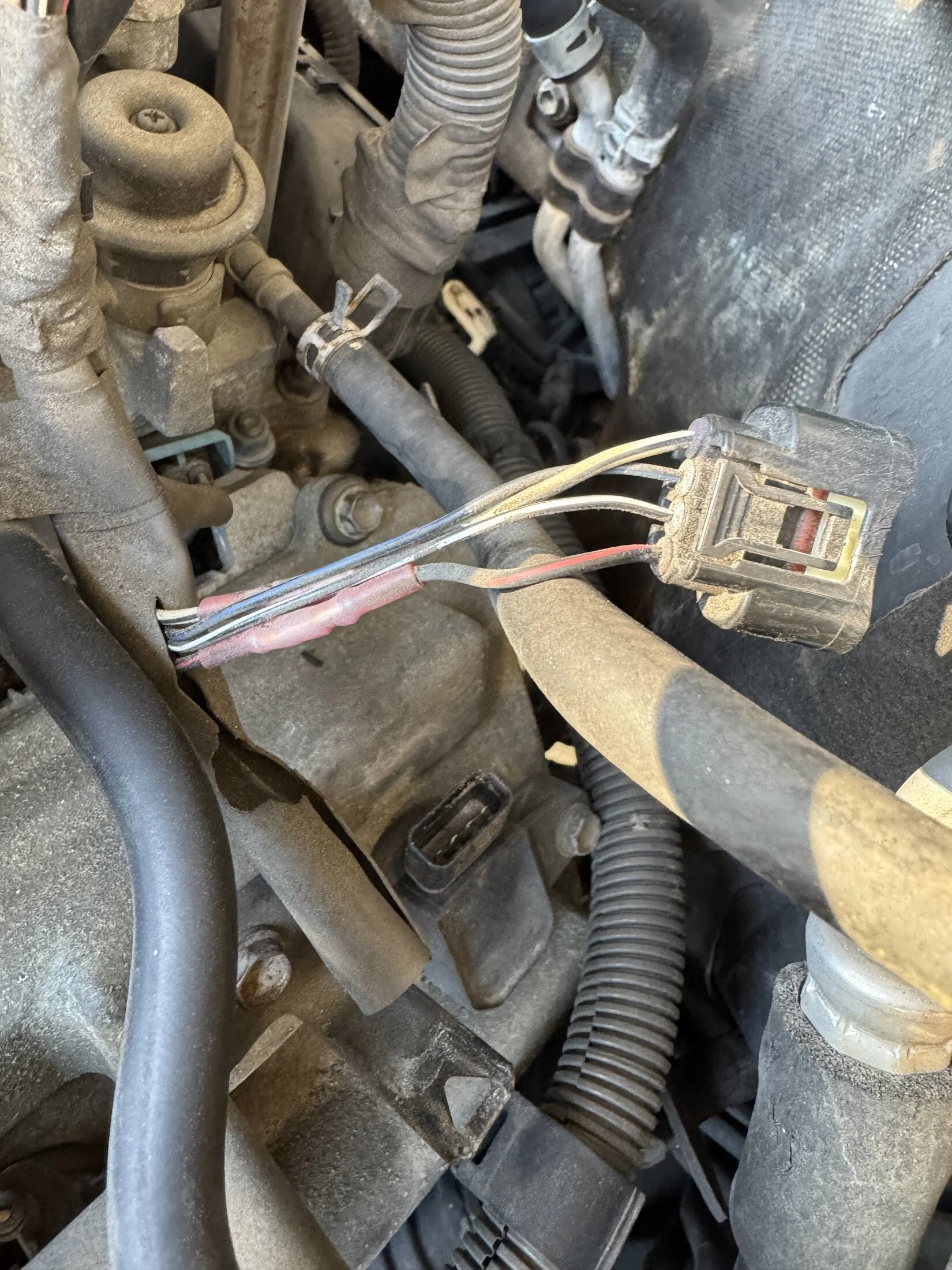

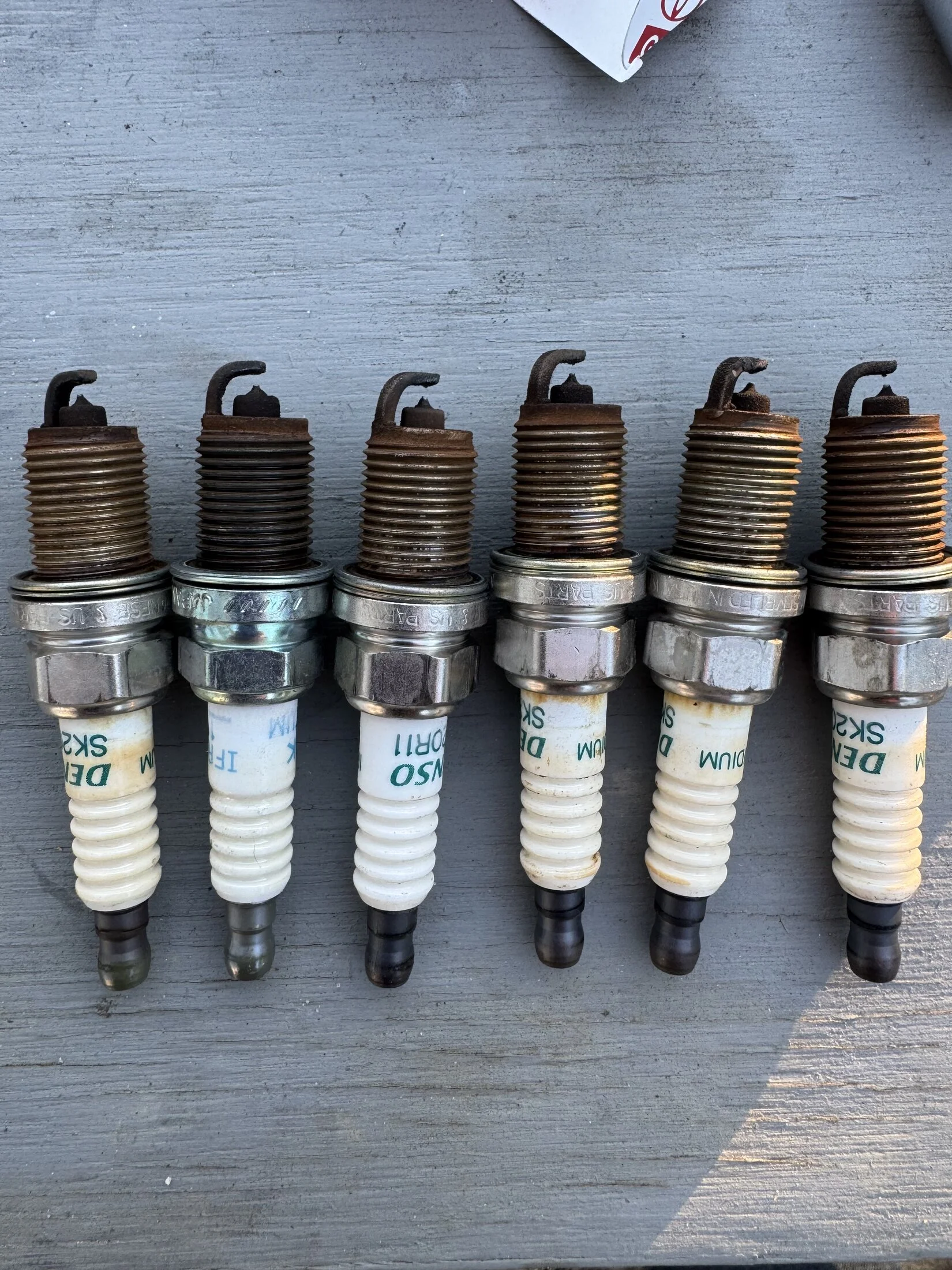

Next up were the spark plugs. I didn’t have any record of them being replaced since 2010 and only 85k miles. I’m on 278k at this point. I was pretty worried about this one. Everything went smoothly and luckily no plugs broke. The coil packs are on my list next due to some cracking. Also found a nice previous repair of the wires running to the coil packs. Damn rodents.

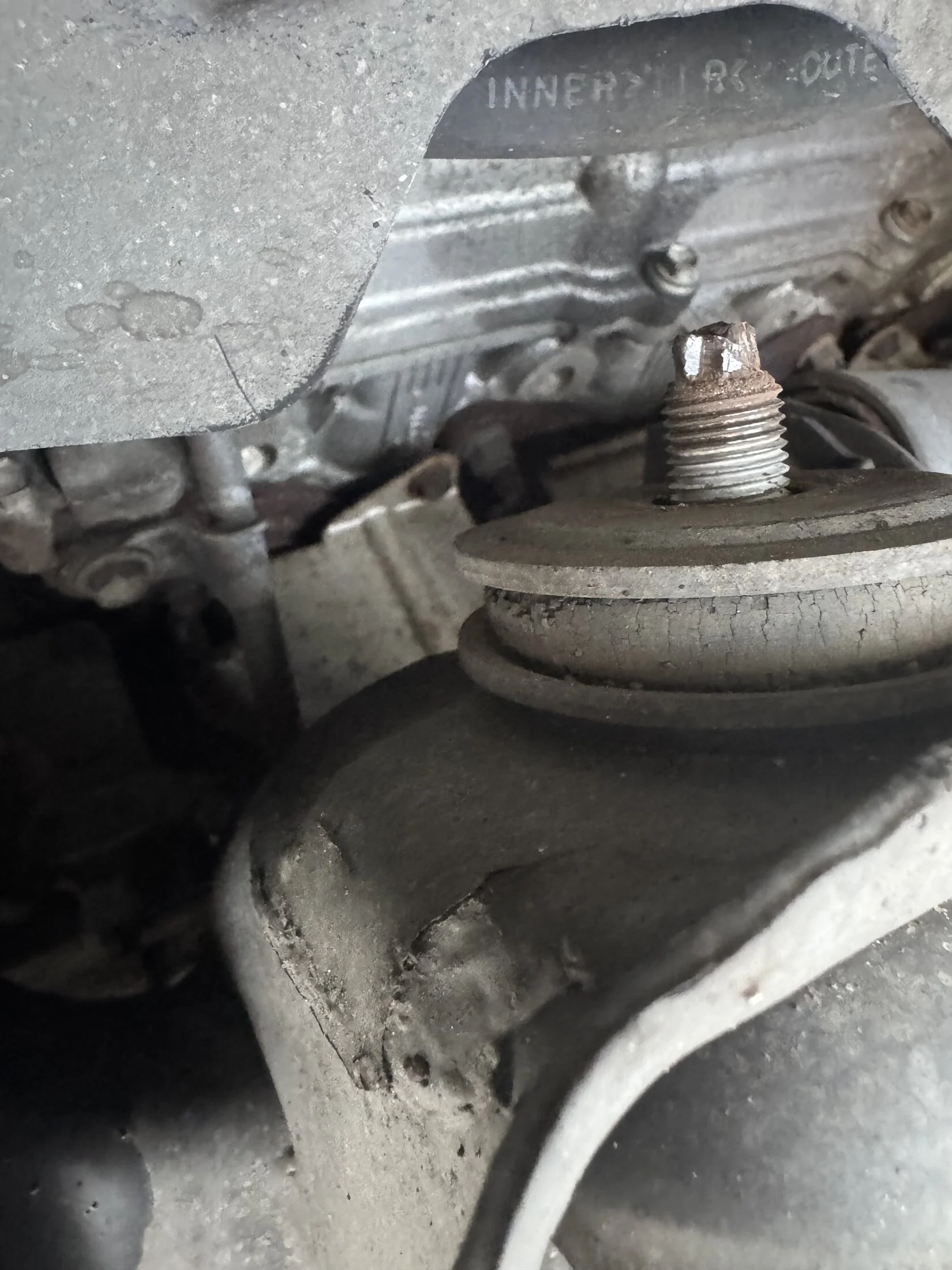

My front end started squeaking embarrassingly bad during this trip. Narrowed it down To the upper ball joint passenger side, so I had to go out and buy a baby grease gun and a needle attachment to get grease through the dry rotted and torn boots. Went ahead and did all of them then bit the bullet and ordered UCAs, LCA ball joints and bushings and sway bar bushings. Kicking myself for not ordering engine, tranny, And diff bushings to just get all of the rubber up front done.

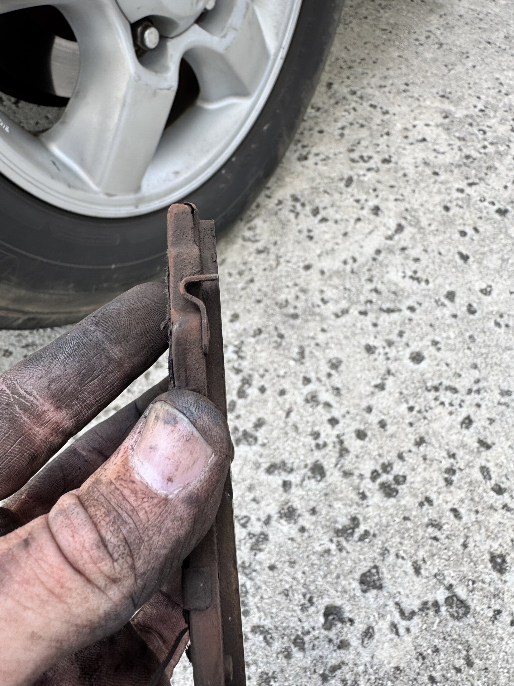

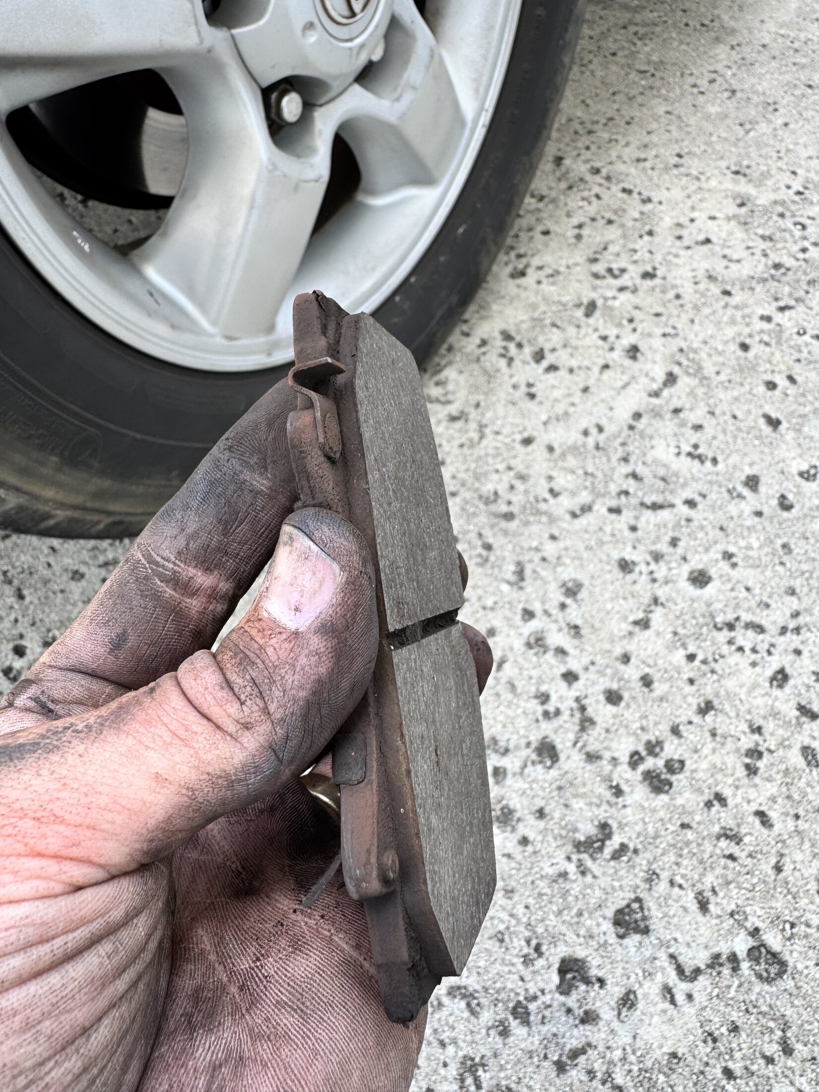

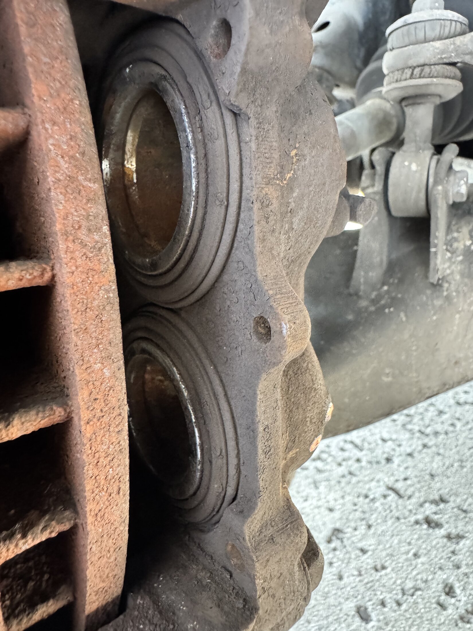

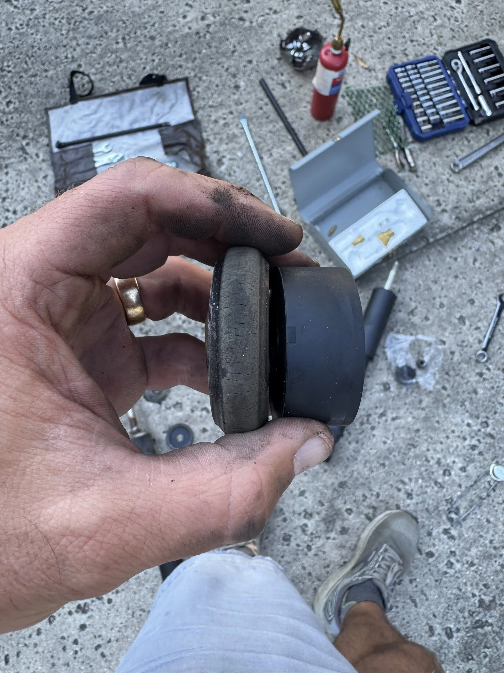

Replaced front brakes with OEM. the last record I had for those were 70k miles ago back in 21. I think I got my moneys worth out of them. reading up on the confusion on OEM anti-squeal shim orientations had me wondering if I'd be able to hash it out. looks like toyota might have resolved that for me by adding spring points that insert into the caliper piston itself. took me a few rotations and spins to figure out how they went in until it clicked that the pistons were hollow on the inside and those would fit perfect. swapped everything out and bedded them in. stops a whole lot better now!
