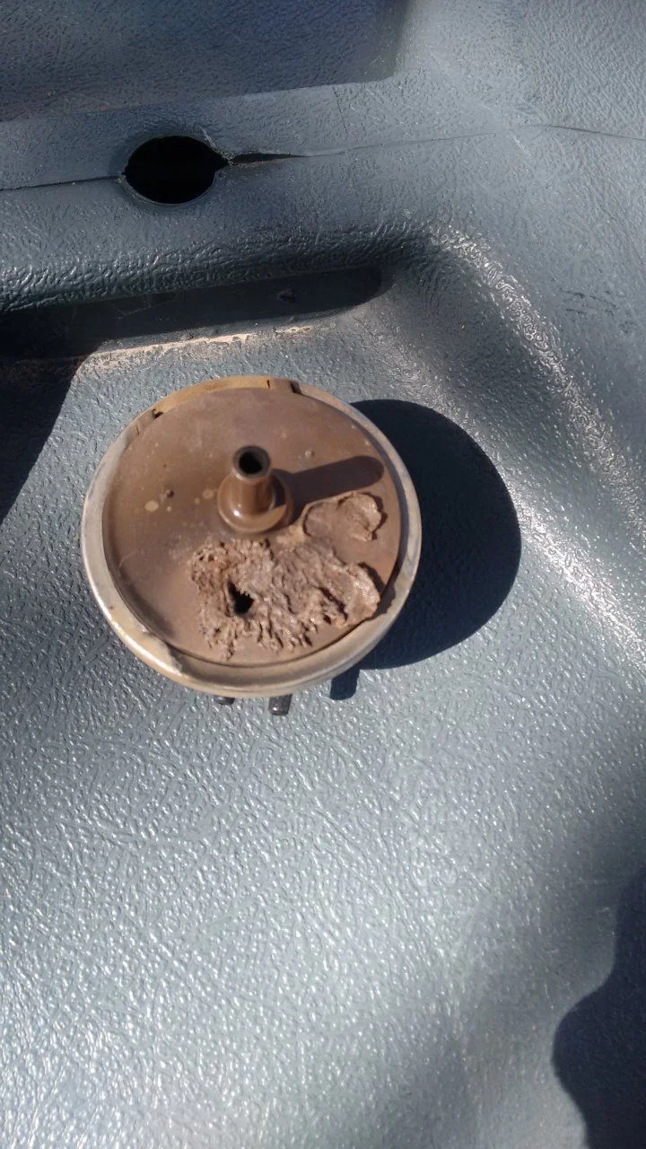

Ok Hardy boys, here's another clue. This is the bottom of the EGR vacuum modulator and the sound I heard was exhaust (or something) blowing out of it. Off to get a replacement, but don't want to install it until I understand what's going on
Those things are unobtainium in town. But I don't think it's the root cause. The rubber hose/tube thing that connects to the bottom port goes to the bottom of the EGR valve, and it's spewing hot exhaust. That can't be right.

Another bit of info - when I first checked the vacuum modulator, the lower hose was off.
I found this thread that sounds very similar: near RTH: Vacuum Modulator Meltdown
The conclusion there was that excess back pressure from a clogged catalytic converter blew the hose off the bottom nipple, and exhaust gas from that hose then melted a hole in the modulator. Sounds reasonable I guess. My EGR valve has apparently been working correctly since it's not throwing codes.
Thing is, I replaced the catalytic converter a few years ago. Seems odd that it would be tanked already. Any suggestions on how to check it short of cutting it out?
So final resolution on this was a clogged catalytic converter. Excess exhaust back pressure blew the hose off the EGR vacuum modulator and melted it. New cat & vacuum modulator, and everything is running well again. Little disapointed that the previous one only lasted about 7 years. Also surprised at how quickly this happened - I would've expected a clogged cat being kind of a gradual thing,
