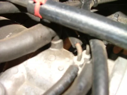

Letter code to letter code for the two lines you have from the throttle body to the EGR modulator (Smaller green space ship?):
EGR Mod "R" line --> TB "R"
EGR Mod "P" line --> TB "E"
Also
EGR Mod "Q" line --> to T-fitting on top of the Larger space ship (EGR valve? sorry for the technical jargon) the line on the other side of the T goes to a nipple on the brass square bracket under the intake manifold. From here a line goes to the "yellow filter according to the TRD manual" or in reality the orange T fitting.
Connected to the orange T is a line supplied by TRD that goes to the third nipple on the TB (next to the "R" and "E" nipples on the throttle body)
The OEM line that was connected to the "Orange T" is the line that is connected to the intake manifold opening where the intake runner is bolted. As you can see in the picture, I just left mine there ghetto style because I read that the intake runner gasket covers the hole. I will cap it off soon.
I hope this helps
And yes that was a typo, I am glad you were NOT injured ;)
