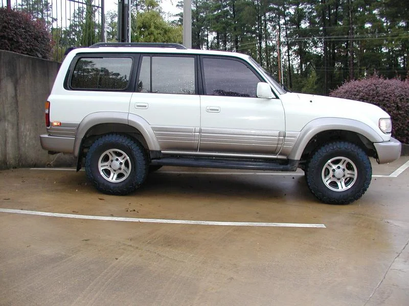

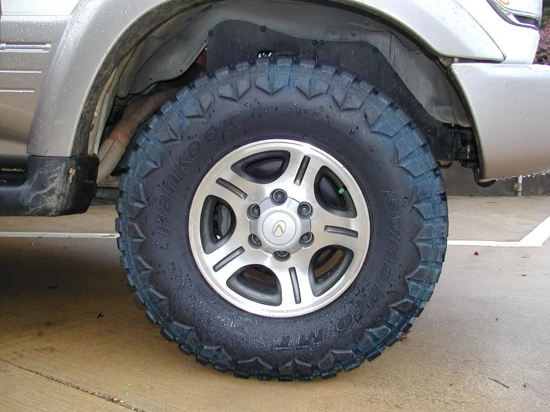

I wish that they still came with big wheel arches and flares like this! I guess I am going to slow on the LX570 to be ready for hunting season so here is my low budget hunting mod to get my Billy Goat, as I call it, ready for hunting season. An OME medium lift in Aussie style with a high rear stance and some radial mud tires from Korea to give me the grip for our Mississippi mud. I wish that we had some aftermarket flare options in the US that would get us back to this look and function for mudders. The high rear stance makes it level out and tow my aluminum 4-wheeler trailer just right. The ride is not harsh, it is actually smoother than before.

Where did you get your OME work done? Down in Laurel,MS and trying to find a good shop that work withs ARB/OME to put something on my series 200......
Lots of Shops will install, Slee sells parts!
I bought my set up from Slee off-road (very knowledgable about 200 series OME mods) in Colorado, had it UPS delivered to the house (3 days). Then Big 10 tire installed it for me for around $400 aligned. You need to find a Toyota loving supension and alignment man or drive up here and see Nate at Guckstadt Big 10 or Toleson at 49 tire in Richland. I had my tires balanced with stick on weights and it is right, rides good, no shimmy in wheel, tracks good! My 200 is LX hydraulic and I am studying the system to see if Slee's height control over-ride switch will lift it or if I nee to modify the height sensors. This solid axle control arm 80 series truck is easy compared to a 200 series.
