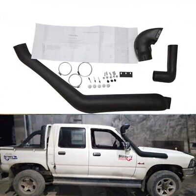

This airbox is on the RHD side because of the turbo as well. Makes for finding a snorkel a it of a PITA
I saw this on ebay... picture shows an older style Hilux with left side snorkel. Who knows about the quality... take a chance on it and let me know? 😁
