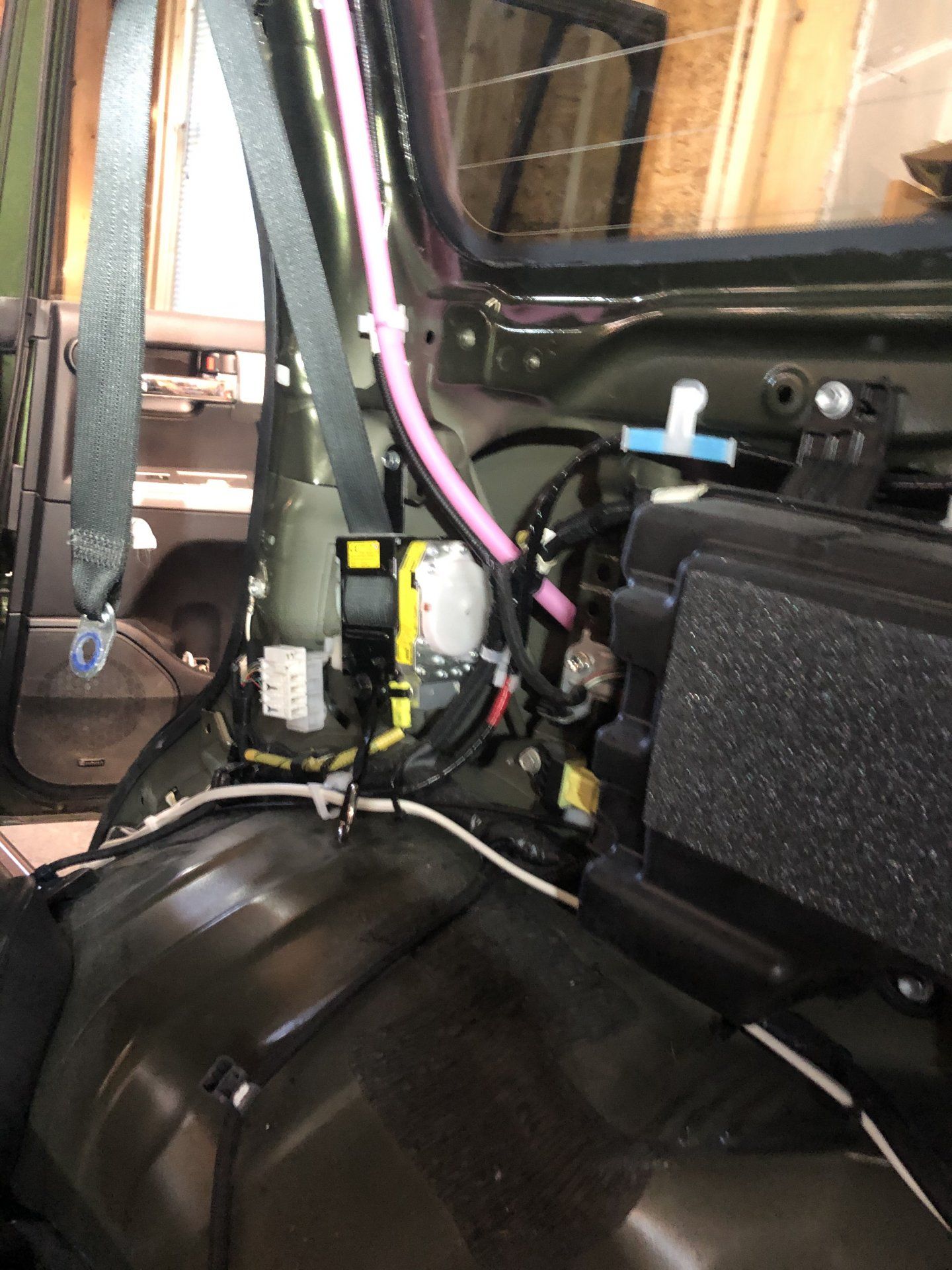

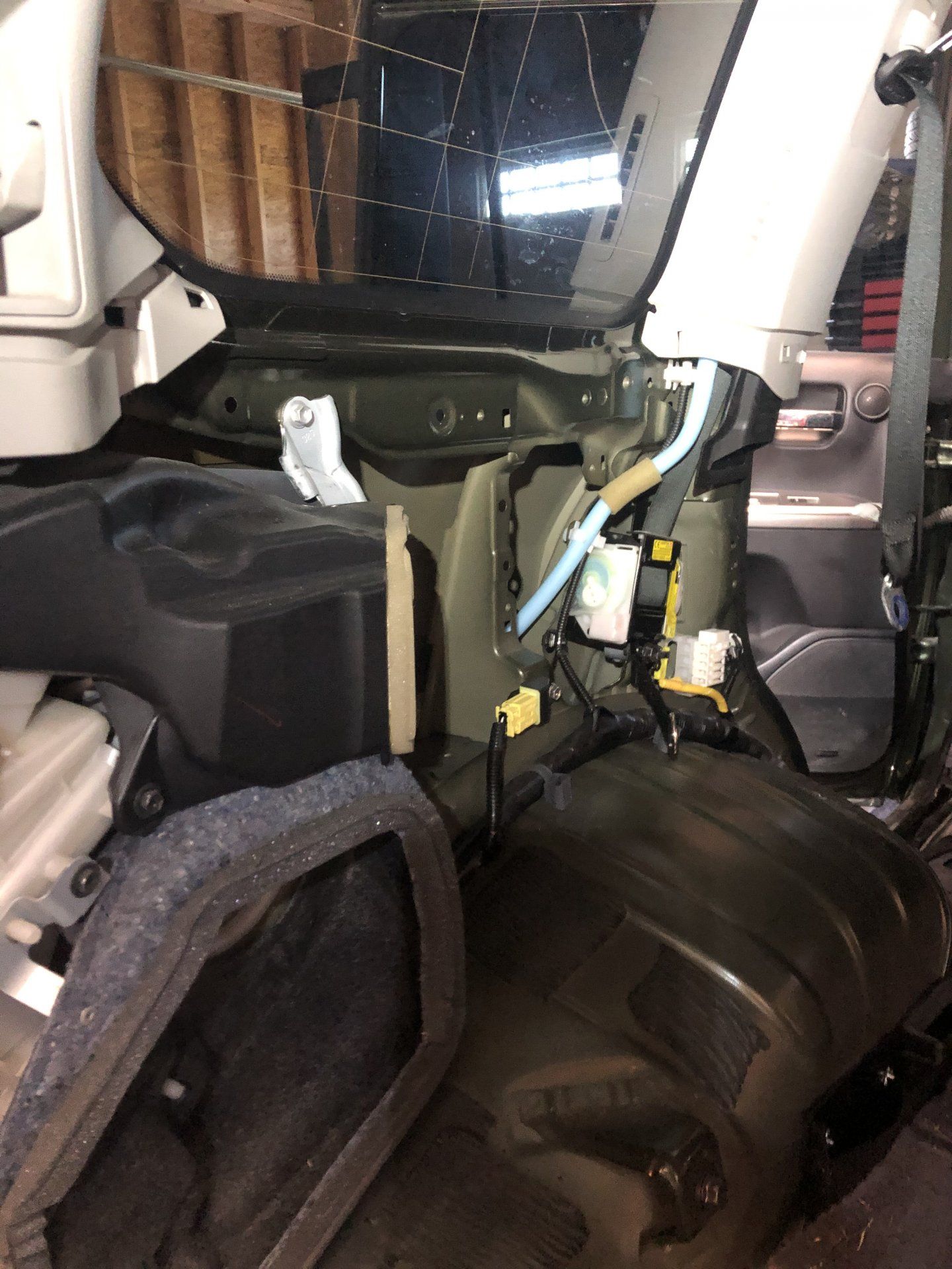

Related question: I remember seeing a nice picture of the DS and PS cargo area sides with the panels removed but I can't find it now. Anyone know where that is? I believe @CharlieS posted it.
How about inside the glovebox?
I have the pics on my phone I can repost them - anything in particular you are looking for?
I thought you posted a good pic of behind the DS cargo panel somewhere but I can't find it now :(
@sdnative, refresh your browser window and look at post #2 - I updated it with pics.
