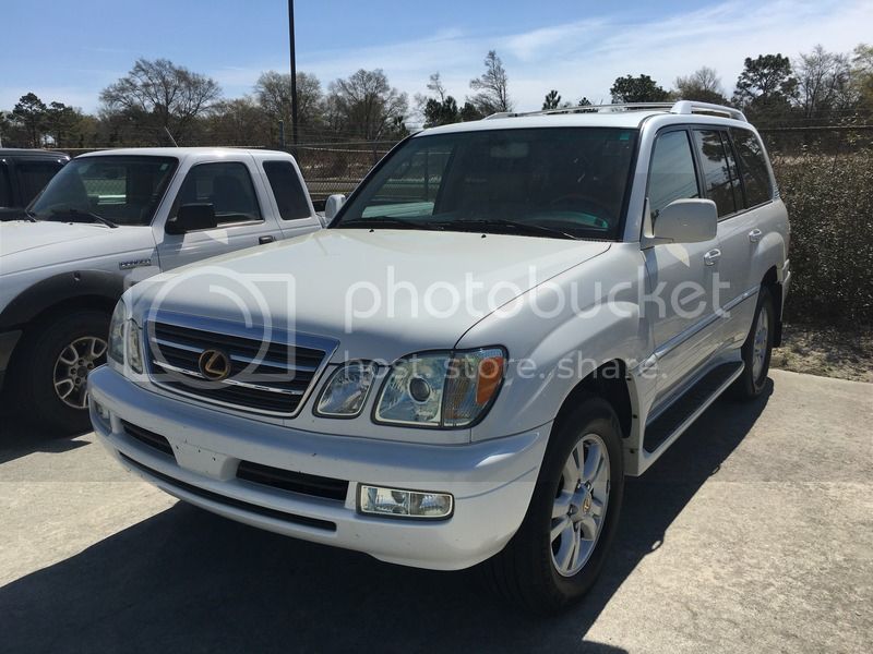

Wow... White. You've got quite the challenge there :p
Do you plan to mod it any? I would recommend dechroming/degolding via plastidip to the grill and badges. Cheap, easy and effective. There's a few on this forum that've done just that, myself included. On your white LX, it'd look killer and lessen the "Mall Cruiser" image, if that matters to you at all. Additionally, keep your stock alloys as I see they're not chrome and paint them black. Overall sweet rig. Congrats and welcome to the club! :cheers:
Yea I went back and forth between white,black and grey. I liked the white and grey because they weren't 2 tone so I ended up eliminating the black. Then just waited to see if white or grey showed up that I liked and white just happened first. I do plan on modding it. I like the mall crawler look but it has to be functional. So I guess a form and function design and mod path. I tend to not like a mod that is only form though, to me it needs to serve some sort of function also. I do plan on getting rid or the chrome and gold and do away with a few badges also.
Do you have a white LX? Have a pic of the black emblems.
Right on. My rig is Galactic Gray Mica. A smattering of pics throughout the forum so I'll refrain from adding more, but look up my posts if interested.
