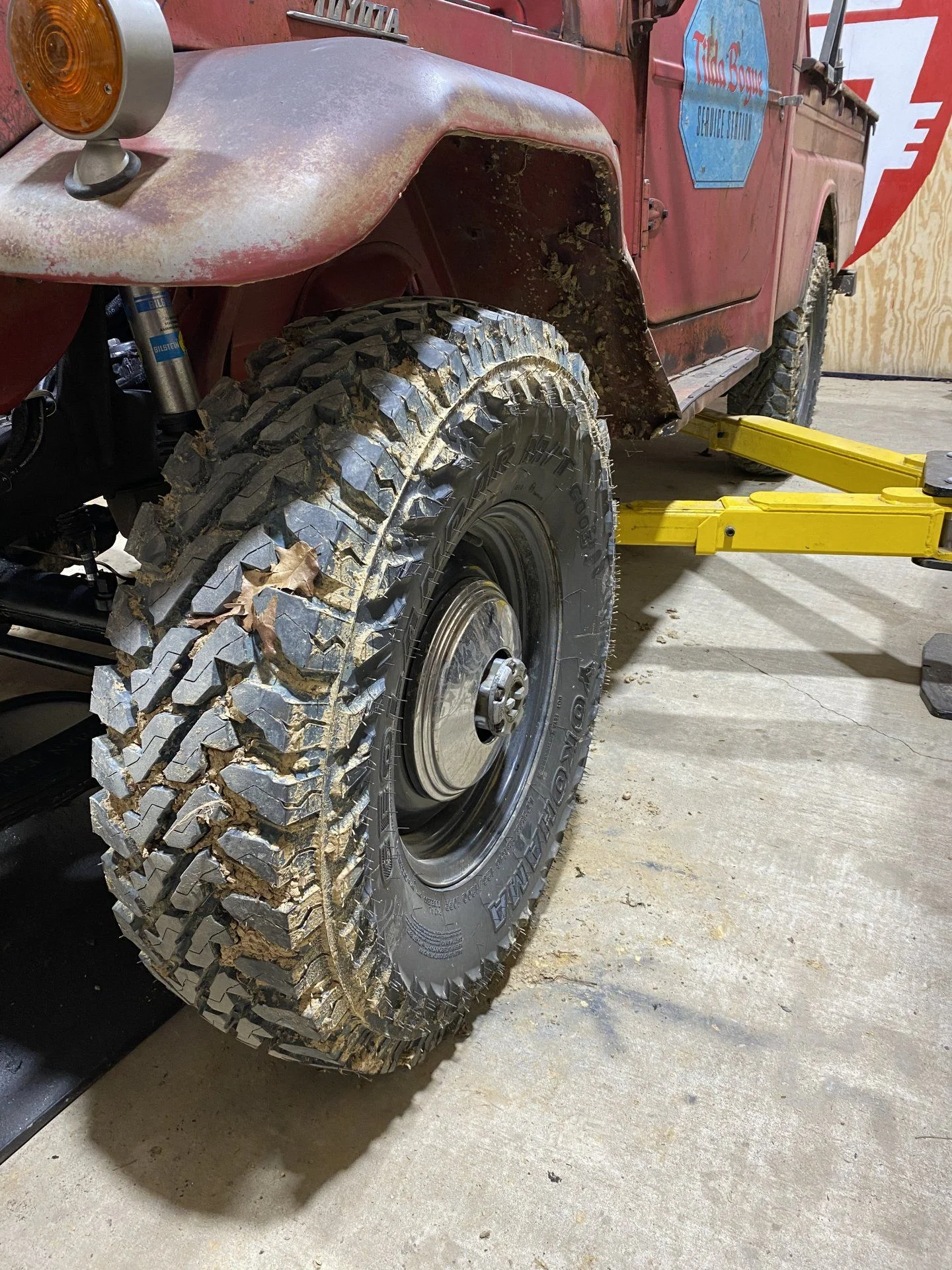

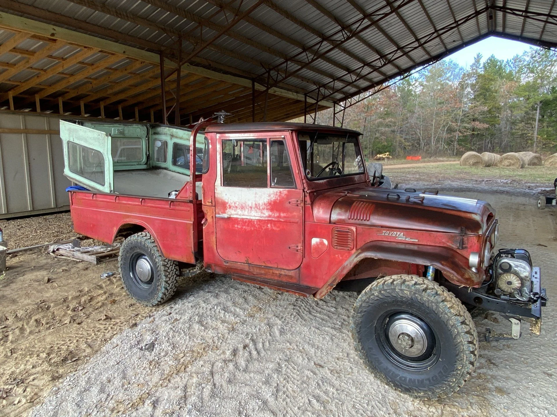

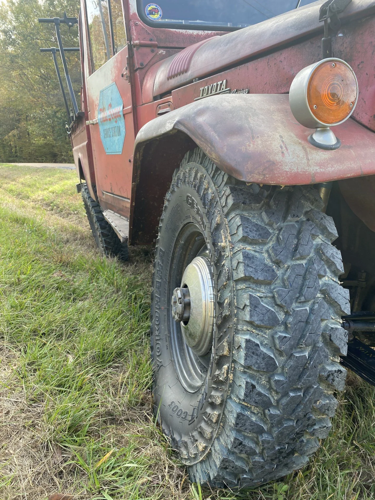

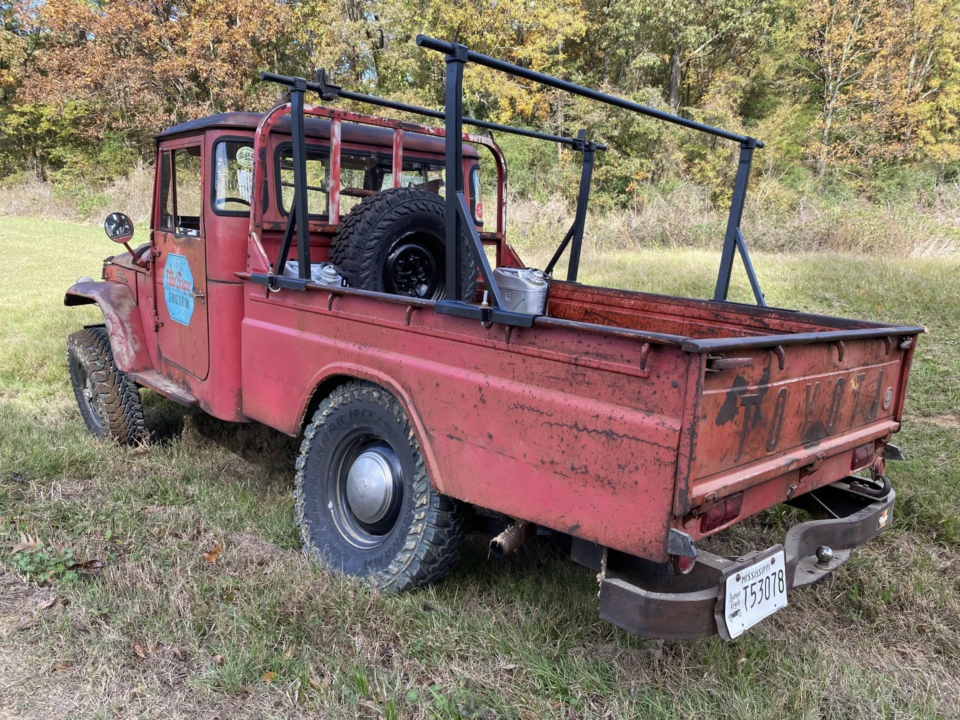

If you see the pics above my front end was substantially lower than the rear even with 3 leafs removed from the rear packs.
The fronts were medium lift with 8 leafs and I was using a stock shackle and no shims.

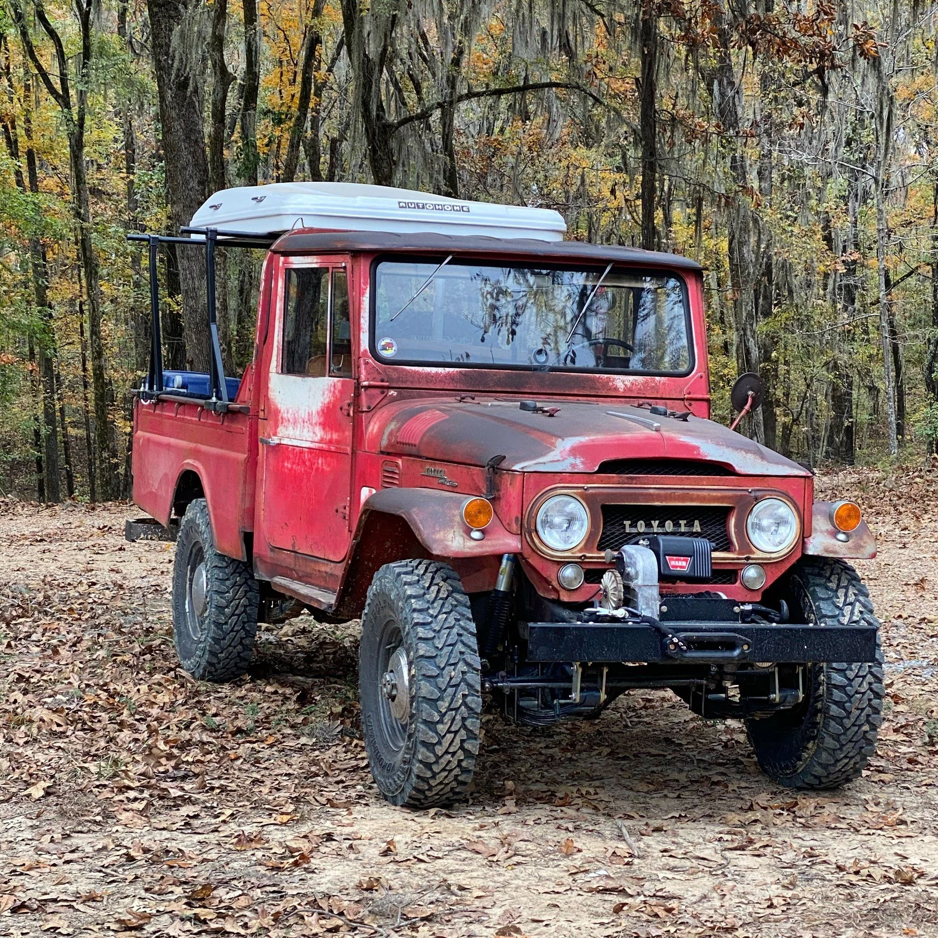

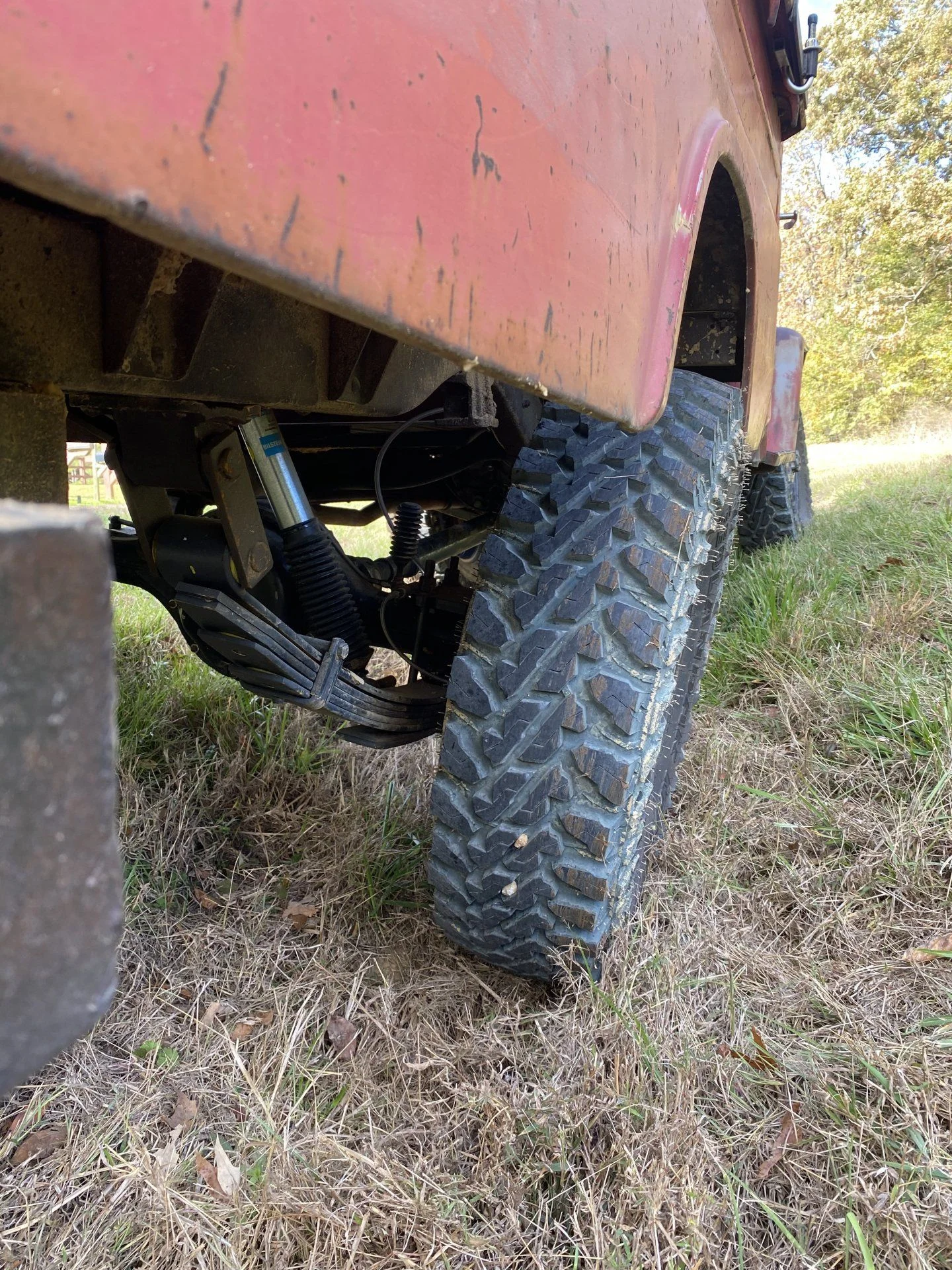

@orangefj45 sent me some 4* shims so I could add some 1” longer shackles and an extra full length leaf spring to the pack.
Did exactly what I was hoping. I’m about 1/2” lower in the front now. These springs will settle over time like my FJ55 springs did and get me a nice angle on the shackles.

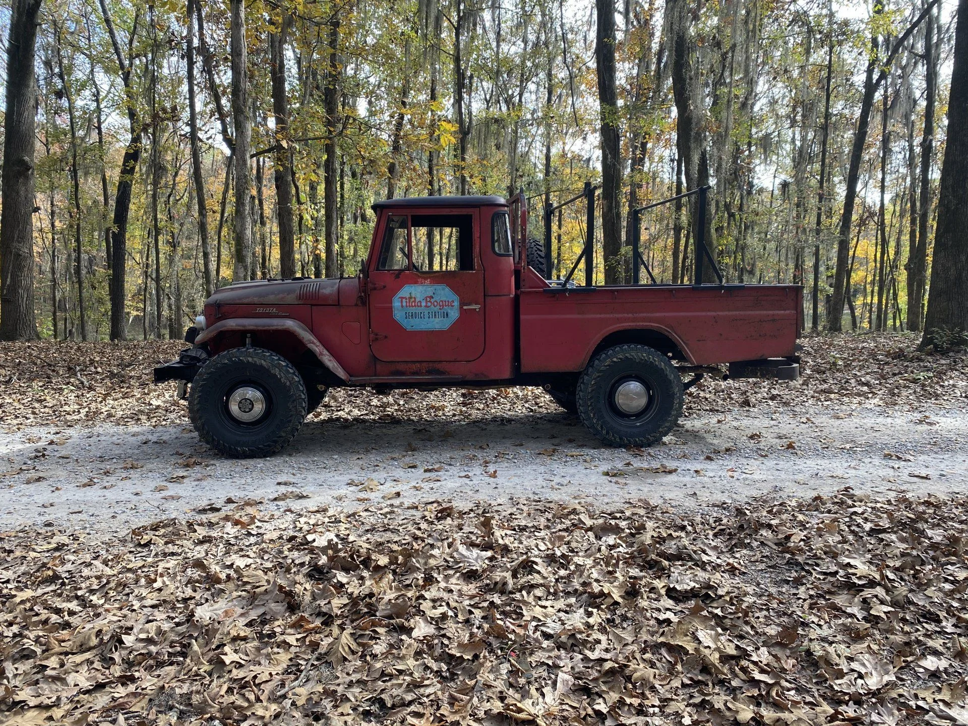

The new front suspension setup turned out real good. Sits nice and level now. Flexes like a..... well like a spring under 40 series 😆
No ramp champ here but the shackles and bumps and shocks are all doing their thing

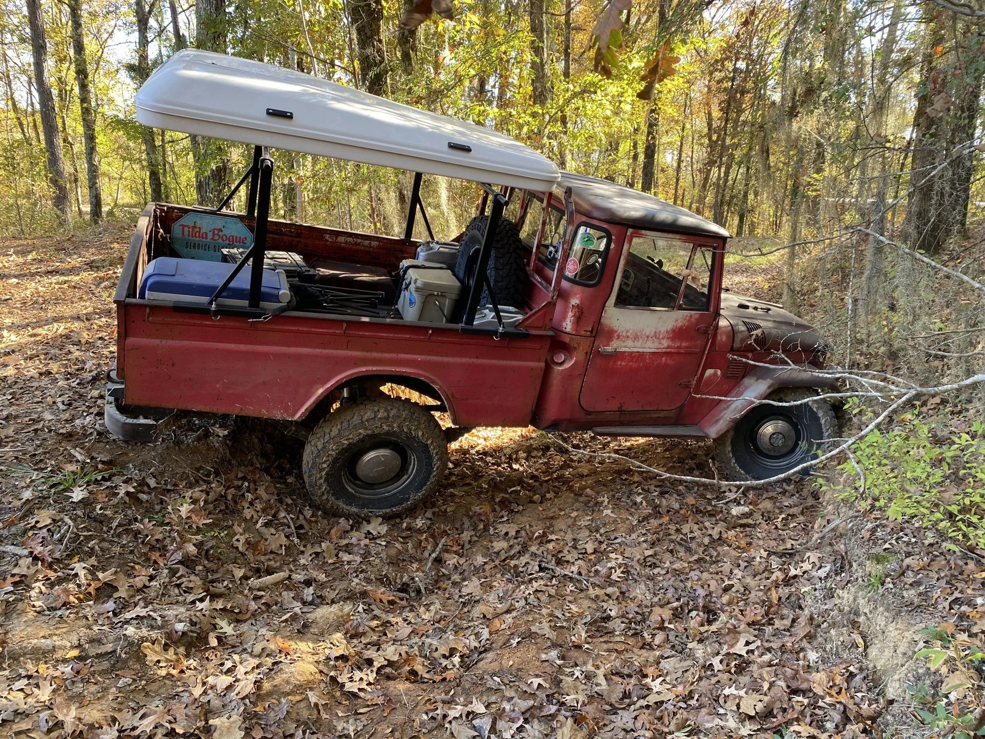

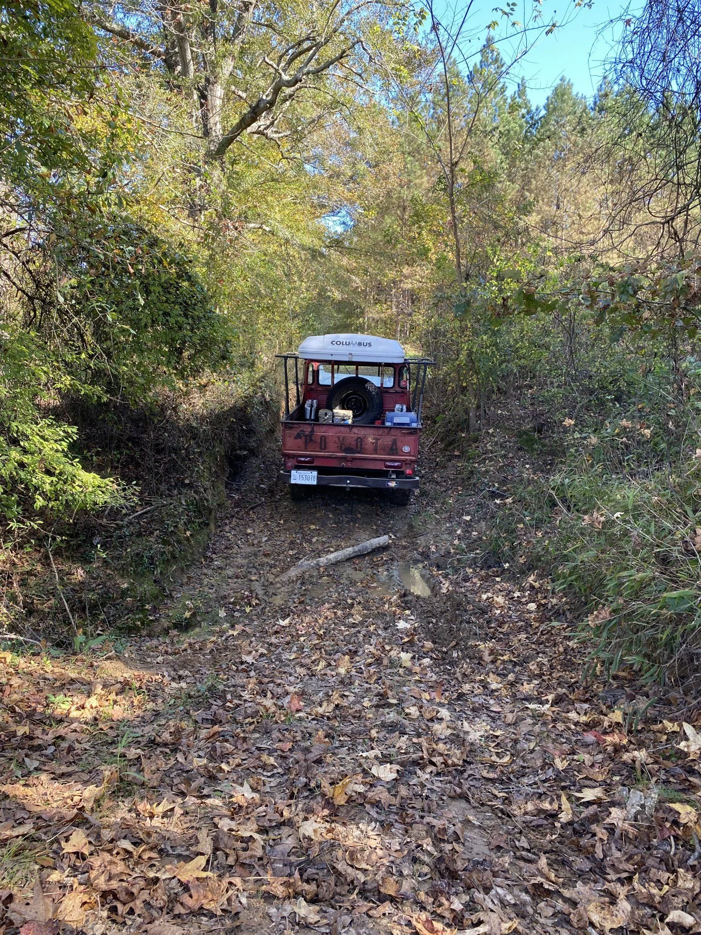

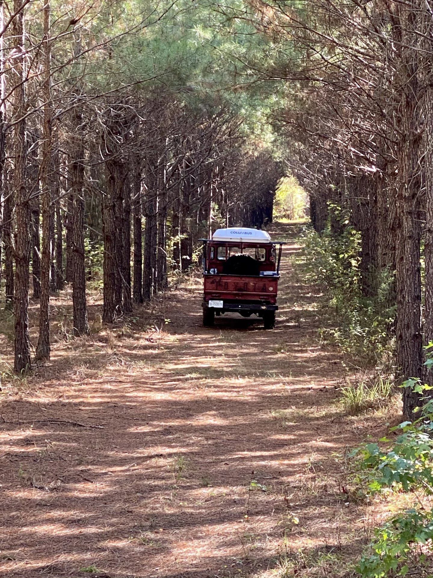

Had a nice trip in the Goat. Had it all kitted out to head to Texas but had to stay home so I had to go test the setup

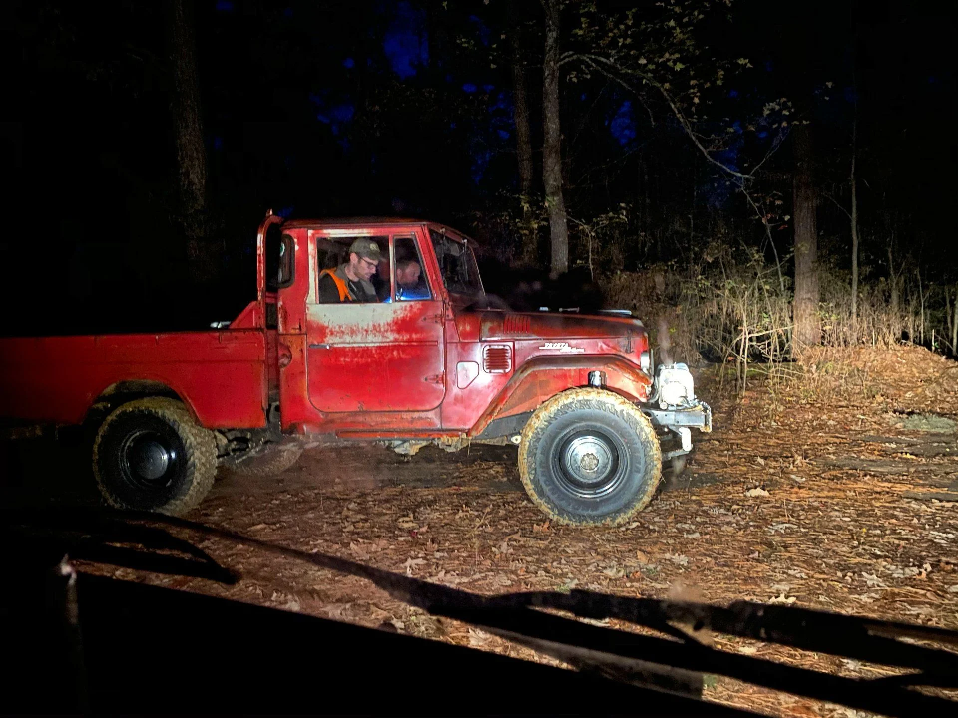

This is a corner I used to be able to cut in my 40 but the 45 got stuffed and without a locker in either end I was stuck. A quick 85* pull with the 8274 and I was able to pivot to some traction
Catch anything?

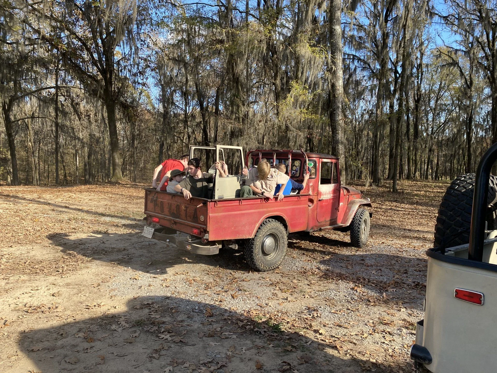

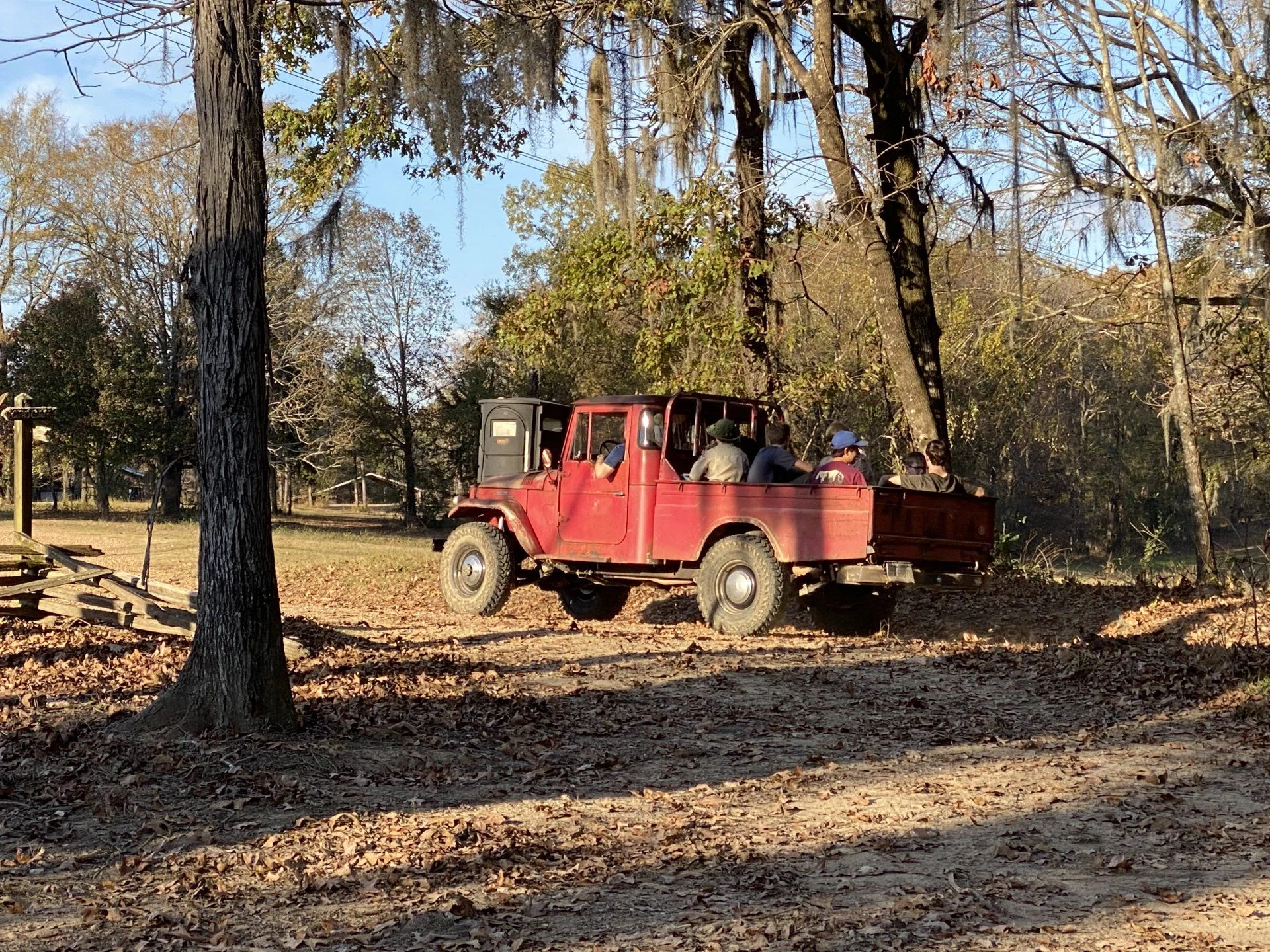

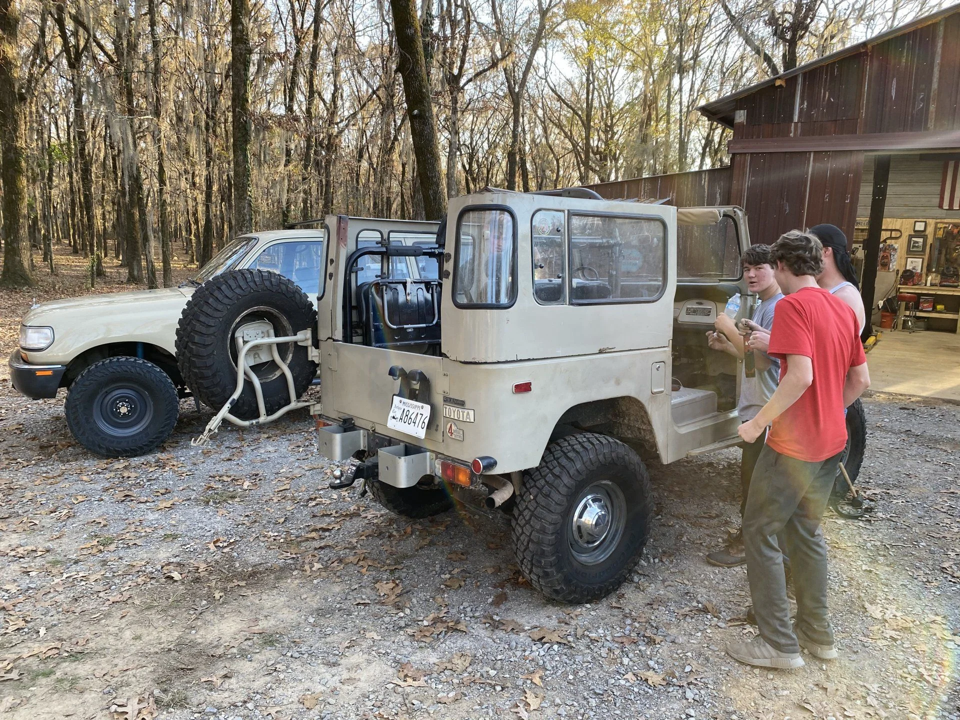

Hauling Scouts about the farm today. We got them their Auto Repair merit badge with this 40 top install.
11 kids, a hard top and a dog per one Goat
