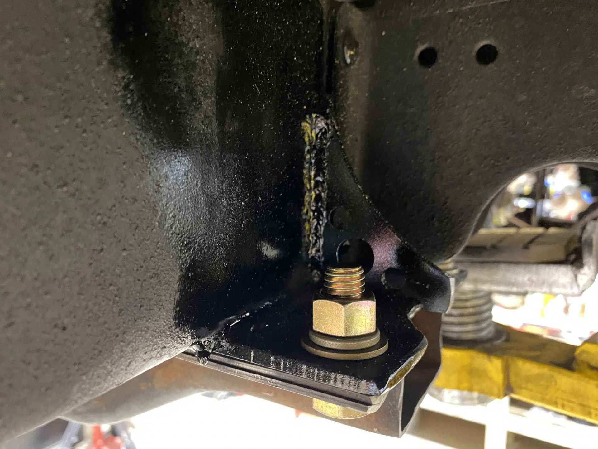

Thanks @under_psi for coming up and putting some nice welds on these plates and gussets.
I got some 1/2” grade 8 hardware to finish it off
Getting closer and closer.....

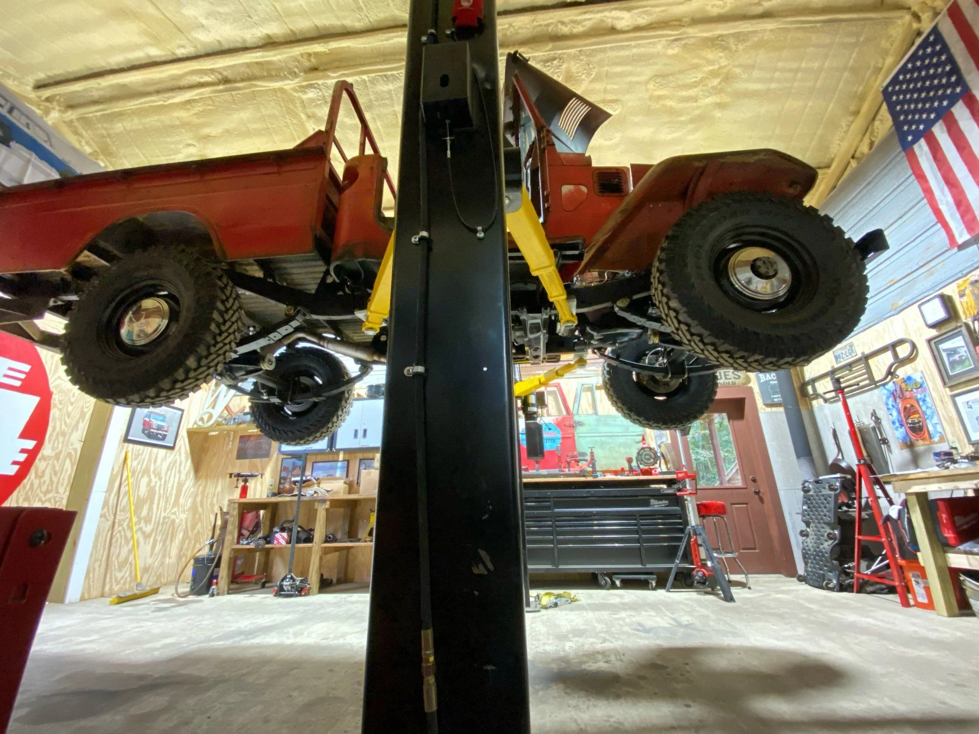

I spent about 4 hours under the Goat today buttoning up everything I can while it is in the rack shop. I need to clear this thing out so I can put my fuel tank back into my 80.
Checklist items done today
✔️exhaust welded in

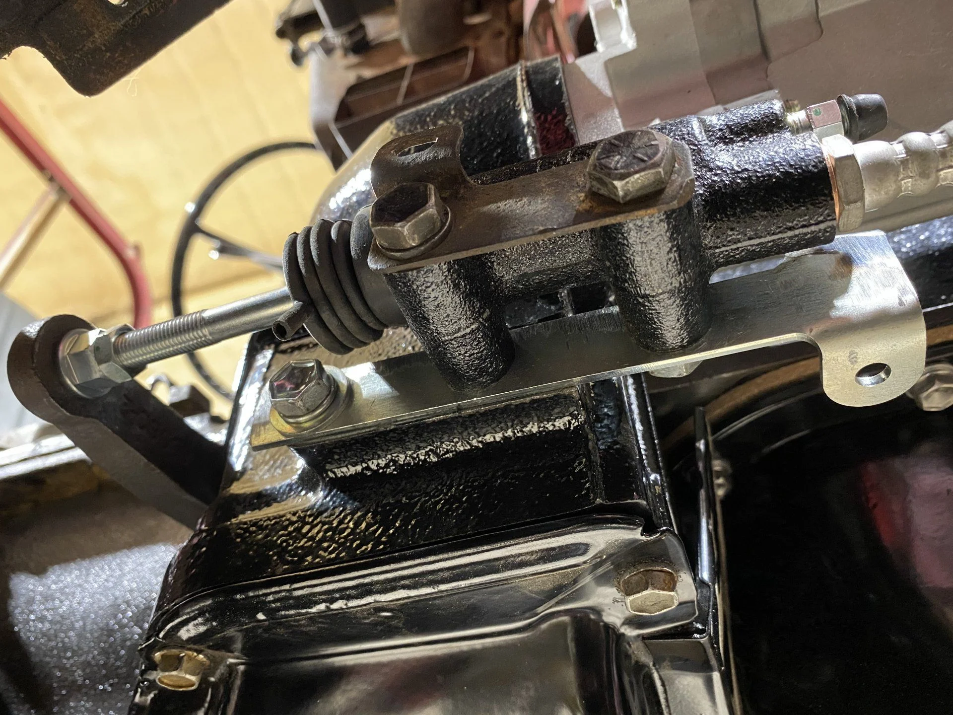

✔️Clutch slave bracket made and installed
✔️Made a tab to hold the speedometer into the case. What a pain in the ass that was.
✔️installed the front driveshaft.
✔️bolted the gas tank in

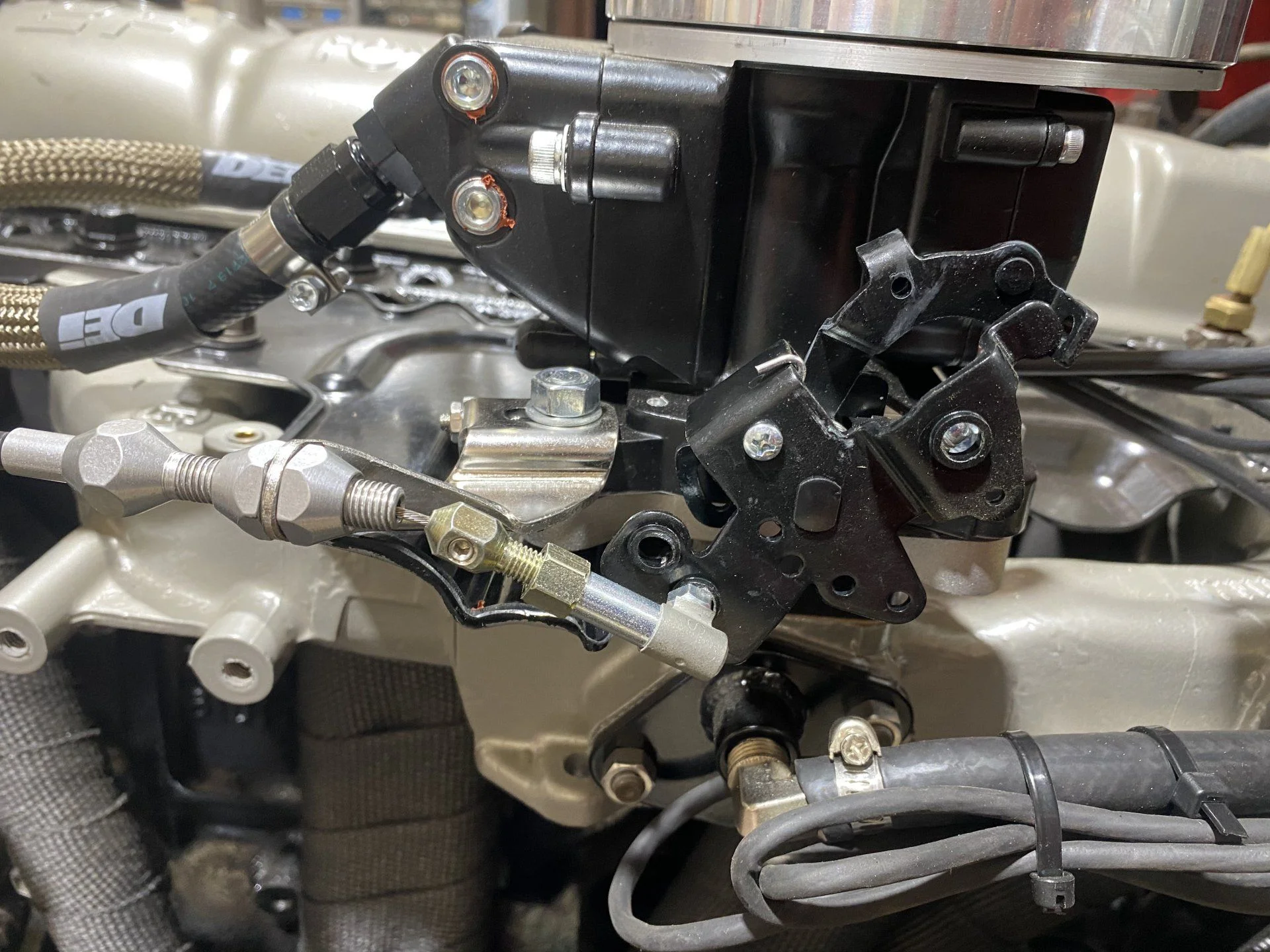

Back on the Sniper
Sniper Throttle Cable installation
This is a bit bigger job on an early truck (as is all of it)

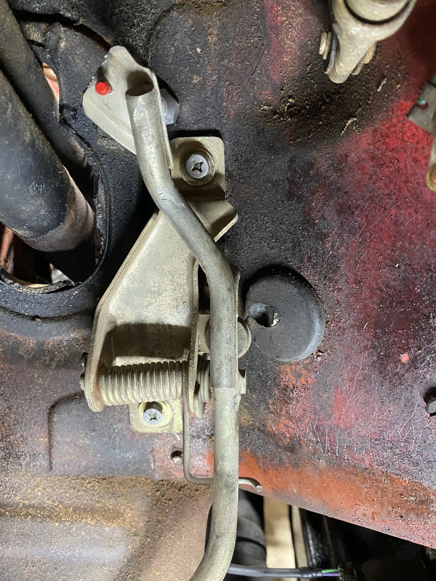

The old pedal setup has the goofy linkage with very little “throw” and the arm for the linkage is a bit too far toward the motor to get a good angle.
I dug through the pedal pile and found this really nice setup I’m not sure I’ve ever seen before. It has the arm that goes through the firewall for 2F linkage (orange boot) but it also has the second arm with a flat plate.
Similar to a 60 pedal but it does not have to place for the plastic hand throttle tab.
Step 1
Cut off the arm that goes through the firewall.
Next, trim up the flat plate on second arm to work with your truck

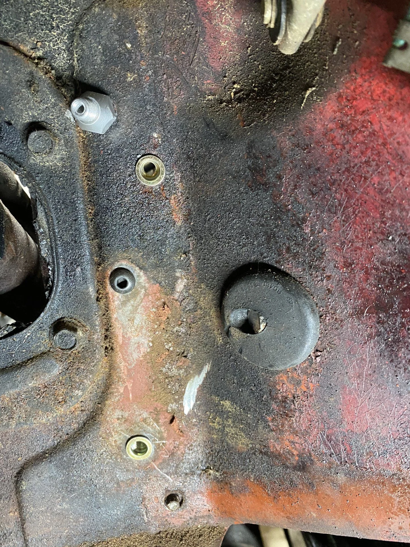

Since I’ll be taking this in and out again a few times to do the power steering and mount the tranny hump I added M6 rivnuts
Then I drilled a hole just small enough to get the Lokar cable through the flat spot (red dot)

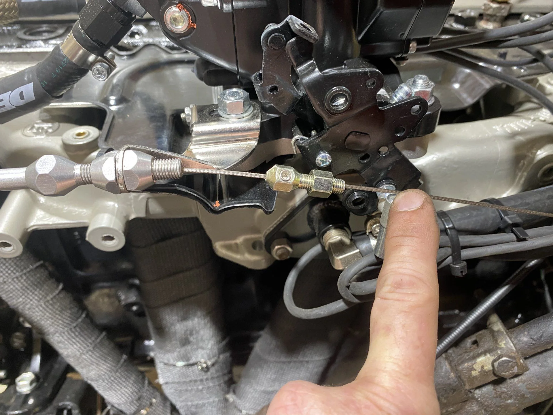

A couple of tips here. Make sure the cable stays far away from exhaust heat. It will kill a lokar in a second.
Also, measure up the length of your cable and run the cable lock onto the cable before you ever tighten the Allen nut or cutting the cable. You will likely never get it threaded back in there once you cut the cable.
Hook it all up. Bend the Lokar cable bracket like you like and tighten it all up once you make sure you are getting 85-100% throttle
@FJ60Cam at Mosley Motors provides the cable and bracket with his kit

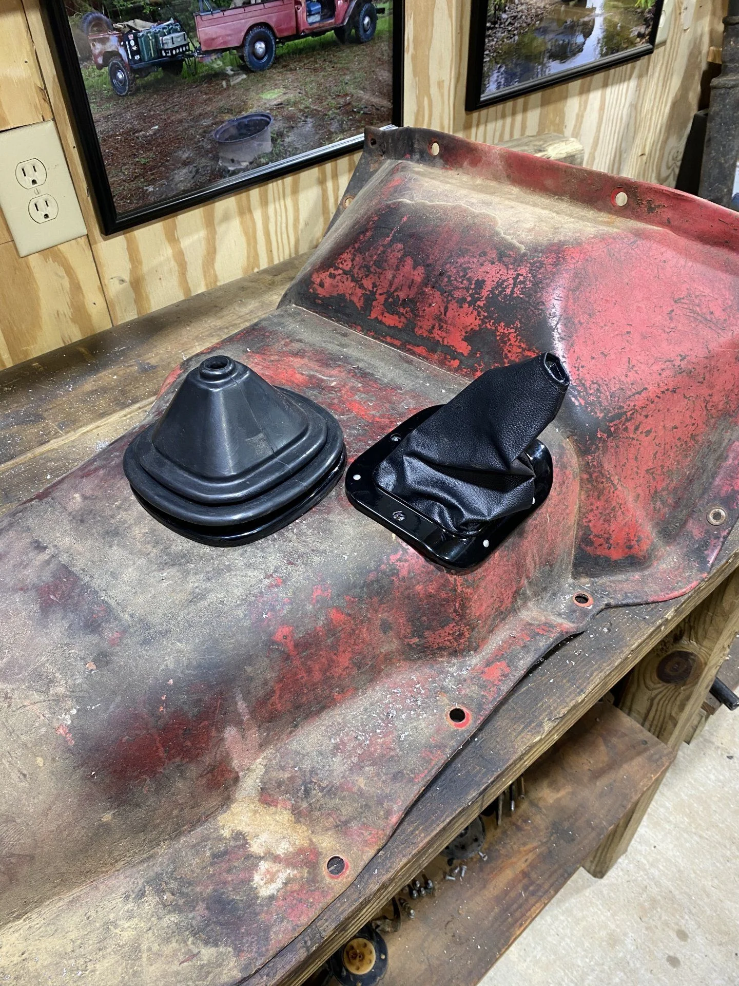

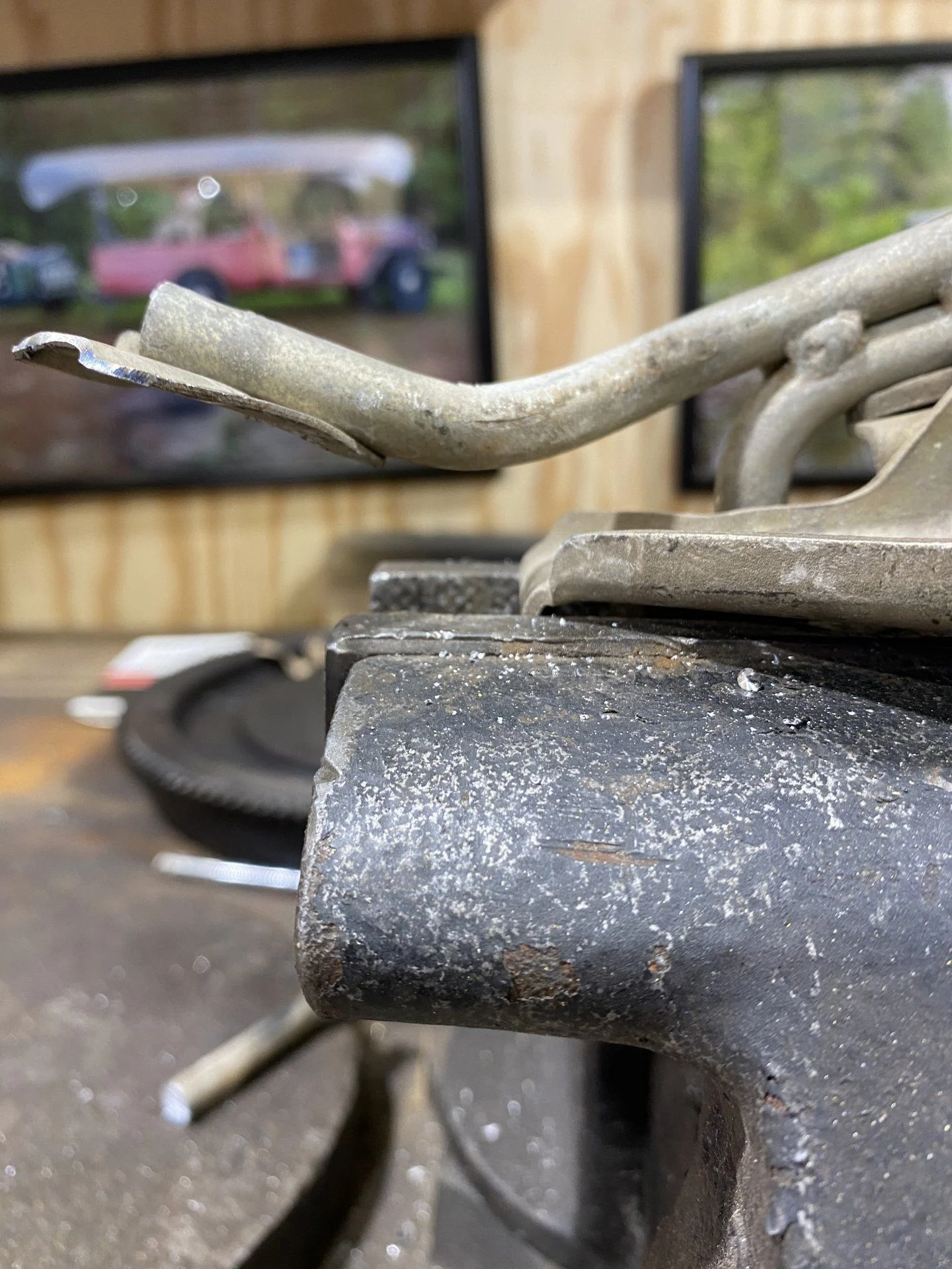

Went to get the transmission hump in and install the shifters and I have the wrong damn Tcase shifter. So much different stuff on these 85 and up trucks.
Luckily Classic Cruisers had ONE setup and it was expensive but at least I found one.

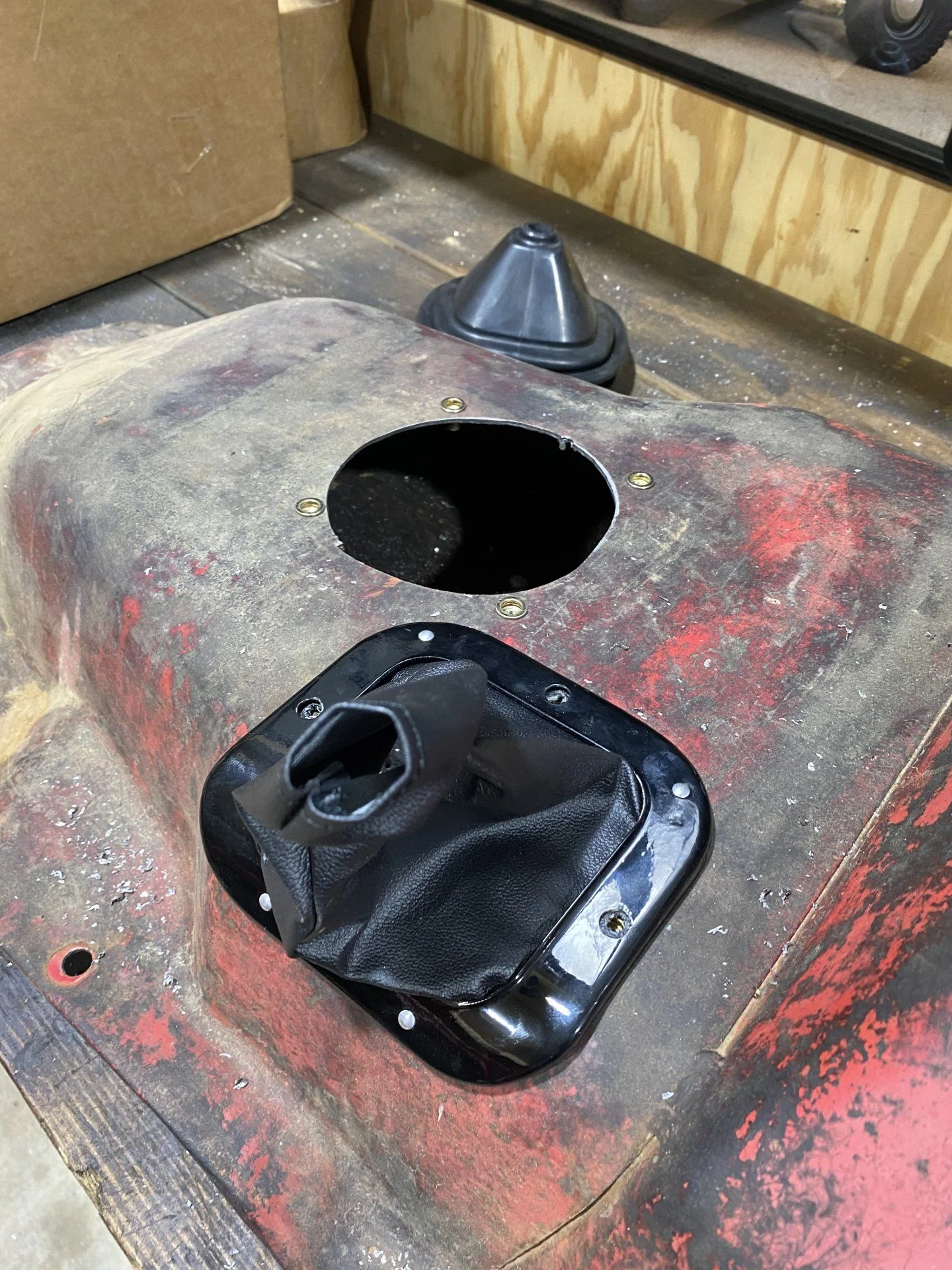

I got all the holes cut and rivnuts installed. Forgot the damn fuel tank has to be out to install the hump so now I have to uninstall that
