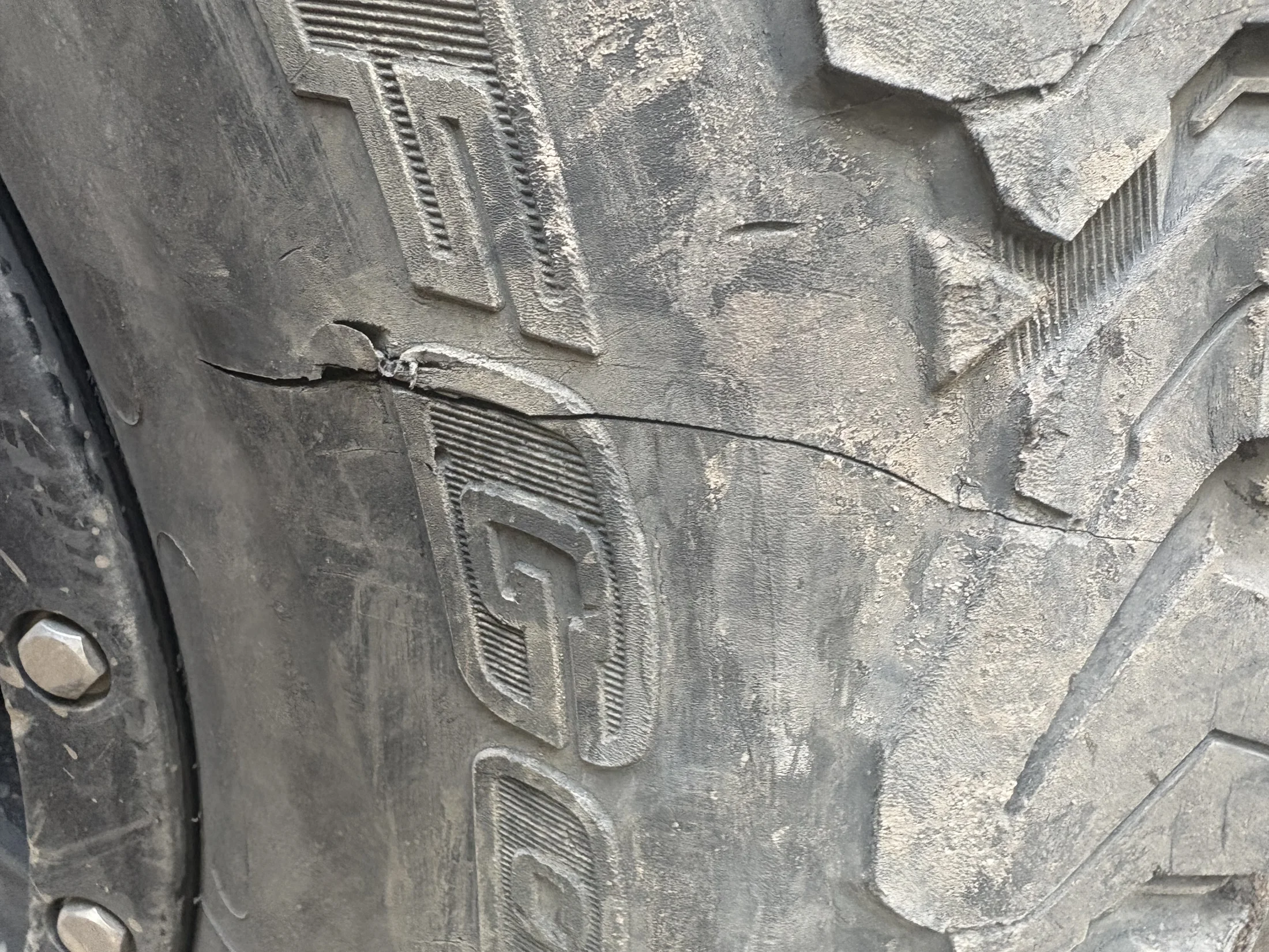

Also, I did sustain a sidewall slash at COTR that didn’t cut all the way through and I just ran with it including the the 14 hours home. I’ve been told, and believe, that as long as you can’t see any of the steel belts or cords the tire is safe to run. When I got home, I just didn’t like the slash, especially when it was at 6 o’clock next to the ground, so I took it to Discount tire. They told me the tire was still safe to run but they were also willing to replace it with my road hazard coverage. I still had to pay for the mount and balance.
Here is what it looked like:
Not sure how well the Gluetread patches would work with a cut through the raised lettering on the tire. Maybe you’d have to take a sanding disk to it to smooth it out before you applied the patch.
Fortunately have never had to use it, but I keep a gluetread kit in my rig (as well as plugs and extra valve stems). I wouldn't hesitate to use it on a gash like that if it were leaking.
