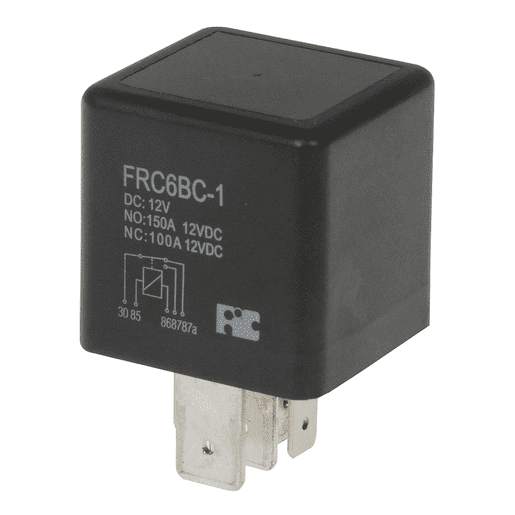

Any high current relay will work.. my local electronics place sells a 150A relay for around $US10.. I'm sure you can find something similar.. this will be more than adequate, you'll just have to reterminate your factory loom with the right spade connections..
Automotive Relay 150A SPDT | Jaycar Electronics

You could consider an ATV sized winch controller.. it provides two switching circuits but you'd only be using one.. often rated up to 500A.. Unsure on the IP rating.. but certainly more than the relay I linked above..
