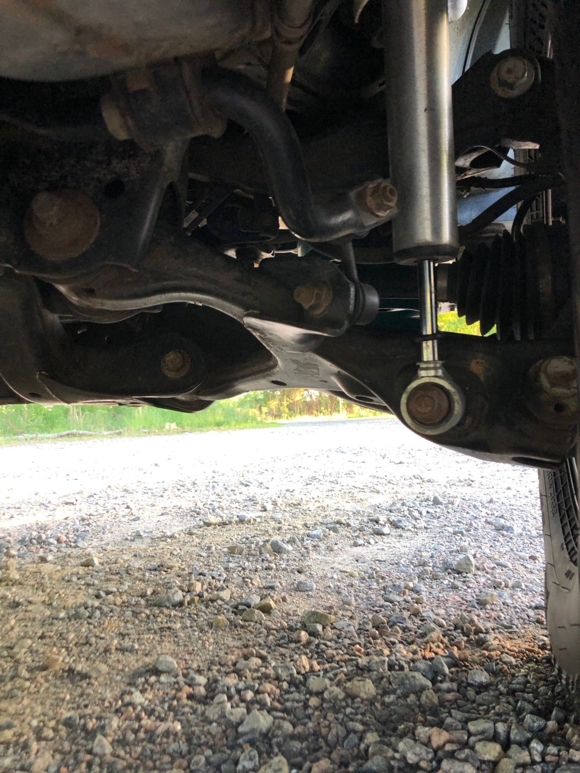

his rear coils pic concerns me, though he does have a heavy rear bumper, but also with additional spacers... idk

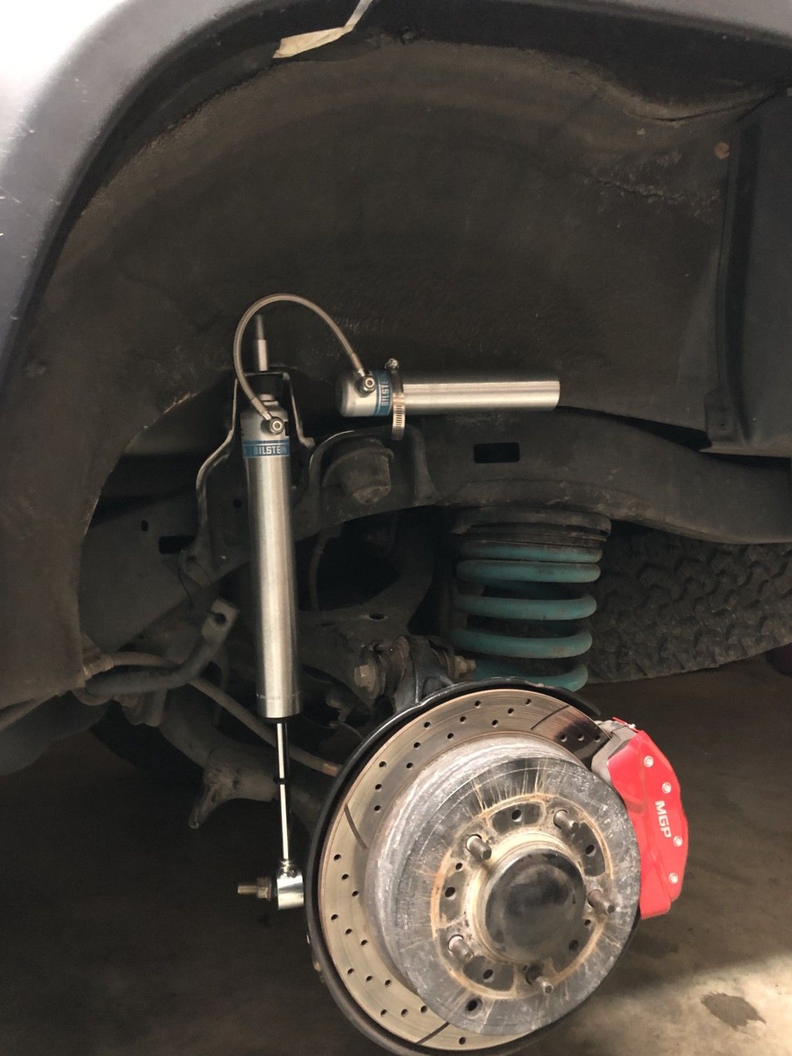

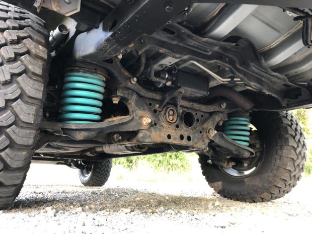

here's mine for comparison:
Thanks for posting JB, can you share more info on your shock set up? What Spring? Do you run a rear sway bar?
these are the rear springs:
Dobinsons C59-719V Rear Spring 2.5" 2008-2019 Sequoia
i am running F/R sway bars still
the rear shocks are these:
PR2506-SS-A King 2.5 Smoothie Shock, Compression Adjuster, Remote Reservoir, 6″ Travel
To make it work with the 2nd gen Sequoia, ORW also had to order the following from King:
25005-040 2.5PR Rod End
RK1091-311 Rod End Spacers
B1010 Spherical Bearing 1”
CR2501 (x2) Retaining Ring, INT, 1
This is all directly from the ORW invoice.
Here is the Specs of the shock though:
· Product Brand: King
· Product Body Diameter: 2.5
· Product Piston Rod Diameter: 7/8"
· Product Series: Performance Race
· Product Travel: 6"
· Product Adjuster: Compression Adjuster
· Product Disk Swapping: Yes
· Product Collapsed Length: 14.0"
· Product Extended Length: 20.0"
· Product Mounting Size: 1/2 x 1.50
· Product Bearing Size: COM-10T
· Product Piston Rod Material: 1040-1060 High Carbon Steel
· Product Wiper Material: Urethane
· Product Main Seal Material: Buna
· Product Piston: 6061-T6
· Product Finish: Cadnium
The second gen I'm considering building is a factory rear air suspension. I'm considering converting it to coils. From looking at the parts diagrams, the upper mount (attached to frame) has the same part number as coil springs. The lower control arms differ. I may order some rear coils to see if I can get it to work without having to buy new control arms.
Has anyone attempted this?
