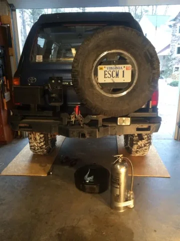

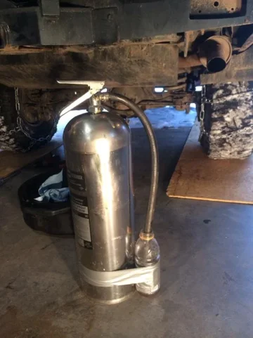

Used my gear oil dispenser today and thought I would share one of my favorite cheap tools. I bought the used fire extinguisher locally for $15. Filled it up with gear oil, pressurized it, and a few years ago ended up taping a Gatorade bottle on the side to collect the hose dribble. In the winter, you need to being it in somewhere warm before you use it the next day as it sucks when it is cold. image-2829424885.webp image-2068660919.webp

yep, pressurize with shop air....fill up to the gauge on the tank in the green zone. As mentioned in the first post, make sure you take it into the house the night before if your garage isn't heated in the winter as the gear oil gets stiff.
I filled the front diff on the 80 with no pumping and within about 30 seconds...
it is the way to go...
a shorter tank would fit under the truck better, but one of my trucks has 35s and the big tank stands upright. 315s on an 80 require you to tilt the tank slightly...
