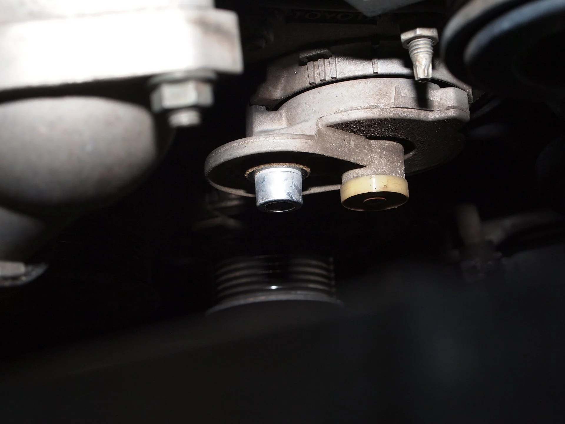

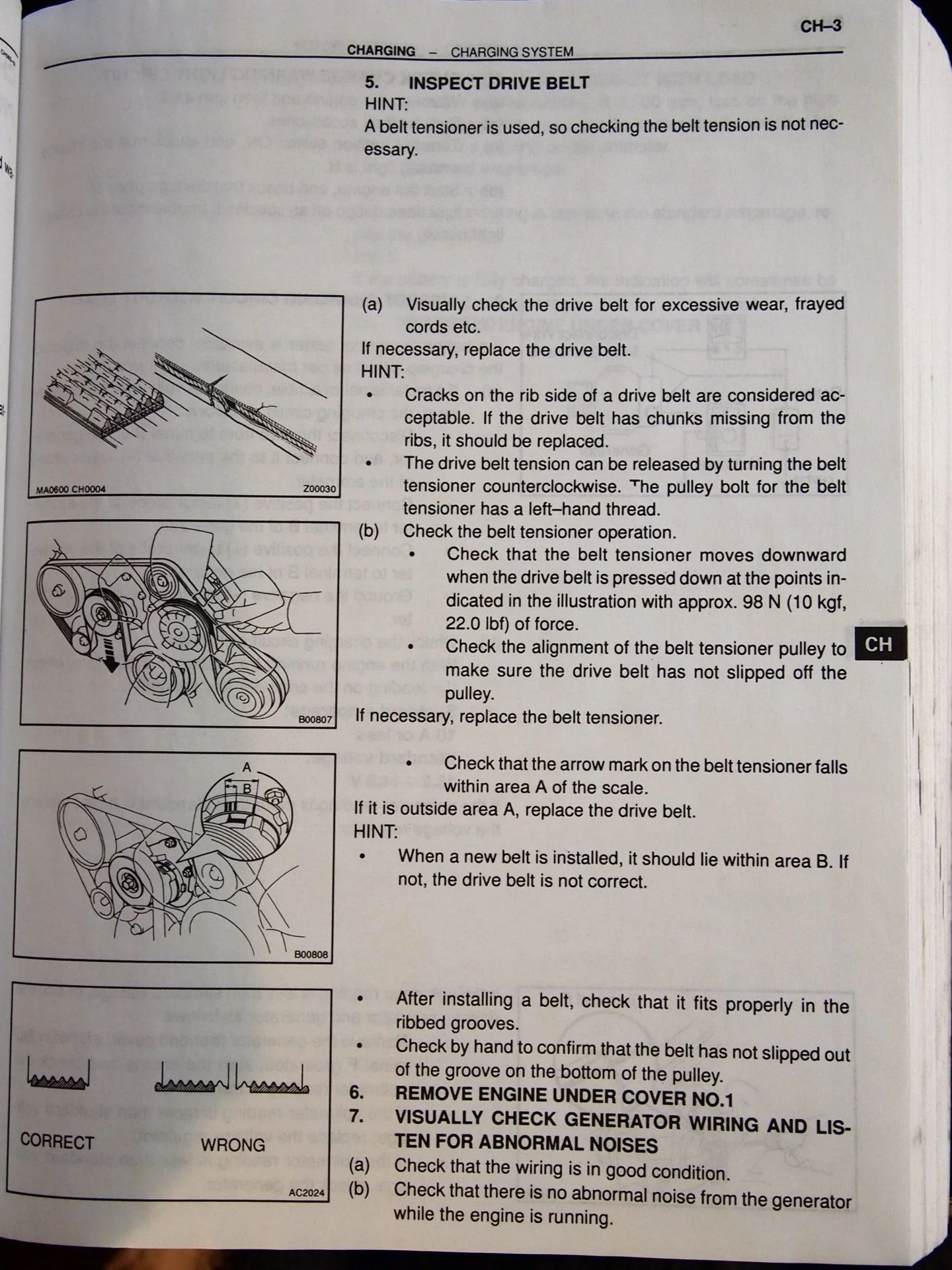

Thicker would change indicator starting point. Did yo happen to look at your starting point new and now at __ miles (run time)?
01 LX470 day 4 oil fliter, tensioner pulley bearning, after cleaning 001 (54).webp
Looked last night, tensioner is smack in the middle of the "B" Zone. A+ Belt would belt again.
