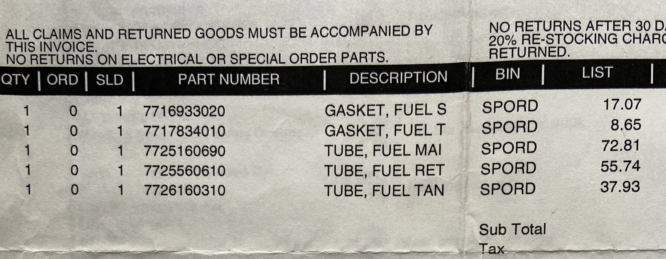

I’m waking out the door for work right now, but I can shoot you a pic of my invoice from the dealer with the part numbers.

Part numbers and what I paid back in ‘21. To clarify, these part numbers are for an 06/2000 production date Land Cruiser. The may change depending on year and/or LX.
Can anyone validate below part numbers
Gas tank 77100-60042
Fuel pump 23221-31150
Filler tube numbers ? Is it two sections?
