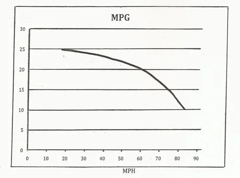

Here is a chart of gas mileage at various speeds with a 2004 UZJ100 with 59,000 miles. The data points were checked twice and are with the speed held steady for at least a minute at 10 mph increments on a level highway. I drew a curve between the points. The conditions:
60 degrees
No wind
A/C off
Windows closed
Tire pressure 30F 32R
Roof bars at rear
All vehicle service up to date
Mobil 1 5-30W oil
Michelin LTX AT2 tires
Rear seats removed
No extra load in vehicle
2 adults
MPH determined with both speedometer and a Garmin Nuvi 750 GPS
MPG determined with factory navigation system Trip Info continuous readout
I don't think you could get 25 mpg going downhill with a tailwind? Maybe if the 100 was on a trailer?

I couldn't imagine getting 25mpg. Then again 20 mph it should shift into 2nd or 3rd and end up having the RPM's sit near idle. (900-1100 rpms) still unlikley.
Any one with a scangauge, can you give it a shot to get 25mph?

I'm even more surprised to see it drop to 10 at 85 MPH. I usually get about 13-14 MPG at that speed and can get 15 running between 75 and 80 all day long. As for the low speeds, I cannot imagine drag being a problem until 35MPG or so and I'd expect to see a peak in MPG near there.
I have so say that I once got 19 MPG between Victorville and St George though. A wicked tailwind with 60 MPH gusts was greatly appreciated!
