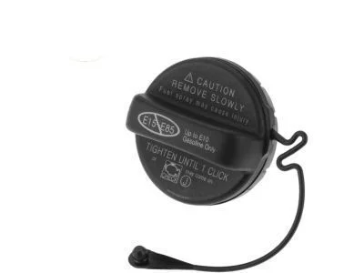

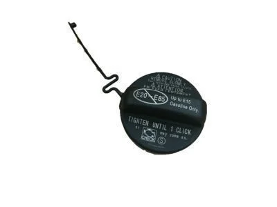

At least one difference is that the one for build after 08/2015 indicates up to E15 gas is OK, while the one for 08-15 indicates up to E10 gas only.
77300-53020:
77300-06040:
