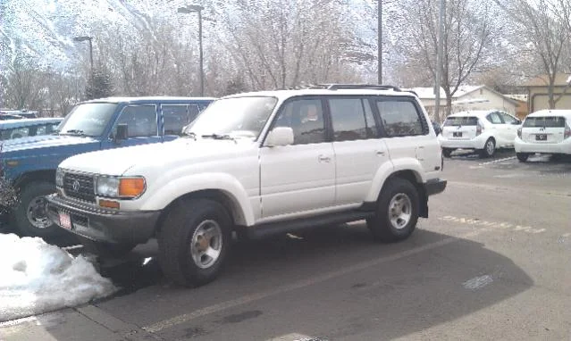

After almost a year of research our SAR has finally purchased a bone stock 80 series and will be building it up to become a hasty team personnel carrier and patient transport vehicle. I'll be posting photos as we progress.....more details to come....

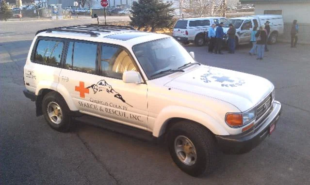

we've had some discussion on who/how we approach vendors/donors for this project. We have decided that the only vendor/donor that will be represented on the vehicle will be Big Horn Toyota. They have been a huge supporter of the team over the past several years (even before we purchased a Toyota), they will be helping out with all of the equipment installation, and the vehicle will be maintained by their staff for the rest of its life with us. We're going to try to have other vendors/donors featured with the vehicle in a photo op and something we can print, frame, and give back to donors as a token of appreciation.
It seemed like an awful big can of worms to open when we have to decide how big will a donors decal be based on money contributed, where will it be featured, why did company X get space right on the front quarter panel and we (company y) are behind the spare tire? Are their potential conflicts of interest...since we're a non-profit organization do we want to possibly give the impression that we're now owned by ----- company becuase we have their name plastered on our vehicle. Perhaps we're being too paraniod or over thinking this...thats the beauty of a board of 10 different people with 10 different opinions...:rolleyes:
At the end of the day it was just easier all the way around to keep it simple and not put anyone's logo on the vehicle (aside from Big Horn for the aforementioned reasons)

So the decals are on. Next week I'm going to pull her into my garage and run through plugs, wires, filters, installing PFRAN LED lights all the way around...the following week I'm headed to Golden to pick up a truck load (literally) of goodies from Slee to bring back. Big Horn will be installing the lift, rear bumper, belly plate, and also handling a new P/S pump.
Pretty stoked for this build and to get her on the trail to test her out. We always get folks stuck up in the high country unprepared during the shoulder seasons...and spring is right around the corner.
I'm completely convinced that this vehicle will be a very valuable resource to our team in the years to come!!!
