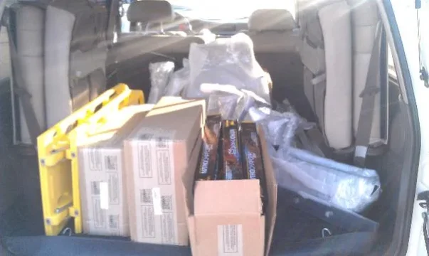

A pair of Optimas are enroute. Isolator on order, still working on picking out the winch.
