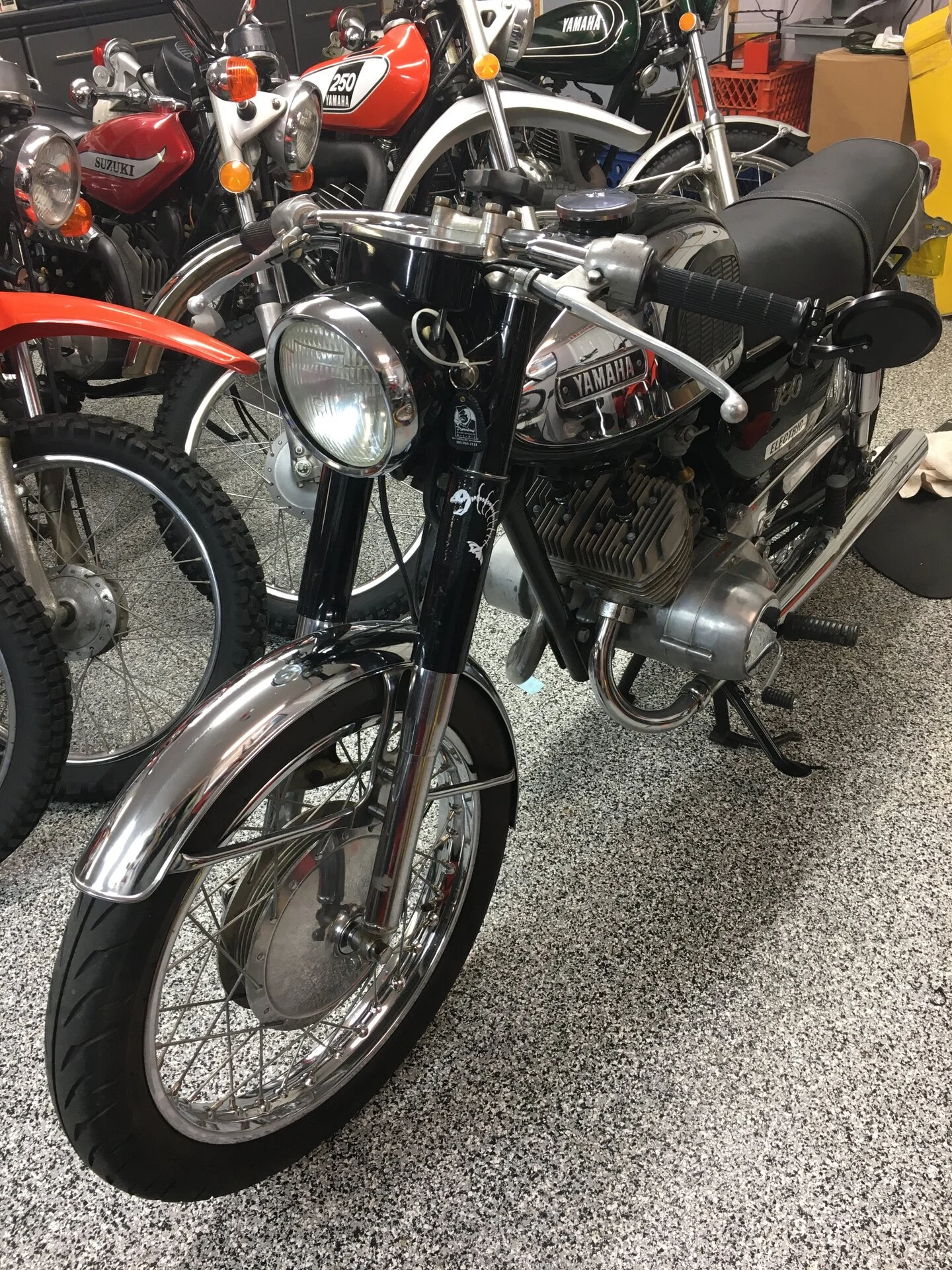

Richard, did you do your floor yet? Mine is "quartz" polyaspartic coating, I installed it when I bought a house in Feb. I love it. It was like 80 grit sandpaper at first but eventually the chips lay down/wear down a bit. I would agree though, with the pattern, any small dropped parts are a bit tough to find but clean up is a breeze. Oil, paint, stain whatever. It is now full of cabinets, the 80, my old Dodge truck and two motorcycles and you can hardly see the floor :D
