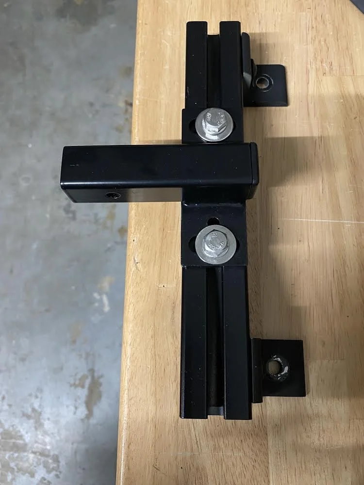

I realize this is an old thread, but I have these mounts and used some 80/20 extrusion and brackets I had laying around. Short pieces of 80/20 across the FR crossbars with the awning mounts bolted to the 80/20. This raised the mounts up to clear the FR side rails. Another option would be to bolt the awning mounts to the FR side rails, but I didn't feel this would be strong enough. If you'd like some pics, I'll snap them when I have a minute.

This is the only picture I have, sorry. 80/20 is like an industrial erector set…your imagination is the limit. I used the 1515 series which is 1.5” X 1.5” as that’s what I had laying around. It was also a perfect match for the dimensions of the receivers.
