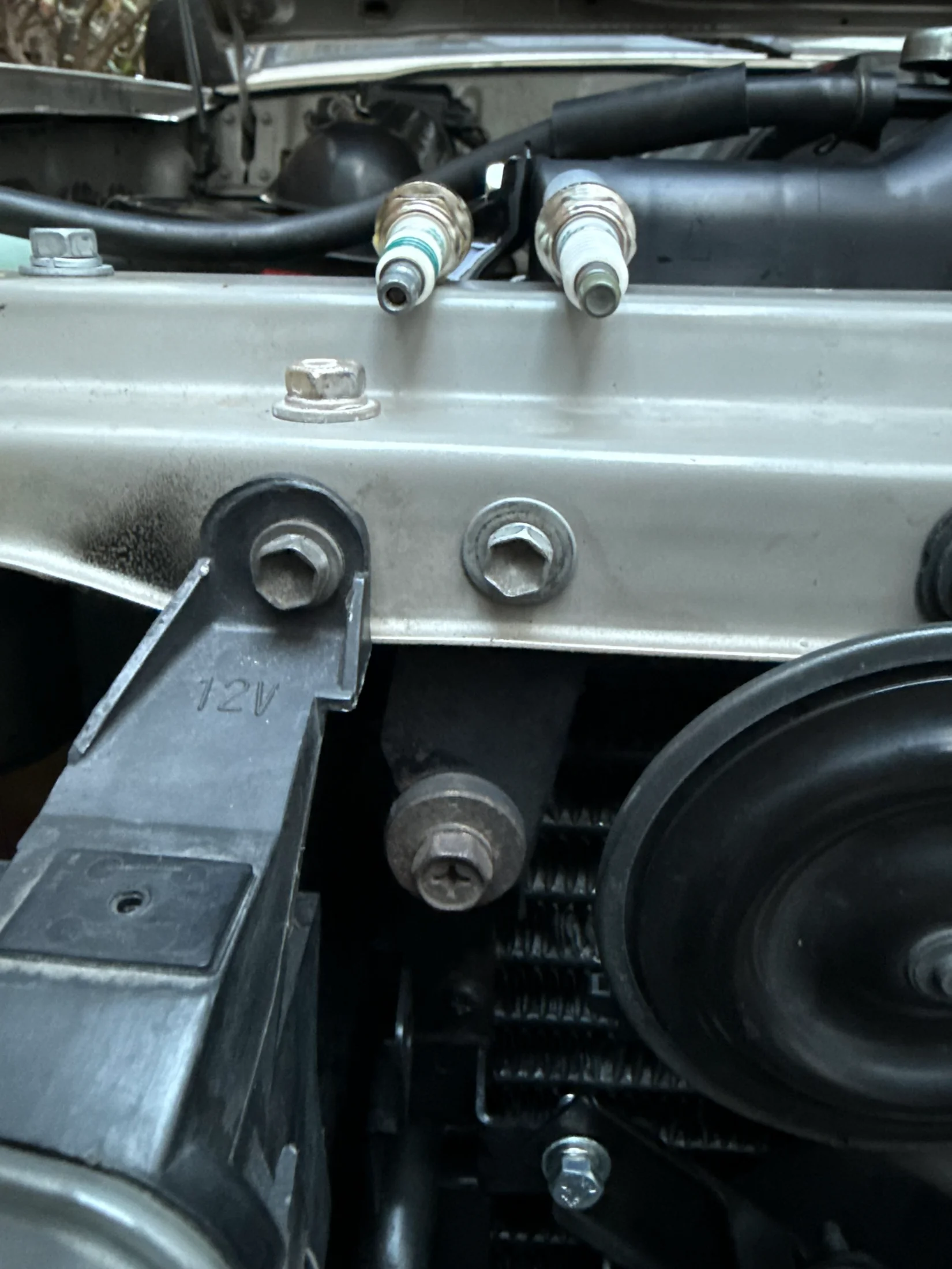

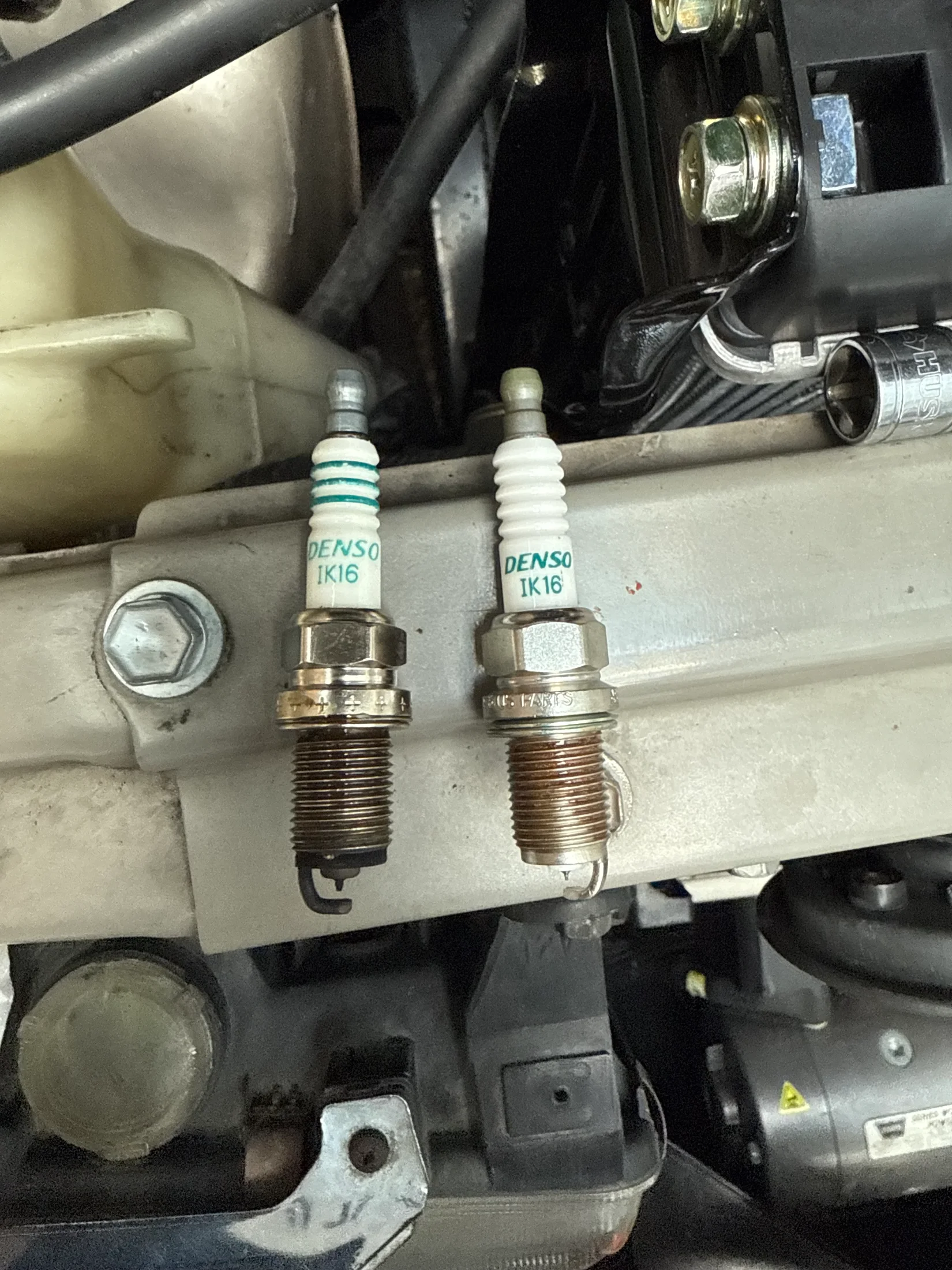

Found the issue. Counterfeit spark plugs. Thanks Amazon... I attached pictures the one on the right is from Oreilly, the left is the amazon purchase made from pure Chinesium, it also has more blue racing stripes.
