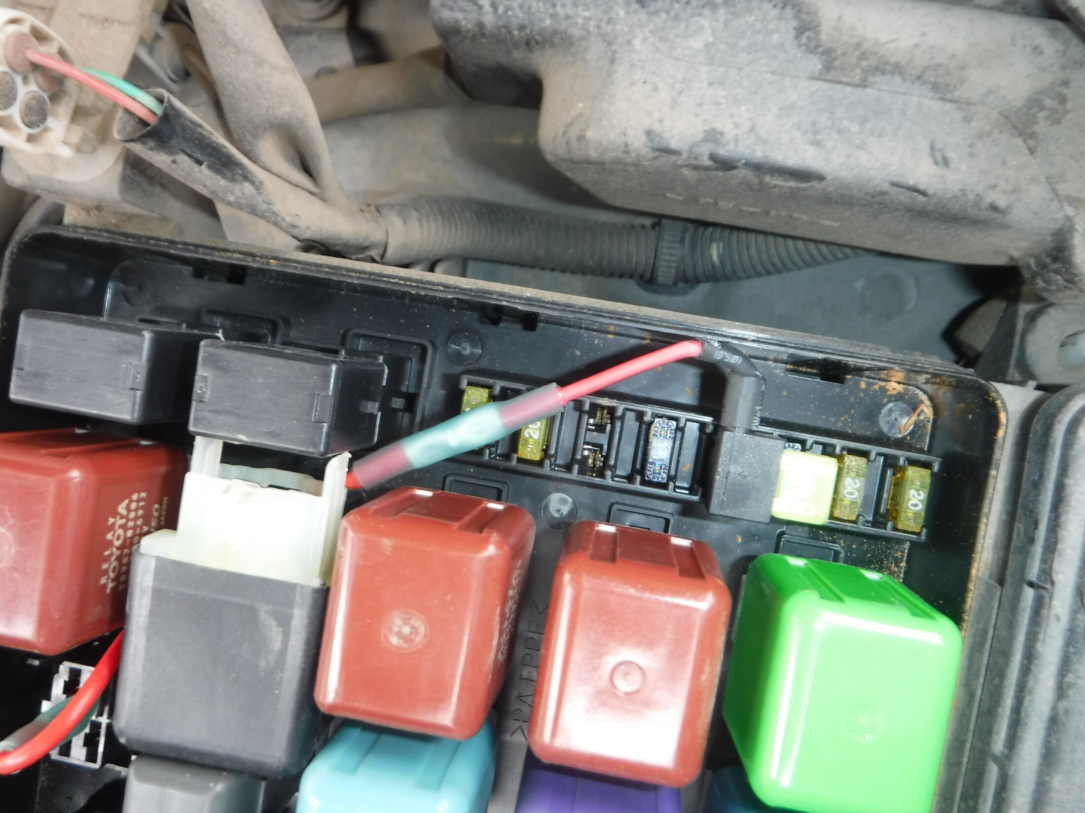

wife's daily driver quit, crank no start, during troubleshooting, found EFI relay had keyed latching power but no in and out power.
fuses all good. after pulling fuse and swapping, I got power in.
is this the issue other have with the fuse box?
@medtro fix to solve this?
is it the wire out from the fuse to the relay causing issue? as I had power thru the fuse
2000 LC 208,000 miles
to finish this thread
I ended up using 1 of the 2 unused fuse locations in the fuse block
using a fuse tap, making sure I had the hot side of the fuse holder and only used the tap portion of the fuse tap
I did not install the other fuse as that circuit was not used before
it's been running this way for the last month, so far so good
