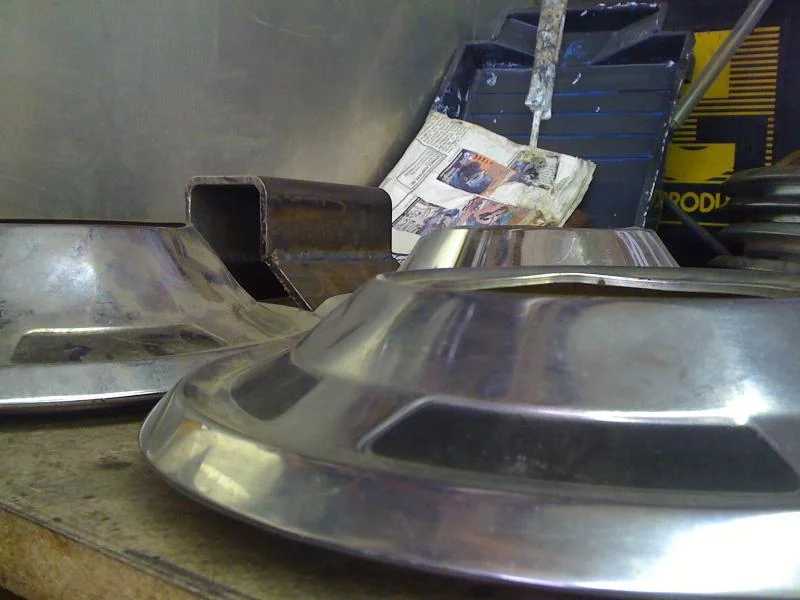

peteinjp, here is something concrete that might help you. the early (acorn style) hubcap has a depth of 2 3/8" conservatively, measuring from the edge of a 2 1/8" radius drawn on the inside of the hubcap (loosely representing a 4 1/4" FF hub diameter).
just for the record, the later style caps probably have at least a 2" additional cavity. I don't see why they would not work with any of the variations of FF axles. I have personally seen later style caps on FF axled rigs. maybe someone could post up the depth of the later caps.
your variables may be style of FF (disc or drum, late or early) and 15" or 16" rims.
I wouldn't buy the caps until I had the axle and rims in hand, unless like you stated, you'd be using them on something else in the event they didn't fit the FF

here are a couple of shots of "new" style fronts in different heights and styles.
