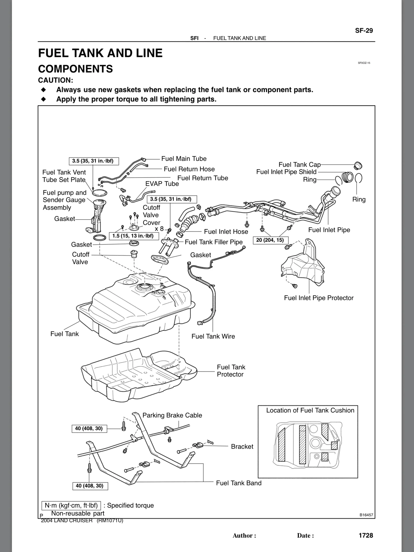

I need to replace my fuel tank soon and I have had no luck finding anything on the forum. I'm not sure if I'm looking in the wrong places but any insight would help. If there is not anything out there then I will be doing a write up on it to help future members. The image above is all I really have for info. And also a couple part numbers from Toyota parts website wich I will post later.
