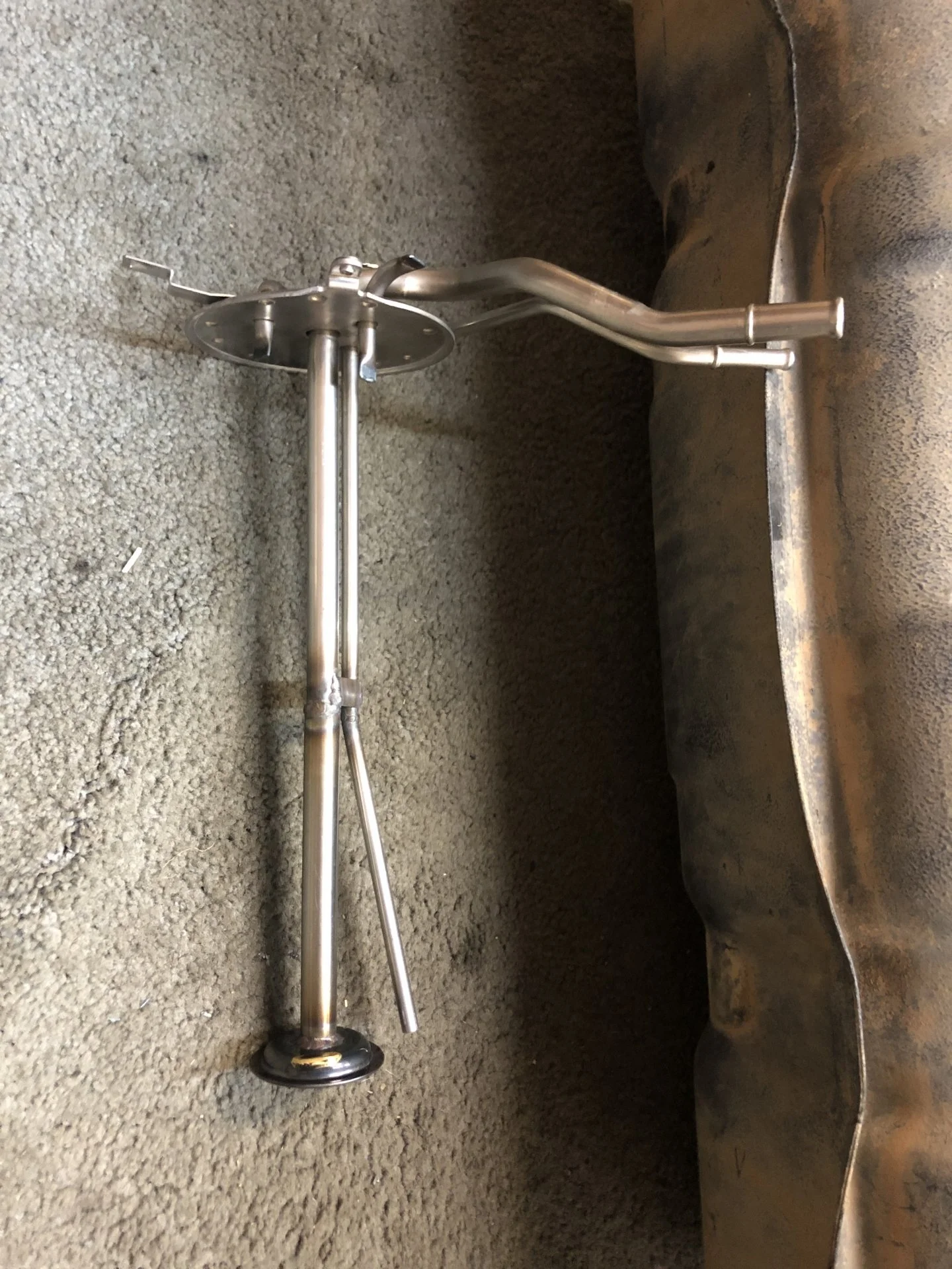

Hi all,
Just in the final stages of fitting a Prado sub tank to an 80 series landcruiser (diesel). I have modified the fuel pickup which involved chemically cleaning and welding. Now it was originally zinc coated (the inside and outside part)...
now I can send the part off to get coated in zinc again, but I could Powdercoat just the outside facing part myself which is easier and cheaper. However that means the inside section would remain bare metal... now I figure it’ll be covered in diesel so shouldn’t need any sort of coating, but after some second opinions.

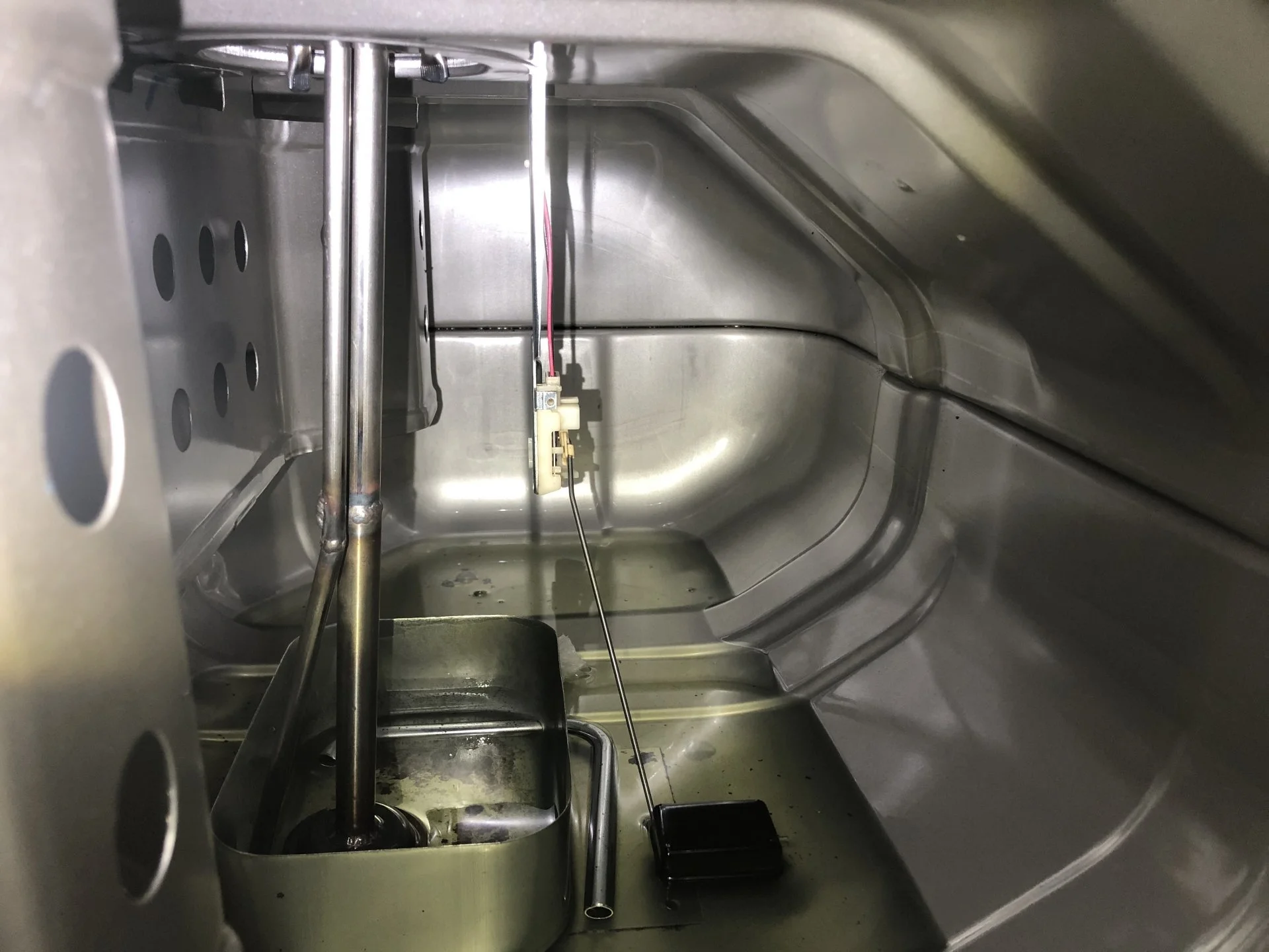

Do Toyota put any coating on the inside of their fuel tanks? This tank looks so pristine it appears to be some sort of paint?
Cheers
