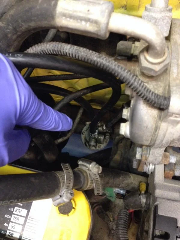

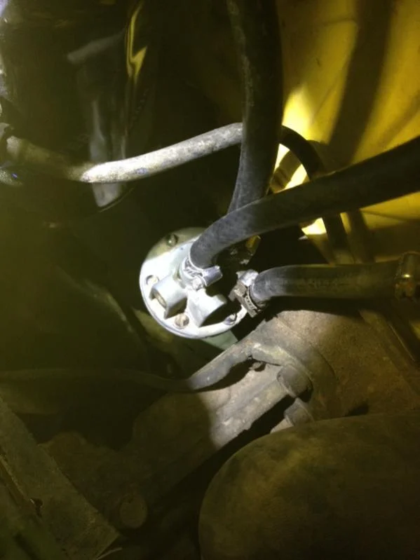

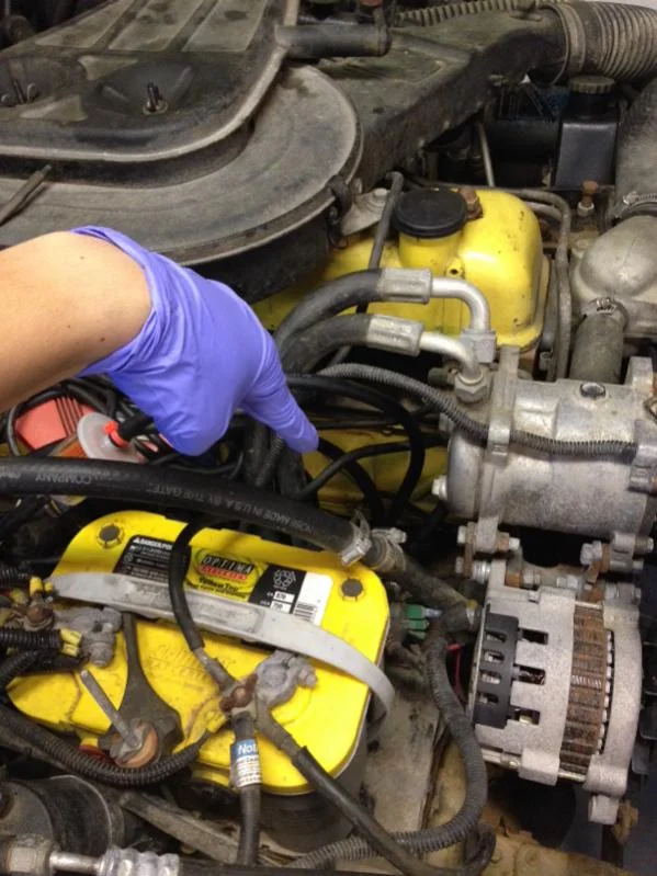

Vehicle (1978 fj40) was having trouble keeping an idle. I notice some gas leak at the end of the fuel pump (I'm assuming its a mechanical fuel pump?) on one of the connections. (The hose closest to the motor)
I drained the gas tank, then replaced the fuel lines with new ones and also replaced the fuel filter which the PO added.
I reused the clamp fittings to secure the hose. once everything was back on. She fired right up with a little sputter and idle'd like she did before. However I still observed some fuel leaking by the hose closest to the motor.
I checked on SOR's website and their fuel pump does not look mine. Was wondering if anyone could tell me if this is an aftermarket or stock??
I want to be sure before I purchase a new one or if mine is even rebuildable.
That's an older design. You can find the newer ones at RockAuto.com or your local parts houses (Napa, AZ, Oreilly).
Newer:
Older:
Thanks for the info. I found out mine was an Airtex fuel pump. The pump fitting is loose on one of them and there are no threads on it. Will pick up a new one. Thanks again
Try to get a Kyosan one. The Airtex is cheap Chinese stuff.
While I agree with the opinion, the Airtex mechanical pumps were built in Illinois (they don't make them anymore). The newer electric ones are made in Mexico ...
FWIW - if you order a Napa mechanical pump it will be a stock Kyosan in a blue box for cheaper than Mr T ;-)
Tucker
don't get the top pump like the david posted. that pump is for the later model cruiser (2 lines in and 1 line out) (think it was '77-'87). they have a return line going back to the tank. get the pump that looks like the bottom pic he posted. 1 line in from tank 1 line out to carb (1 in and 1 out). you can still get it from toyota.
You can use the pump in the top pic but be sure to install the spacer between the pump & block.. with out it will result in a small disaster...
