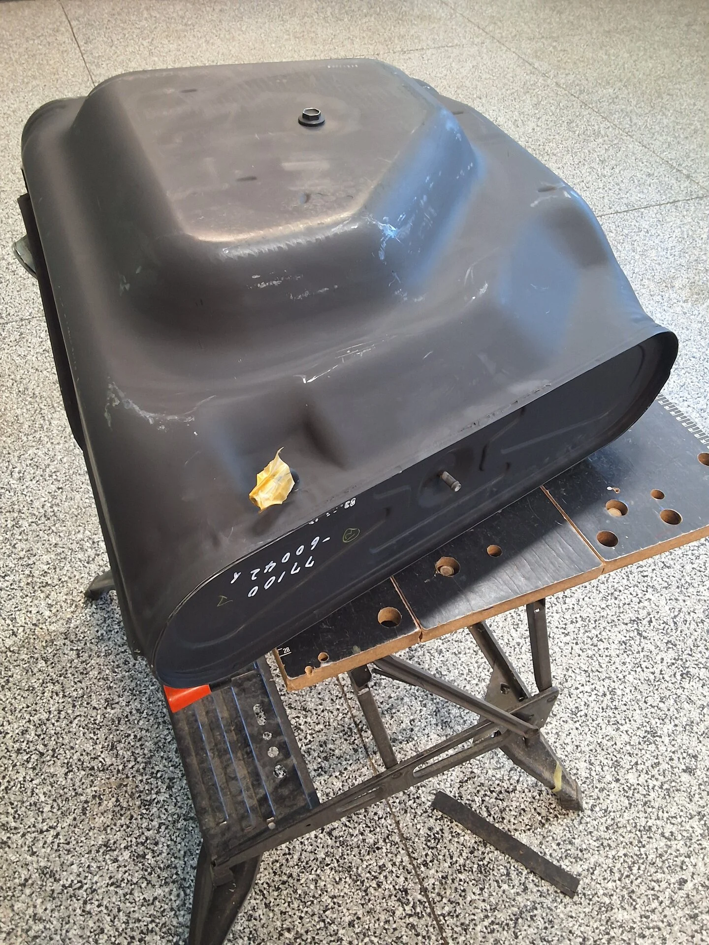

My 1972 FJ40 tank rusted out. I got a great deal on a new Toyota fuel tank but for newer models.
To verify my searches, my question is the supply line is now the pipe on the bottom and the return is the side where my original supply was? And the three small lines on top are all emission related and I can cap those?
To verify my searches, my question is the supply line is now the pipe on the bottom and the return is the side where my original supply was? Yes, the supply on the newer tank is the pipe on the bottom. The return (for later models) was rerouted to the side.
And the three small lines on top are all emission related and I can cap those? Yes, but, you may need to locate a venting gas cap to avoid pressure buildup in the tank.
