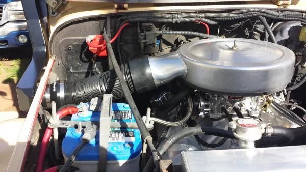

The solution I went with would work for you.
full
It's a Spectre 98625 Air Cleaner with a 4 inch input. It uses the standard 13 inch air filter.

I haven't bought the filter yet but I'm looking at a 5" element with a filter wrap for mine. Snorkels always seemed like a big vacuum cleaner sucking heavier air particulates better because of higher intake velocity. My plan was to use largest element that will fit under the hood to slow down the suction effect and pre-filter out the larger stuff with the mesh wrap.
Here's where I am at this point:

Well some more parts came in so I now have the 14" OD x 5" tall K&N installed.
It comes close but the hood still closes without interference.
@B y r o n looks great! I'm definitely going to have to take a look into it, seems like a cheaper and easier option than a snorkel! I'll probably copy your idea here and do a snorkel when my list starts running down!
I also bought the pre-filter sock which I'll leave in the glovebox for use on the dusty days.
