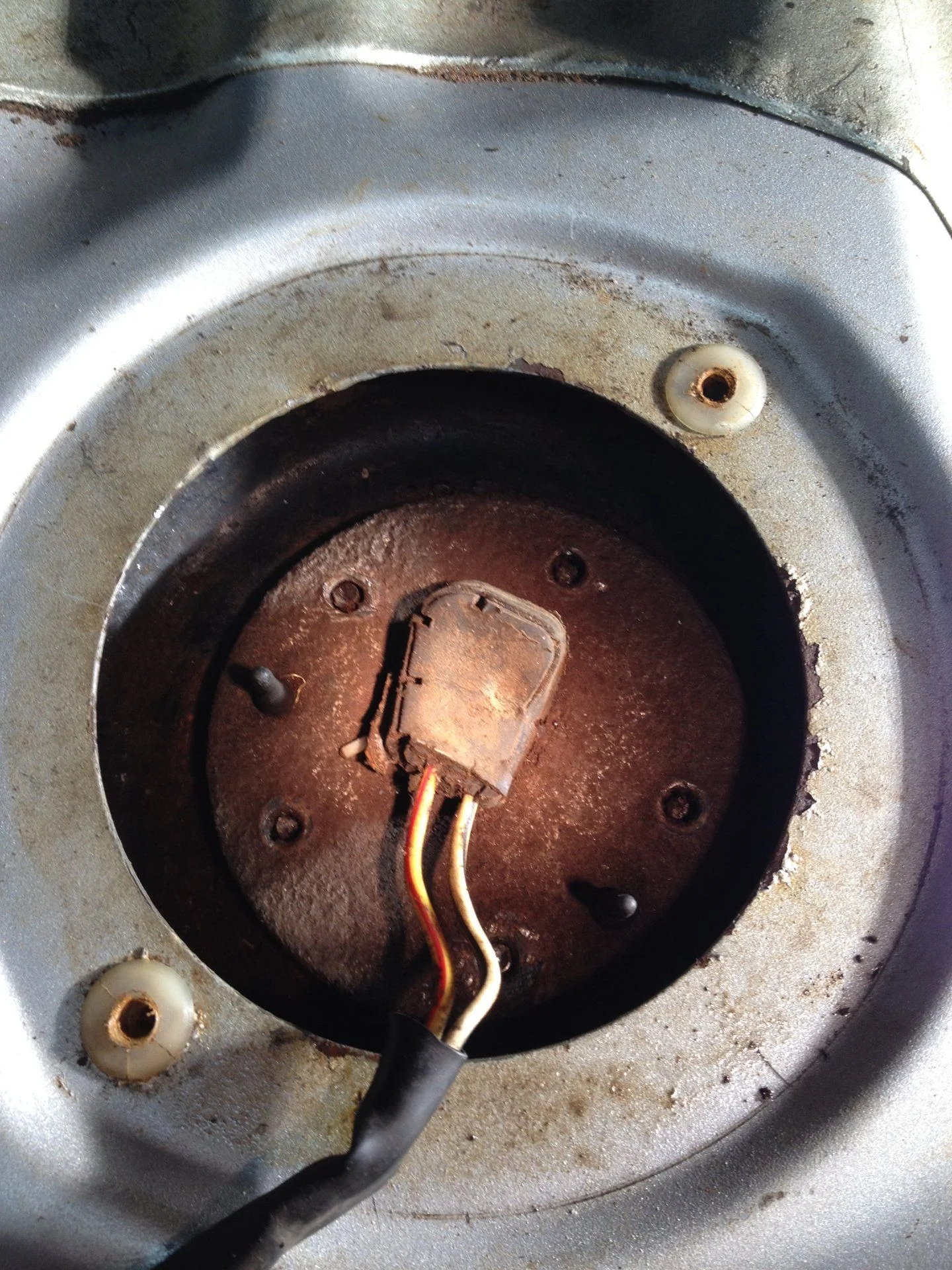

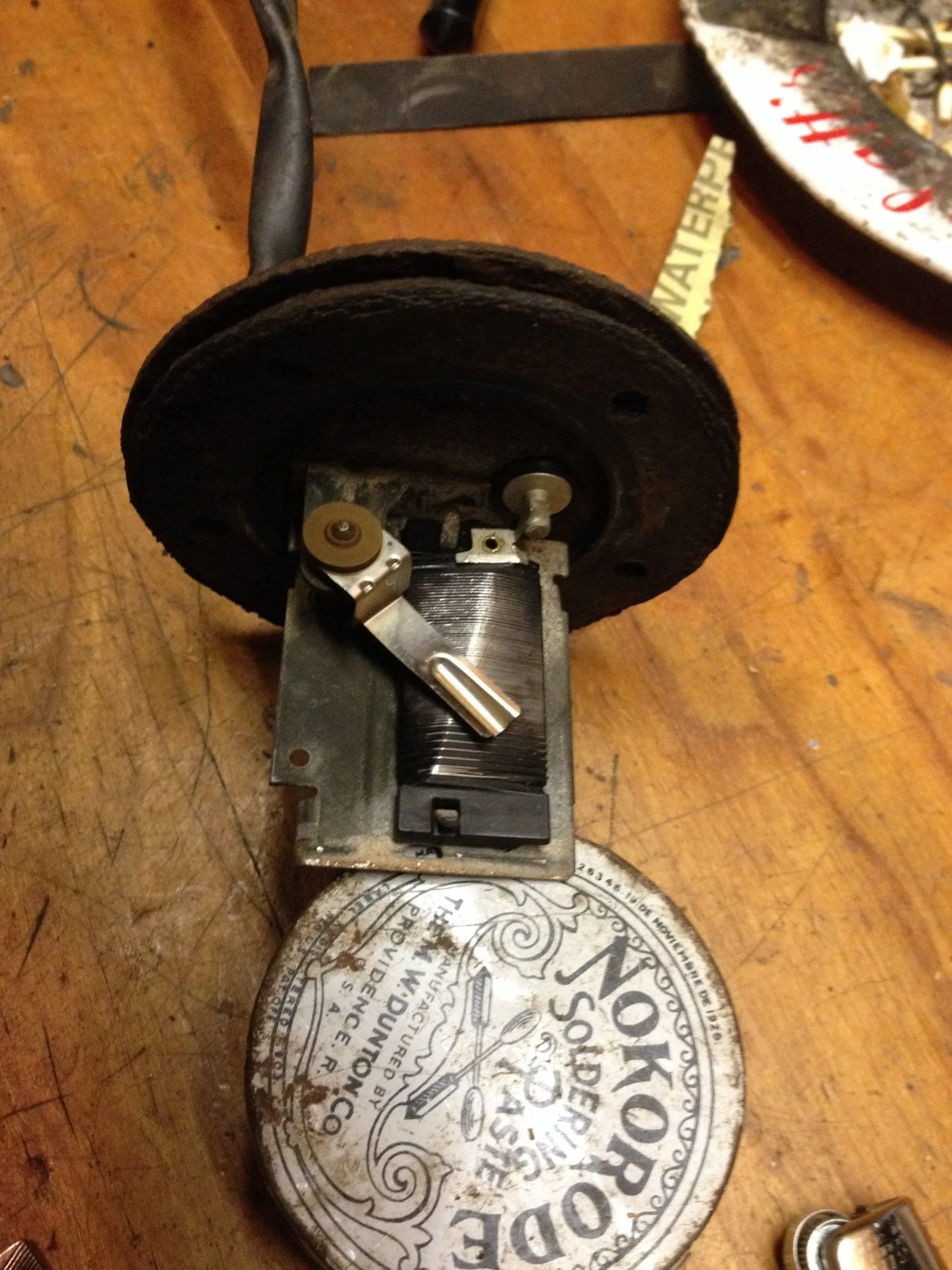

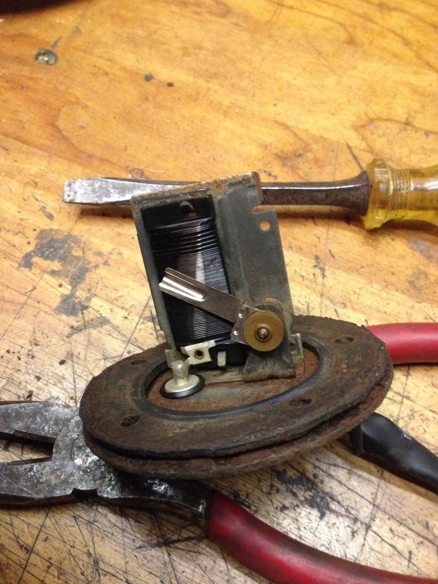

I to have an untrustworthy fuel gauge. It's 86bj70. 24v. Won't read full unless I jump the whole pump with a by pass wire. I cleaned the resistance coil and contact as my ohm meter showed no circuit as contact passed about 3/4 of movement up the coil. After dressing coil Ohm mtr shows consistent gain from top to bottom but no improvement in performance of gauge. Got a customer service #to share? I'm done trying to fix this one.
When you change gauges/senders the ohms values must match, i.e. 240/33 gauge and 240/33 sender. When you modify the non-Toyota sender to fit your Toyota tank, there are very high odds you will throw sender accuracy out the window- - -for that reason I would recommend you get a 240/33 Centroid electronic sending unit for your non-Toyota 240/33 dash gauge.
