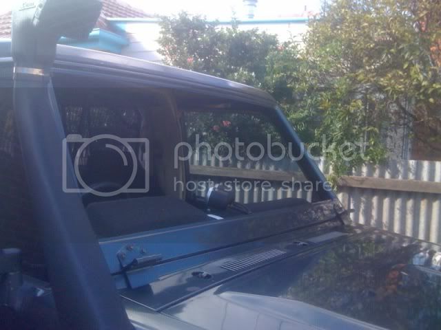

Well I finally got my frp windscreen frame in the cruiser with new windscreen. It's taken ages to get it all done but it was worth the wait. The frame went in with some gentle persuasion and the new windscreen went in no probs. No more rust.
Pic is without the new screen in.
s***ty iPhone pic....

I've just done the same, although I got a Darwin panel beater to do it for me ... $2500 later ... oh well, at least it'll be dry for the next wet season
Hey lowfour is yours a fibreglass frame or steel?
My costs broke down looked like this:
$400 for the frame
$250 for painting
$180 for the new glass
It probably took a day to replace the frame cause I pretty much had to do it twice. I realized after the first install I should of used an adhesive sealant on the bottom seal to keep it all watertight. So i did it agian.
Fibreglass - they told me the surround was $1000, and it was a full day's work to fit it. I think I might have got done, but the leaking was giving me the irrits, so if it's fixed I'm glad. And there were a few bits of metal work needed doing as well.
It sounds legit to me mate. For $1000 yours would be a Toyota factory steel frame. I just got a fiberglass one so it won't rust again and it was cheaper. You should squirt a lanolin based rust inhibitor inside the frame through all the screw and bolt holes you can find. That will stop the rust happening again.
