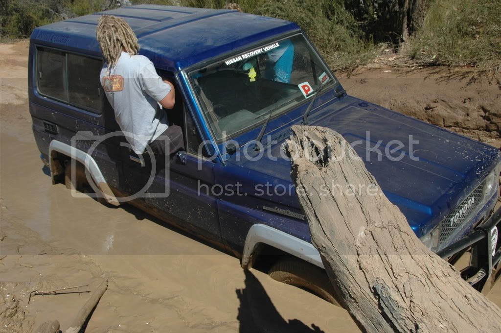

One of the blue ones is my mates. He said it was painted professionally by the previous owner and even using professional techniques and the best primers the aussie sun still made the top flake off. It does look good though
