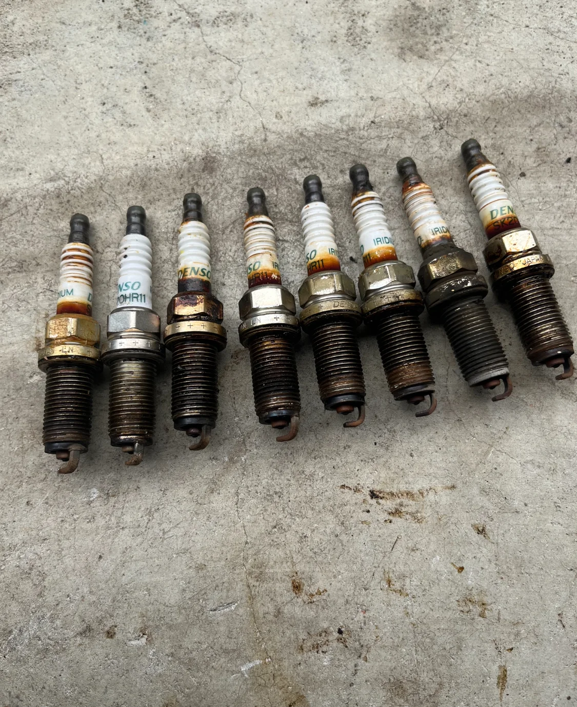

These had ~262k on them. Take a close look at the tips of the electrodes, almost totally worn away. All ran fine too until the # 1 ignition coil went out and I finally pulled the plugs…. Also you can tell from these that none of the threads protrude into the combustion chamber.
View attachment 3735377These had ~262k on them. Take a close look at the tips of the electrodes, almost totally worn away. All ran fine too until the # 1 ignition coil went out and I finally pulled the plugs…. Also you can tell from these that none of the threads protrude into the combustion chamber.
Yeah, those look fully depreciated.
but toyota said those were lifetime plugs 😆
So how many other Heavy SUVs with V8s do you think would survive 270k miles without changing the plugs??
