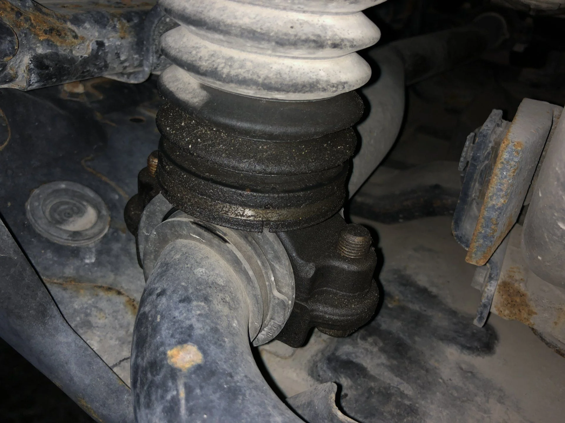

I picked up a 2012 GX Premium with 108k miles a few months ago.
I bought this particular example because of it’s impeccable maintenance history (all common problems had been addressed, such as the secondary air pump and valves, timing cover leak, valve cover gasket leaks, leaky water pump and other less common stuff), and good cosmetic condition + no accidents.

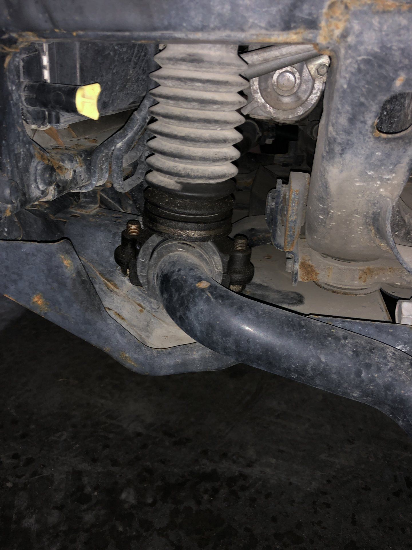

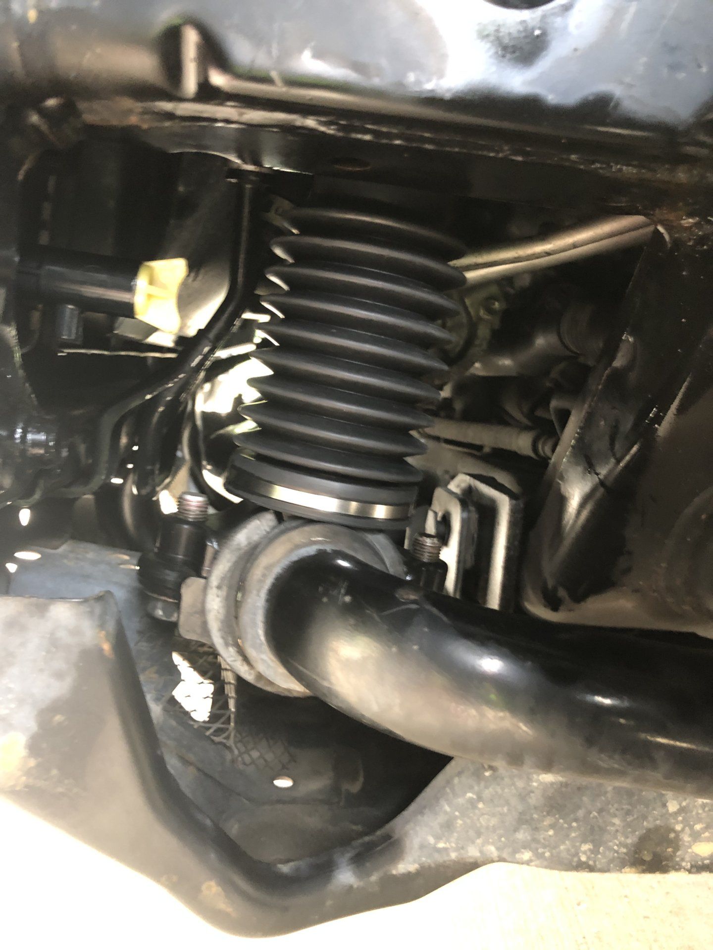

I was replacing the front rotors/pads with EBC goodies as part of my baselining and noticed the front KDSS cylinder leaking.
The car is under a 3 month/3k mile warranty, and I’m taking it to the dealer of purchase to look at the leak. My questions are:
  • How serious is the leak? My understanding is this is a sealed system like AHC, so leaky no goody.
  • Any pointers to help the shop understand the importance of the system operating optimally that the current leak may jeopardize?

If the system is not fixed you will hear clunks going over little bumps. I accidentally cut my KDSS hose a couple of months ago. I had to replace the hose then get the system refilled. I have a front piston and a few quarts of liquid I can let go for cheap if you end up having to get it replaced.

I have to imagine that, the more it leaks, the less the KDSS components are able to work effectively as a system — for example, the system will become less effective at keeping the car flat in turns, changing lanes on the highway and, most importantly, keeping the car stable in the case of an emergency maneuver.
I imagine the same performance degradation would occur off-road; however, for the purposes of a repair occurring under a questionable warranty, I’ll be citing more common safety concerns, assuming the above is true (?).
Just closing the loop. Fortunately, the aftermarket warranty company paid for the repair which was completed at my local Lexus dealership. Lexus quoted me $3,000 if I were to pay out of pocket.
Unfortunately, I now have about a 1.5” KDSS lean... It’s back at the dealership for the secondary air pump recall and I’ve asked them to address the lean. Not surprisingly, the SA sent me off with a befuddled look. I’m looking forward to what they come up with.
that's interesting that you have leaning issue now. When they recharged my KDSS system, i no longer have the leaning issue. I had it before.
They got it back to within just under a half-inch difference from left to right, which is within factory specs. We’ll see how it does on the auto cross course this weekend.
