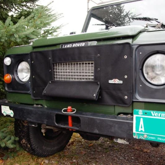

OK, throwing it out there for any Mudders who're interested, price for the same thing you see on my rig is $50 plus shipping. Cost for shipping should not be too high as its vinyl that can be rolled up tightly and placed in a padded envelope.

The piece attaches on top via 4 zip ties running through eyelets on the piece. Its held up fine so far on mine.
