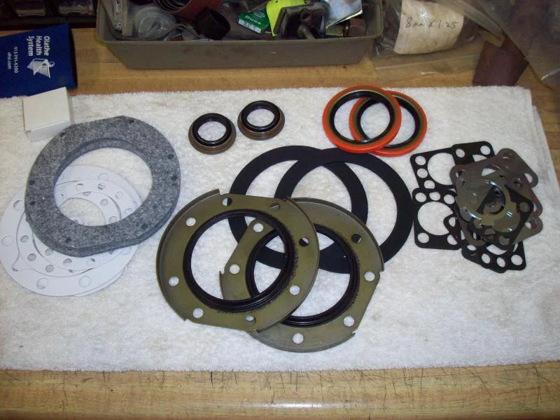

Finally getting around to rebuilding the front end. Before I break into it, are there any SST's I will need? And if so, any one have loaners I could borrow?
Haven't done this before, so any tips also appreciated.

I have 4 small bearings in the white boxes on the fender. Should there be more? I bought the kit from cruiser corps.

I have the sst. It's not Eric's it actually belongs to chef but resides here. There are a lot of things to do when the front is being rebuilt. I can provide a crash course.not avail till next week. I have manuals and tools I can loan I would start by taking apart and cleaning everything first keep shims where they are. I'd cut backing plate down and use it for a spacer and run flex line to caliper from axle. Bring your birfs with if you want help separating them from the inner shaft. Cleaning is the time consuming part. Backing plate deletes are avail at many vendors. I have pn for hose here. U using marlin seals? What brand of bearing it does make a difference even tho web wheelers will tell u differently. I've probably built at least a dozen front ends over the years

Four bearings are correct. Wheel bearings only die when abused I keep a set here just in case. Hub gaskets will be needed depending on what hubs it has on it and inner c clip when splitting birf. Like I said I can provide a crash course. Get it all clean and painted. Rotors are a good thing at this point as well if needed and upgrade to bigger calipers dependent on year of axle. Older roters were pressed on with wheel studs others bolted. Big knuckle or small might want to insure they sent u right shims as well
